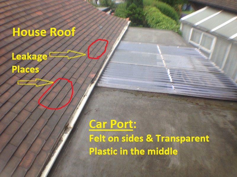

Dear forum members,
Our flat roof above car port attached to bungalow developed a leak - 1l/hour in heavy rain.
The part of the car port ceiling where it drips - is below clay tiled roof of the house, so water must somehow penetrate beneath the tiles.
What I plan to do is to fill all the gaps/joints between the tiles I can reach standing on the car port roof with a proper sealant and I'm considering three options available at home:
- mortar
- Black Jack All Weather Roof Coating (liquid bitumen with fibres)
- lead flashing tape.
DO you think this will work and what would be the best option? If none of the three - please suggest an alternative?
Looking forward to your help
Thanks a lot
P.S. Photo of the house and car port roofs attached with approximate location of leakage spots encircled in red. All tiles appear intact and the gaps between tiles are small ( 7-8 mm at worst, most are smaller)

Is the water penetrating from the tiles, or is it leaking from the felt roof covering that you say is under the clay roof at these points?
Blup
the pitch is very low. the tiles are only a rain screen, not water tight. The underfelt/membrane is the waterproof layer.
it's common that the felt is ponding near the bottom, you can strip a few rows and put some eaves trays to bring th felt back up to a slope. Don't bother trying to seal the tiles, it's impossible as they'll just move in the heat etc and break the seal.
i dont think the tiles are the problem. there is a sprocket at the bottom of the roof giving a shallower pitch. In this case the roofer has compensated by closing the tile gauge... looks around 3.5 -3.75 inches
but, the first course of tiles dont appear to over hang the gutter as they should . i'm inclined to think its water droplets tracking back and missing the gutter at the rear.
pumping mastic isn't the answer here, underlay support trays might just help..... of course assuming there are no problems higher up the tiled roof slope

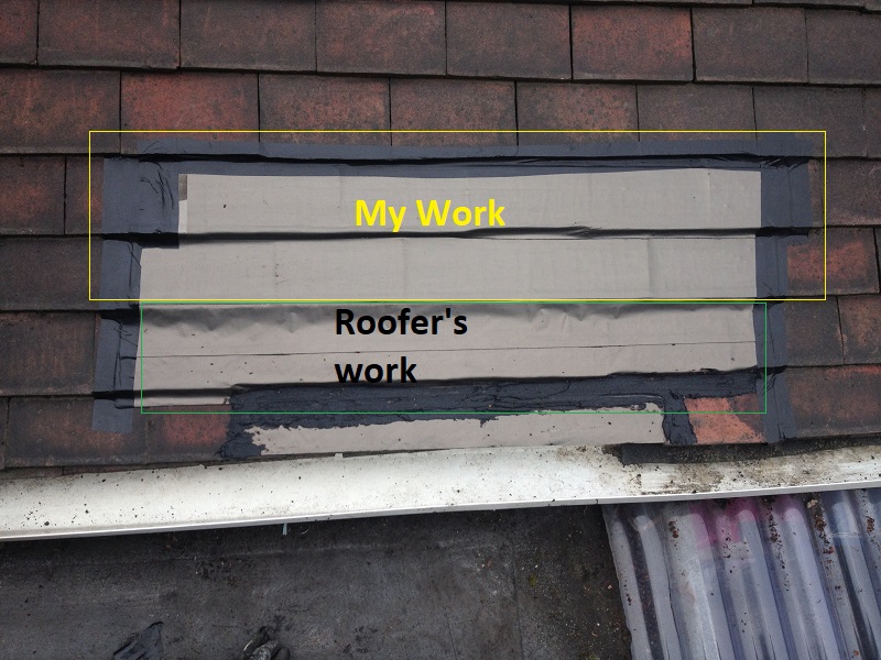

Actually the leak has been "fixed" a couple of days ago by a gumtree roofer, but I think he didn't do it well. What he did was:
- Stripped a few bottom rows and put a piece of felt underneath and then replaced the tiles;
- He then sealed the bottom row with some rubber sealant (super powerful stuff as he said) and
- Put two strips of lead splashing tape on the 2nd row (from the bottom)
However, after haven given it a test - pouring half a bucket of water on tiles - the ceiling in the car port was still leaking (less but leaking).
He then put some of the rubber sealant and stuck some lead splashing tape ON THE CEILING (from inside the garage) which I thought was a bad idea. After he has gone, I added 2 more rows of lead splashing tape and also stuck a "Gorilla" tape (black) around the whole patch (see photo attached). But I still feel it's gonna leak - rain next week will show.
To cut the long story short - I will likely need a proper repair like you suggested (with eaves trays). I am based in Nottingham - can you recommend any good roofer?
I am not sure where you see a sprocket? The white at the bottom of the tiles is gutters.
I think the bottom tile row does overhang the gutter maybe by ~2 cm or so. I will double check tomorrow but my recollection it does.
PLus the thing to bear in mind - this is the ORIGINAL tile roof (1928 built) and no visible change has happened to that roof since we moved in 4 years ago, yet the leak has recently developed. I think the leak source is more subtle than what you assumed. I might be wrong of course, but neither I nor the roofer were able to spot any obvious "tile shifts" or the like.
Firstly, The sprocket I refer to is the change of roof pitch. (angle) at the lower end. Yes I can see the gutter is white. but 2cm over the gutter isn't enough.
probably the original gutter was cast iron I would guess. That being the case it usually sits tight to the fascia with no bracket holding it off the fascia, (depending on original profile)
I didn't assume a major leak at all. I can see its the original clay tile, the section in the picture looks fairly tidy and i doubt the tiling is the cause of the leak .Its been a long wet winter .
The gunk over the tiles sorting the issue is doubtful.
good luck
There was moderate rain this night for couple of hours - no sign of leakage. So what I'm thinking is that tiling itself isn't a problem, but in heavy rain when gutters get over flown excessive water rushes above the tiles and penetrates beneath them which creates leak. Does this make sense?
Looks like we need a roofer to fit in eaves trays and maybe and bigger piece of felt extending over a few rows. If any other suggestions please let me know.
