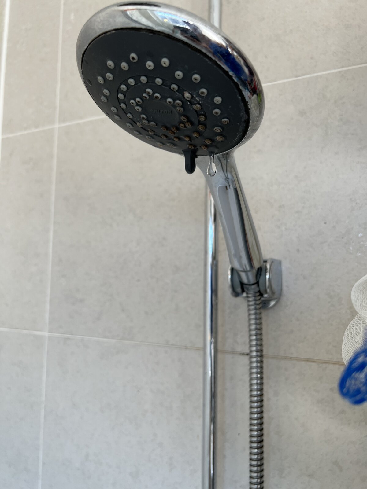

Hi when I moved in
There was only a rain shower top bit-
I bought this divertor from eBay to enable me to have a normal small head shower (see yellow)
Lately however no matter how tight I turn shower off - i get a leak from the small head shower - it drips
Is it the eBay valve that’s the problem?
Or the original valve (on - off / hot - cold) that’s the problem?
or do I just need to buy a new shower head does anybody know pls?
Before it used to leak from the loop bottom bend of the hose itself but that’s not happening anymore.

These shower heads can hold a lot of water and drip for a long while afterwards. If you take the diverter valve off the top of the shower control with the shower off is the shower control still passing water?
If you still use the rain shower head, then if the diverter is switched to the handset all the water above that's held in the rainshower head and riser will drip out of the hand held until the water in the riser pipe gets to the same height. If the valve isn't passing then it will eventually stop once it gets level.

Hi we do not use the rain shower at all.
Just the normal head shower. But even when it’s twisted super tight to turn off - it still drops …. Sometimes hose sometimes small shower head ..
Disconnect valve 1 and see if valve 2 is still letting water by even in the off position.
You could also remove valve 1, then screw your small shower head hose directly into valve 2 and see if that makes a difference. Process of elimination to find the cause.
If it drips constantly ,never stops ,Al day ,all night , your original shower valve is at fault.

The centre valve assembly needs removed and either stripped and serviced or replaced. It really needs someone that knows what they are looking at.
That then really needs a pro who knows what to look for and gauge whether it can actually be serviced or it needs replaced. Sometime a new valve can be nearly as much as a new shower unit.
