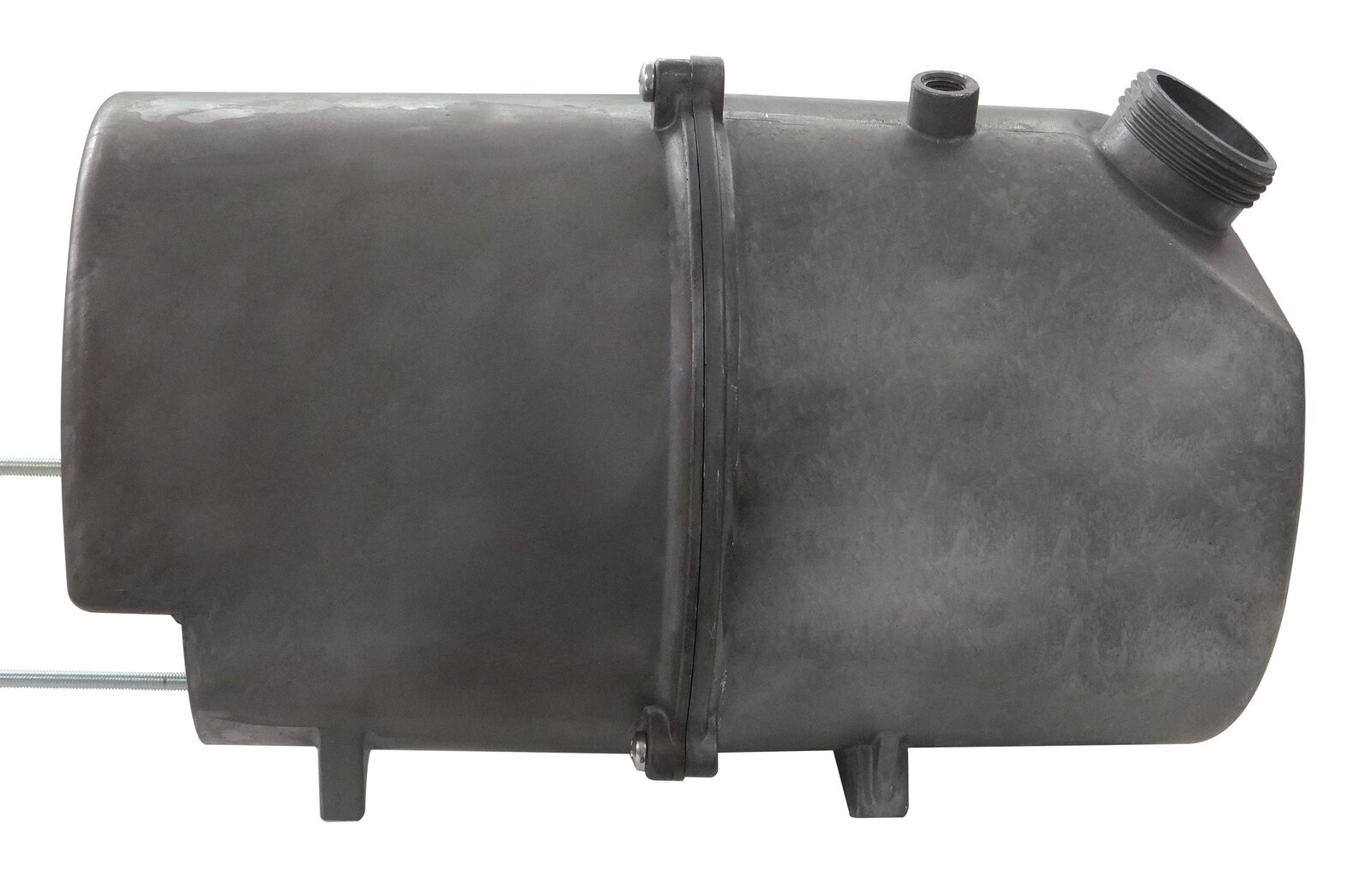

I purchased my steam stripper about 18 years ago (Earlex Steam Master). I seldom use it these days. I loaned it to a friend a while ago and he mentioned that it has a slight leak. If I identify the location of the leak on the tank, will something like Millput putty work? It says it is good up to 130 degrees C. Presumably, as a steam stripper, there will be no pressure to worry about.

No, I would expect it to just peel away, with the expansion of the tank. Try to work out what plastic type is used, and find an adhesive to match. Better, if you can apply it to to the inner surface.

It is a metal tank with a seam half way along its length. I am guessing that the gasket has failed somewhere.

Have you found the source of the leak? Could you solder a patch over the leak?

Here is the boiler
Assuming that it is only a few mm long, what would you recommend for the patch?
It looks like there are 3 or 4 screws holding the two sides together. Would soldering be easier than trying to make a new gasket?
I do recall buying liquid gasket years ago. Can't remember why, and never used it. I have never tried making a gasket.
Looking at the images in the link, I guess it could be leaking from the rear, where the heating element goes in.
A basic gasket, is quite easy. You just find some suitable material, I often use cornflake packet. The method of cutting, depends on the the material your gasket has to work with. Some, you can draw round with a pencil, then cut with scissors, others you may need to grease the metal surface, then use that to mark the profile on the gasket material. Others you can simply and gently tap out, using a small hammer, working around the sharp edge of the metal, to partially cut the gasket. Boltholes can be pierced, with a sharped bit of tube, or sometimes burned with through, with a hot soldering iron.
If the tank itself has developed a pinhole, or split, and it is steel, brass, or copper, you can solder it, or even solder a patch on. For a patch, you can cut out a piece of tin can, but it must be from a steel can, not alloy.
