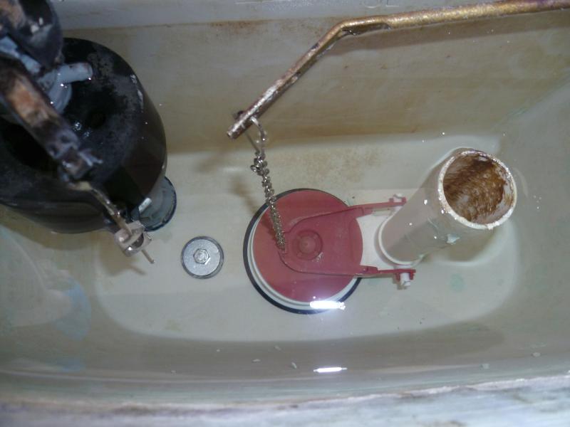

Ok. I'm really on fire now, here's whats inside - would I need to replace that whole unit or just the seal/washer at the bottom?
& this is a balofix yuss?
Just buy a closed couple cistern kit this comes with doughnut, new plate and retaining screws with washers ect. When replacing it dry everything off and seal bottom of syphon to cistern and cistern to coupling plate. It's all very straight forward.
That`s a balofix. And you don`t need to replace anything Inside the cistern - only what barkie 1 said :wink:

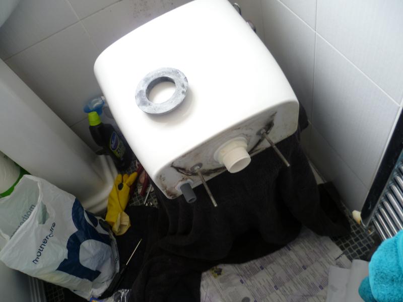

OK, update.
Got one of those sets from B&Q, took the toilet apart.
http://www.diy.com/diy/jsp/bq/nav.j...Type=cistern_fittings&fh_eds=ß&isSearch=false

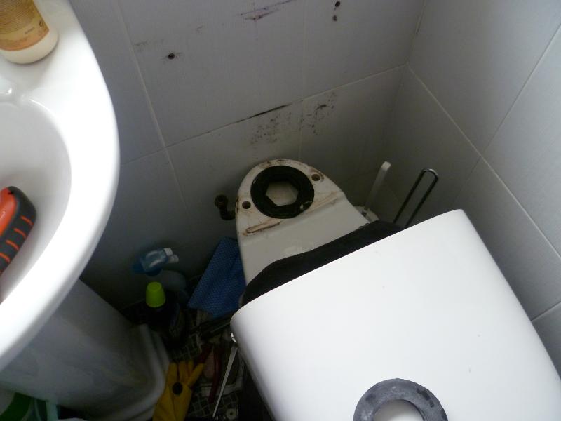

First thing, doens't look like I was expecting it to;
(that's the new one there)
There's no "bracket" thing to hold the donut?
Changed it anyway, tightened stuff up and put it back together. Still leaking :( Have I got the wrong kind of donut? Should the bracket be put on? I didn't because I wasn't sure if it would fit with it, I assumed there was a reason for not having one?
Well,
took it back off again. Removed the fixings, washers and rubber washer things and gave them a good clean and put them back on with a bit of sealant to help. Put the old donut back on since I've come to the conclusion I need a 120mm hex one (like thishttp://www.plumbers-mate-sales.co.u...oughnut-washer-pack-of-2---08000111-645-p.asp) and put it all back together.
No leaks yet, although it may just be temp. Going to get a hex donut as above soon hopefully.
