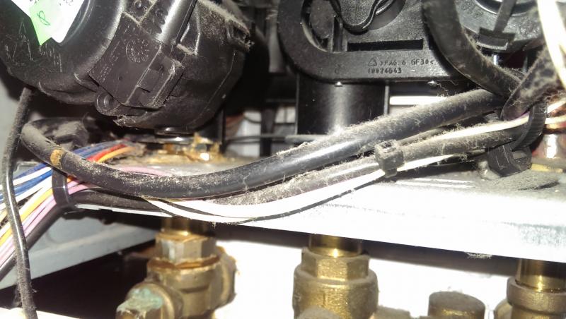

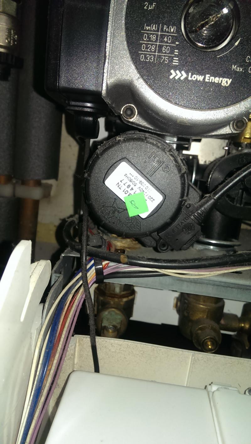

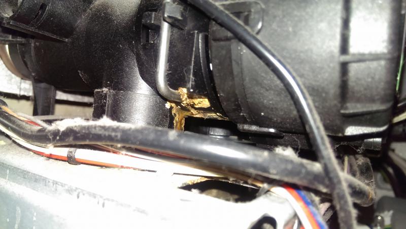

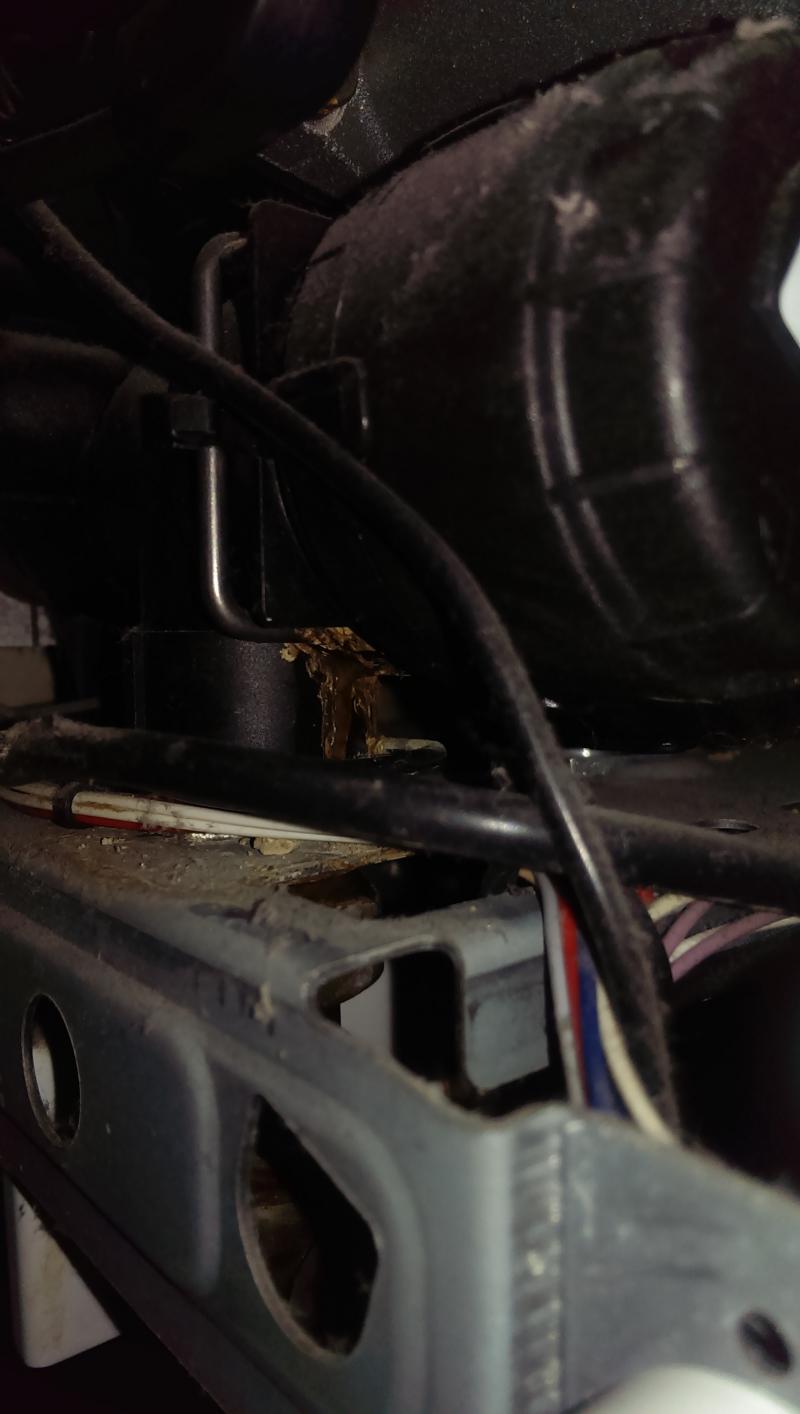

Hi everyone I just wanted some help with my vokera unica 28he. I've noticed the last couple of days its been dripping water on the worktop. I've taken some pictures and hoping you could identify the part that's leaking and if it needs replacing or is it just a seal or something gone where the pipe comes out? It leaking from where the pipe comes out of the black plastic part which is directly under the pump.
ok thanks. So is this quite common for them to just start leaking tho? I was just wondering does the diverter definitely need changing or is it possible its just a seal or something needs tightening do you think?
You will need to replace the cartridge. The part number for the one you have is 10025305. I would do it ASAP. If water seeps into the motor it will short the boiler and you might also need to replace the motor.
Cartridge alone 20043954
Actuator 20024841
I think you'll only need the cartridge if the motor is OK, around £35 I think.
It's the O rings on the spindle; don't mess about, change the whole thing.
The retaining pin that holds the motor on (second picture)is also the key to unlock the cartridge. It fits into two slots on the cartridge head once the motor is removed. Turn the cartridge anti-clockwise with the pin till it stops and then pull it out.
