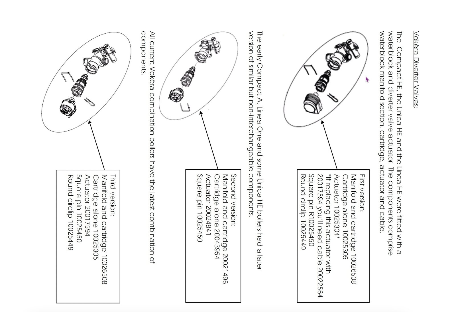

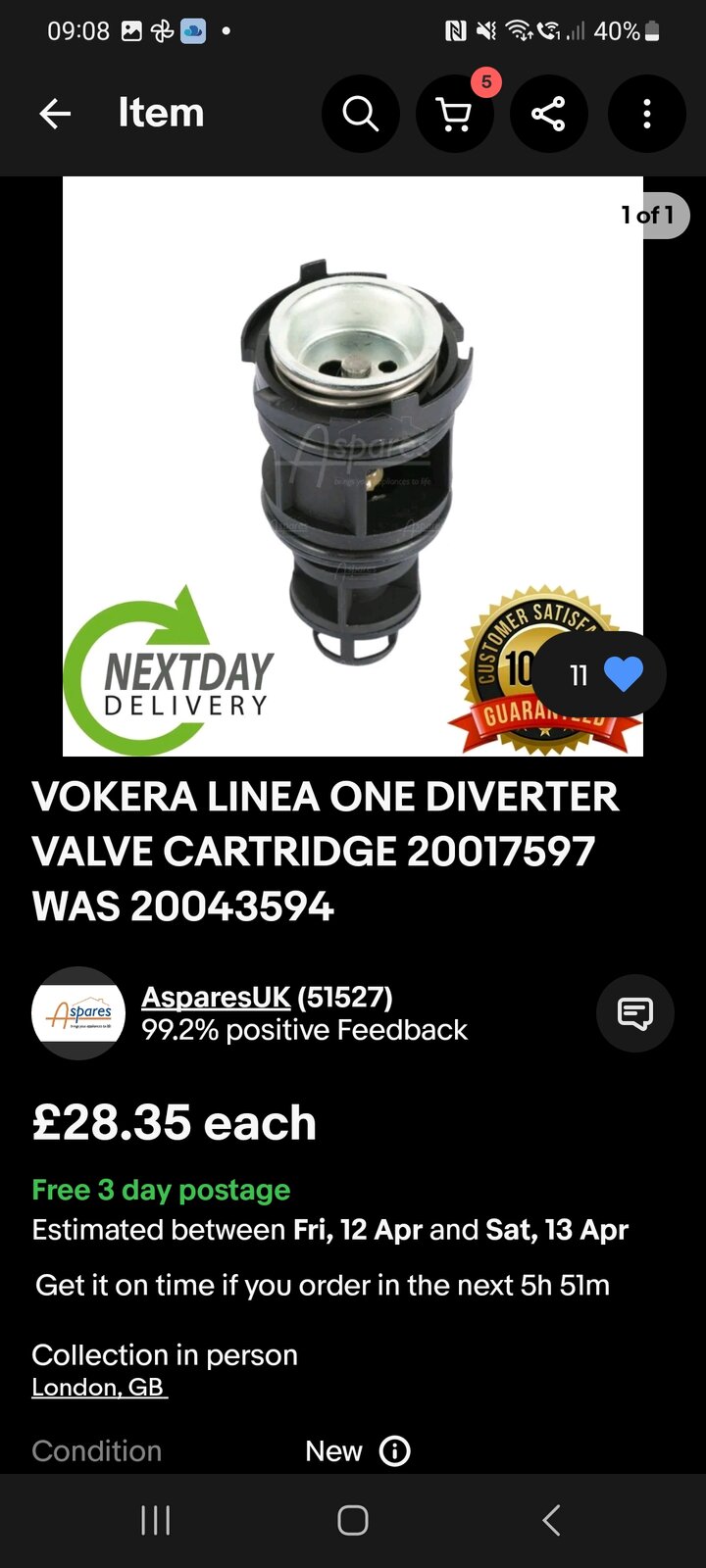

Hi everyone I need to replace the diverter cartridge on my vokera unica 28he but I'm a bit confused by the part number. In the manual the part number is 10025305 but it seems like it might have now changed to 20017597?
I ordered one of these which was listed as fitting my boiler however it's turned up and seems to be the wrong part.
When I look again now online there seems like there's two quite different looking ones with the same part number. Does anyone know if that's the case?
I presume I just get the one that looks like mine, but it just seems a bit strange to have different items with the same part number?

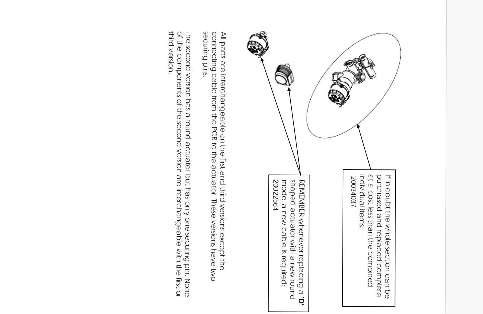

Yes, there were changes in the design.
You could also ring sales 01727 744000 with the serial number

Ok great thanks for that.
So I think mine is the second version then by the looks of it. It only seems to have the square securing pin and the actuator is round.
I still can't seem to find one online with that part number that looks like it tho
