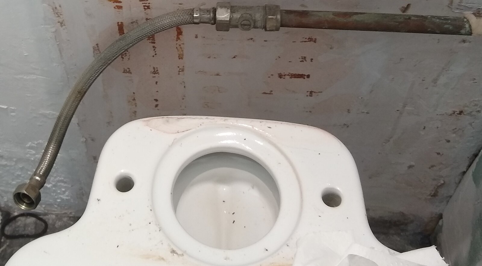

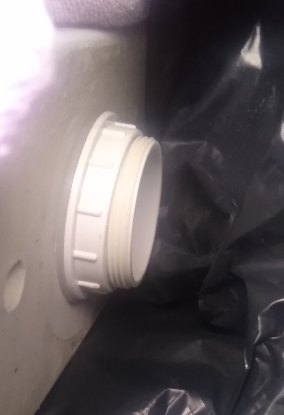

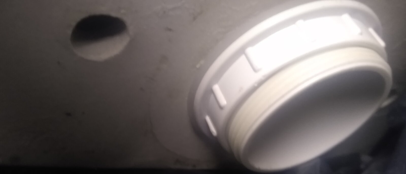

Closed couple toilet was leaking at the cistern so i assumed that the doughnut or metal plate needed replacing (although it is barely a year old)
However after removing the toilet, I was surprised to find that there was no metal plate
Just the doughnut and white plastic nut
Is this normal? Or do some toilets not come with these plates?
In order to prevent leaks, what would be a belt and braces repair?

Theres not two long bolts through the bottom if the cistern that fit through holes in the pan with wingnuts underneath which compress the doughnut when tightened? if it does there no need for the plate your refering to
How is the cistern currently tightened down onto the toilet? As suggested if there isn't a plate then there needs to be 2 bolts that sit inside the cistern with seals, they extend out through the bottom of the cistern, into those 2 holes in the pan and then tighten underneath.
You guys are right. There are two long bolts that sit inside of the cistern and they fix to the pan
