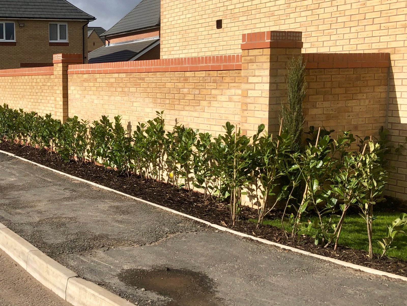

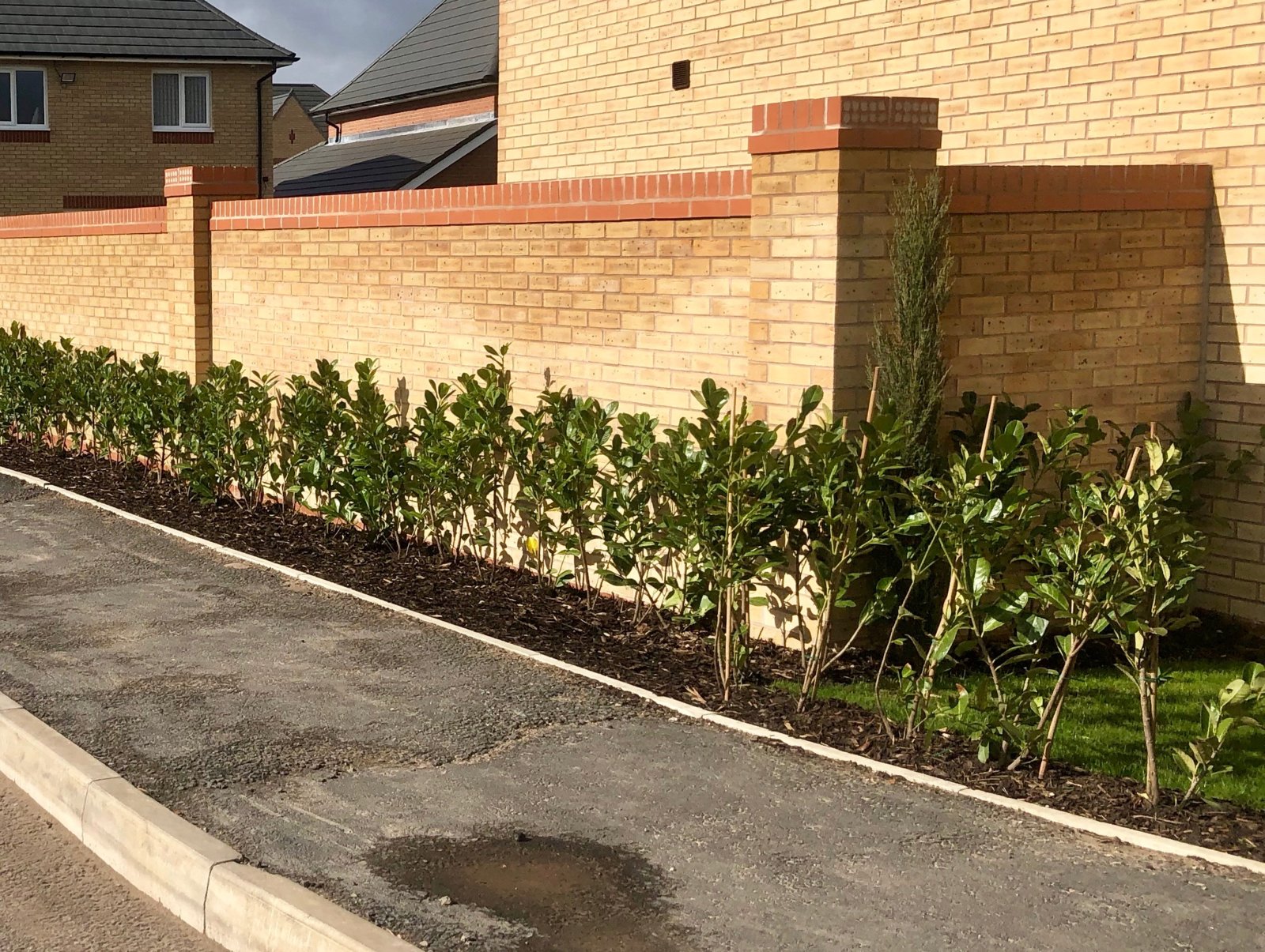

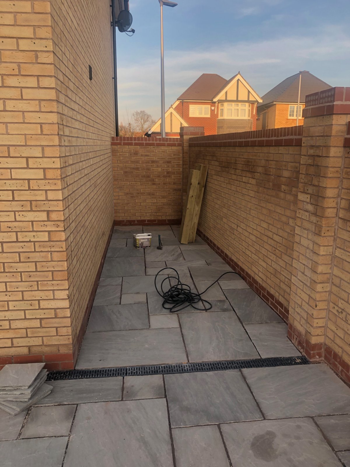

Hi all, am looking at building a lean to on the side of my house using the existing perimeter wall. The area will be used as a shed/storage area and will have a wood/felt roof. From my perimeter wall there is a 1m gap to the pavement were am currently growing laurels.
Will I need planning permission?

That would not be permitted development because it would front a highway and extend beyond a wall forming a side elevation of the house.
It wouldn't extend beyond my wall, it would be up to were the wall is n my property
