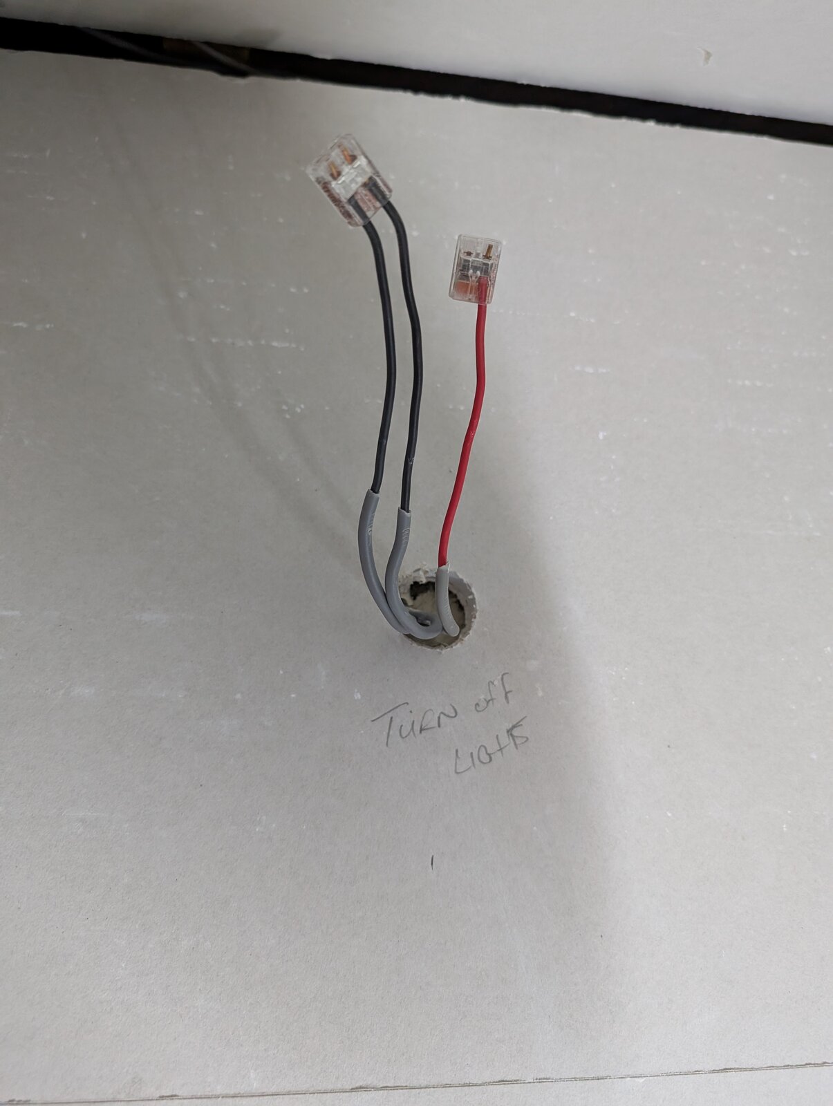

Leaving wago connectors inside light fitting?
I don't have an earth wire going to the light unfortunately.
Here's a pic
I'd go as far as saying the fitting doesn't look like class 2 anyway. It looks to me as if they have added that woven sleeving to make it so but leaving the brown and blue uncovered if it is not reinforced does not comply.
Unsheathed T&E conductors within a metal fitting negates its class2 status.

Another photo as requested, nothing too exciting. (Marvel at my drylining)

You'll get them in wont you? It'll be tight but you'll do it.
Keep the black shroud on and make sure you cant see and red or black, and make sure the white box is closed, put a cable tie round it if need be.
Edit...the light fitting is rubbish you can see brown and blue anyway, throw it in the bin.
