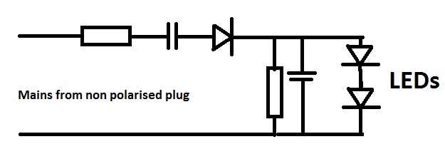

This was found in a LED lamp bought in Spain. Changing mains frequency altered the brighteness as the series capacitor was the current control.
Resistors did not have markings indicating their value.

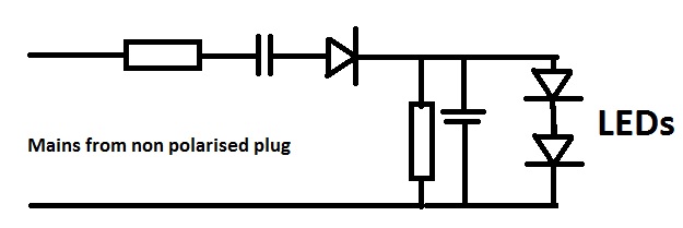

Note, I mentioned a 12V lamp - they operate on both DC and AC so a series capacitor current limiter is not a possible topology.

The same circuit with different values will work on 12 volts AC, ( maybe I should have removed the reference to mains )
True, but 12V lamps are designed to work on both AC and DC so that they can be used with constant voltage drivers.
