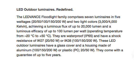

My first thought was a sarcastic one
but then I thought, maybe there's an indication on the manufacturer's web site. Did you not think of looking there???
(hint, read the last sentence)
EDIT, and ooh look, the website has a whole page about guarantees
https://www.ledvance.com/services-and-tools/services/guarantees/led-lamps-guarantee/index.jsp
:rolleyes:
I just looked on the box and it said 2 year warranty. Mebbe the website is being a bit generous?

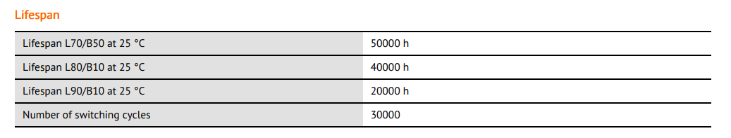

The product data sheet for LED 150 W 6500 K BK LEDVANCE FLOODLIGHT says 20000 to 50000 hours (the 4000 K version is less).
https://www.ledvance.com/en/product-datasheet/8954/129543
Maybe someone else can say what the L70/B50, L80/B10 and L90/B10 refer to...
It has been tested at 25 °C, so hotter or colder will reduce the time the light lasts and the number of switching cycles it does will have an impact.
Note that the figures are predicted lifetime. And probably mean/average figures.
If you took two lamps and turned them on. Suppose one fails almost immediately, and the other lasts for 100,000 hours. That would give an average lifetime of 50,000 hours.

Ive had Led floods in which the data sheet says connecting to a pir in busy places reduces led life so the amount of on off cycles must affect led life
It might. The table above given by @RepairingDave gives the number of switching cycles for those predicted hours…. Didn’t you see that?
Lots of other influences too including high summer/low winter temperatures.
