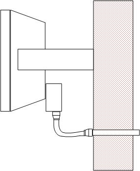

I have 4 flood lights, (non PIR) decent items at the time – die cast aluminium glass front.
These particular units had a plastic wiring box at the back, and a standard female 20mm conduit thread.
They were wired up using Electroflex flexible conduit … with Electroflex glands on either end – one direct into wing box, the other to the end of PVC conduit that come through the wall, routing the power.
Time to change these floods to LED, and ideally stainless steel housing. 50-100W would be the power to give equivalent light.
Issue I’m seeing is that LED floodlights seem to come pre-wired with a cable tail ….
Anybody know of floodlight with a wiring box ?
Or failing that a neat box or similar to be able to connect existing Electroflex conduit to. And then run tail to that … not as neat, and will end up with some of tail exposed to elements.
