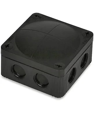

Q1 fit a 20mm thro box or angle box and adaptor
Q2 anything with a 3/5 warranty eg V-TAC
Not sure what you mean by a ‘20 mm tho box’. Do you have a link for one ?
sort of assuming you might mean one of these …. Ideal need 20mm female threaded ….. otherwise I guess I’d need to solvent weld on sone cable glands.
Most would mount a squarish box adjacent, I prefer plain sided boxes and drill own holes, though most use 3 x 3 threaded wiska 306 boxes but I think there ugly with all the unused outlets.
There's also a smaller 206 box
Often you can visibly loose them behind the fitting.
Both boxes have 20mm thread built in and usually come with 3 wagos inside for your cable.
Gland your conduit or flexi into one side and use a flex gland for the flex from the fitting
