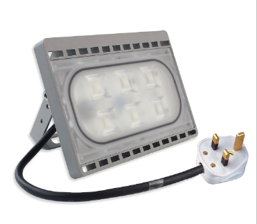

Plastic led floodlight 20w has only live and neutral but no earth
No, it is Class 2 and, as such, is better without an earth.
Why is it better without an Earth ? The only reason that it could be "better" is that it avoids the risk of electric shock from an exported Earth that is not a Ground potential.
That's why they made it Class 2.

Anyway, the OP's lamp would appear to have no exposed-conductive-parts to earth. You're not thinking the bracket, are you?
