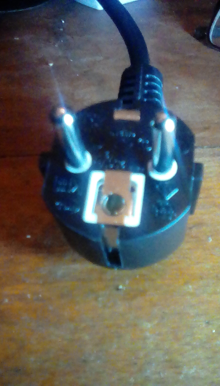

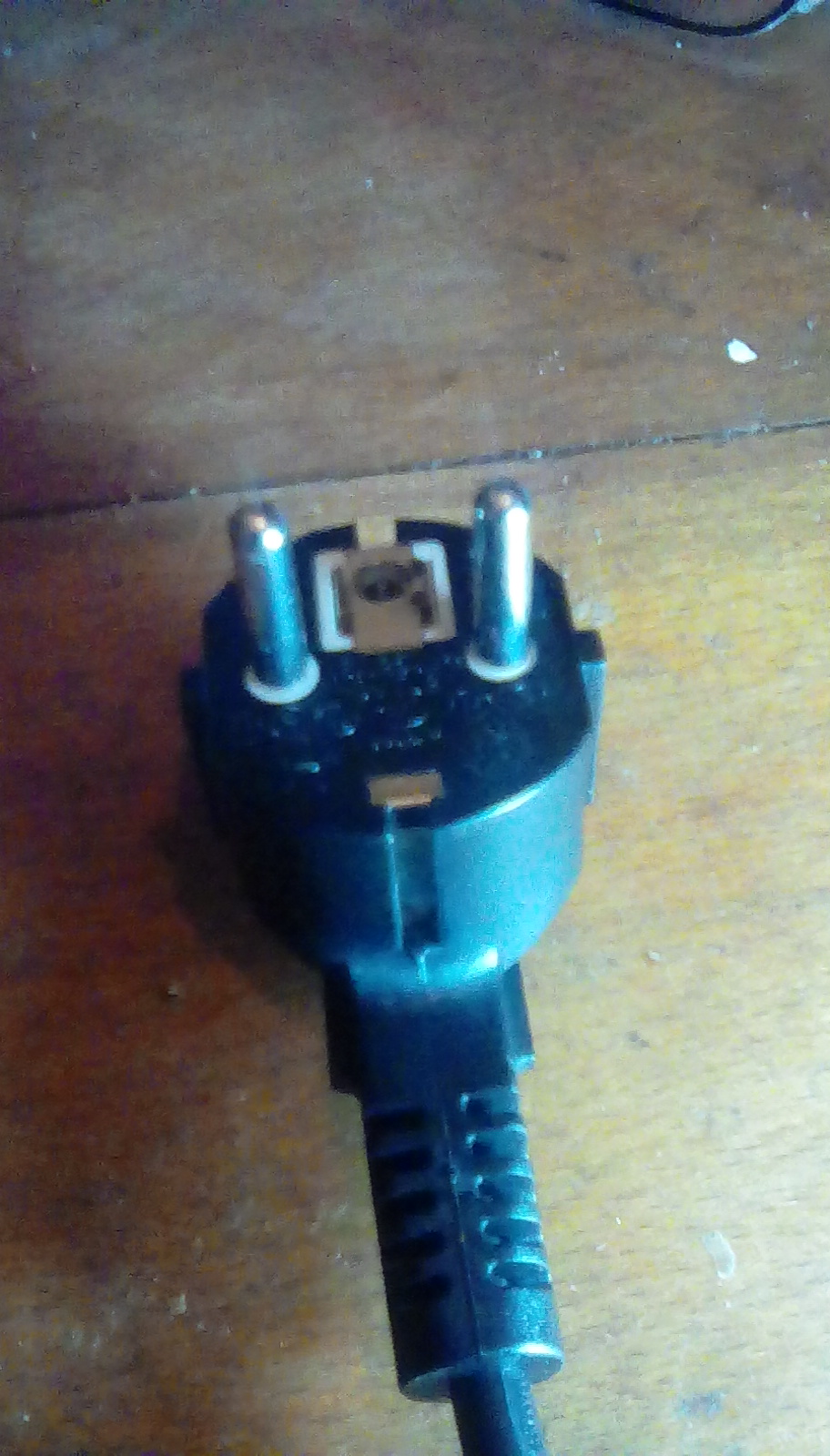

Also I just bough a pair of speakers from Europe, they have a 3 pin plug on the back of them the same kind of plug to a computer. With these speakers was supplied a 1 meter long 2 pin Euro plug cable and a 1 meter 3 pin UK plug cable, again dose it matter if the 3 pin plug is wired through a 2 wire (live+ return) cable?
Not if your speakers do not require an earth.
Some pictures might help
The Euro cable is probably a Schuko plug which has side contacts for the earth.
https://en.wikipedia.org/wiki/Schuko
It does matter if the earth is not connected. It is there for safety.

I have attached 2 images of the euro plug and a link to the speakers
It is a dual purpose Schuko / French plug. The earth is side contacts or a pin in the socket which goes into the female connect at at the bottom of your second picture. A already stated the earth is there for safety and should be connected.

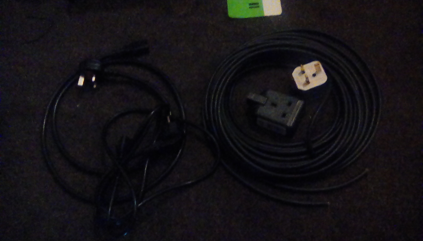

So I will wire them up to an extension lead of 6 meter with 3 pin UK plug and 3 wire cable, if you don't see a problem with that?
So is the whole purpose of an earth wire there to take any electrical leakage away from the load and away to safety, the fuses box?
I uploaded a photo of the UK pin and euro pin 1 meter cables I have and what I plan on wiring the UK one to.
The euro wire is much thiner the the UK one, dose the euro wire have 3 wires to it or 2?
