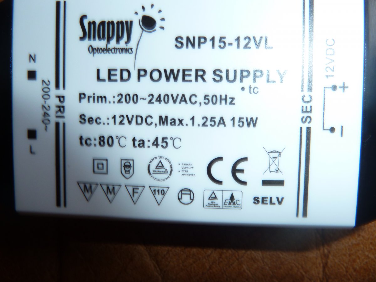

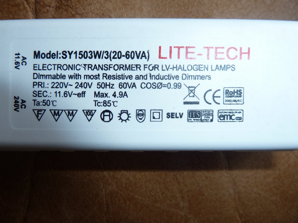

Existing faulty halogen light replaced by supplier. However replacement is an led light, question, will it be ok to use existing halogen driver or should I buy a replacement led driver.

Excuse my ignorance, the supplier used the term driver, when I said transformer, I thought they were both one and the same.
I should have mentioned that the lights are on the underside of kitchen units and that each one has its own transformer/ driver to avoid unsightly wires being visible.
I have enclosed pics of the transformers/ drivers

The one on the left is a halogen lamp driver or power supply. It is NOT a transformer despite what it says on the cover. The one on the right is an LED driver or power supply as it says.
A transformer changes voltage or current by electromagnetic induction (one exception is a 1:1 isolating transformer which does not change voltage or current). A transformer supplies AC, LEDs require DC generally, though some have rectifiers built in so can work on AC.

An electronic transformer is NOT a transformer, but replaces a transformer and does the same job, it often has a transformer inside and has the advantage of including some form of regulation so where used with quartz lamps it ensures the lamp is at the correct temperature. However they also have three major draw backs, one is they have with some odd exceptions a minimum output, and also work on high frequency which limits cable length, and the regulation may not be smooth enough to stop spikes damaging LED's.
A driver is DC and regulates the current rather than voltage, most LED's have drivers of some type built into the lamp package, this allows them to work on a set voltage, but some do required external drivers 320 mA seems to be a typical output, the voltage output will often vary typical 6 ~ 50 volt the LED's supplied from a driver are wired in series.
A power supply covers all of the above and there is also a voltage regulated DC power supply, where the supply is smoothed to a point OK for LED's but not really good enough for other uses, it is often called a driver, as with the electronic transformer this is a misleading name, as it is really not a driver, as said drivers are current regulated not voltage, however the lighting industry has historically swapped names around. They also call the electronic unit to power fluorescent lights a ballast where it is not really a ballast but a replacement for one.
So one has to ignore the name, and read the specifications instead, you need a fixed voltage of 12 volt, and no or very low minimum current a maximum current greater than the sum of all the lamps being powered from it. Watts is volts times amps times power factor correction, there is no power factor with DC, some power supplies give the rating as VA which is nearly the same as watts, but does not include the power factor correction. In the main one can consider VA and Watts being the same.
In theory if you have 4 x 7W LED's in parallel you should be able to use the 20 ~ 60 VA power supply, in practice it often produces spikes which could damage some LED's and also many when you read the full specifications state the extra low voltage output lead must be no longer than 1 meter which means in real terms you can't use it.
