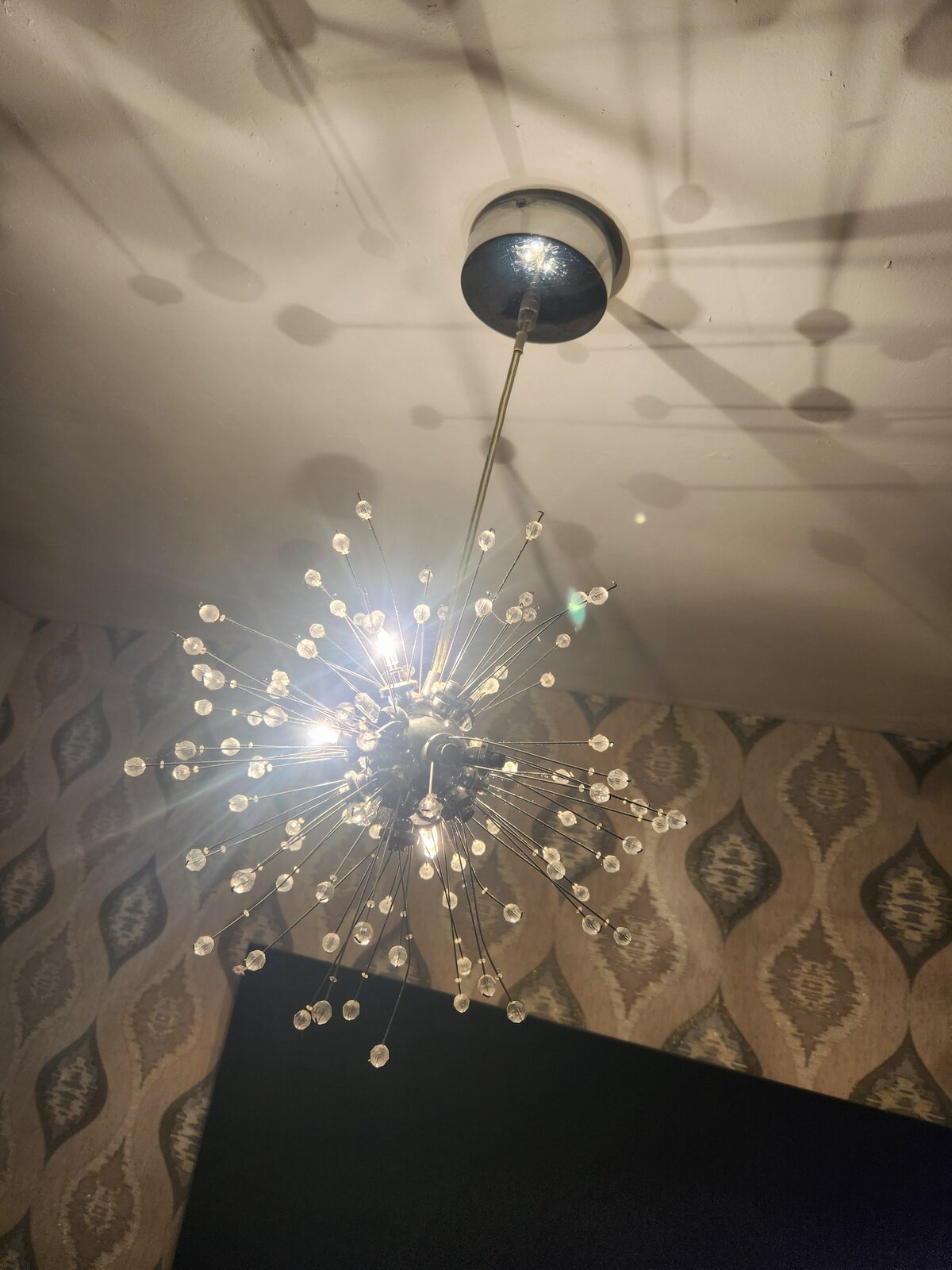

Good morning
I have a light fitting with g4 bulb
Would it be possible to insert g4 led instead of halogen bulb?
Would W is suitable 3w, 5w, 7w?
Some manufacturers says reqs transformers, would my current light have a transformers with halogen?
Can you directly replace halogen bulbs with LED?

You may need to keep one of them a bulb for it to work. It’s what I do.
Looks a bit odd though
Would i be able to replace the transformer?
If I left the current transformer would it be dangerous to use? Or would it just flicker

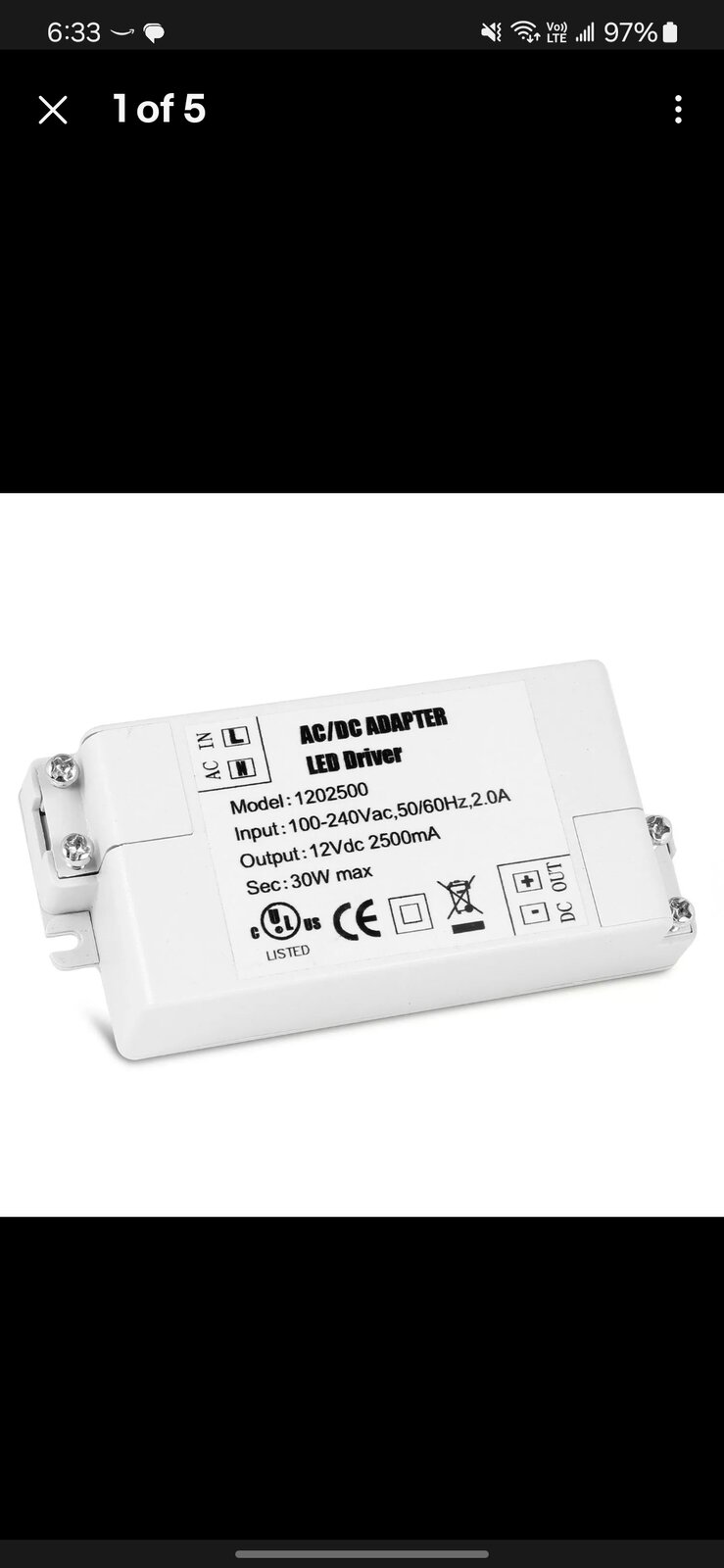

Would the transformer pic work?
The device which you pictured is a 12 V, 2500 mA Power Supply.
Hence, it can supply up to 30 W total.

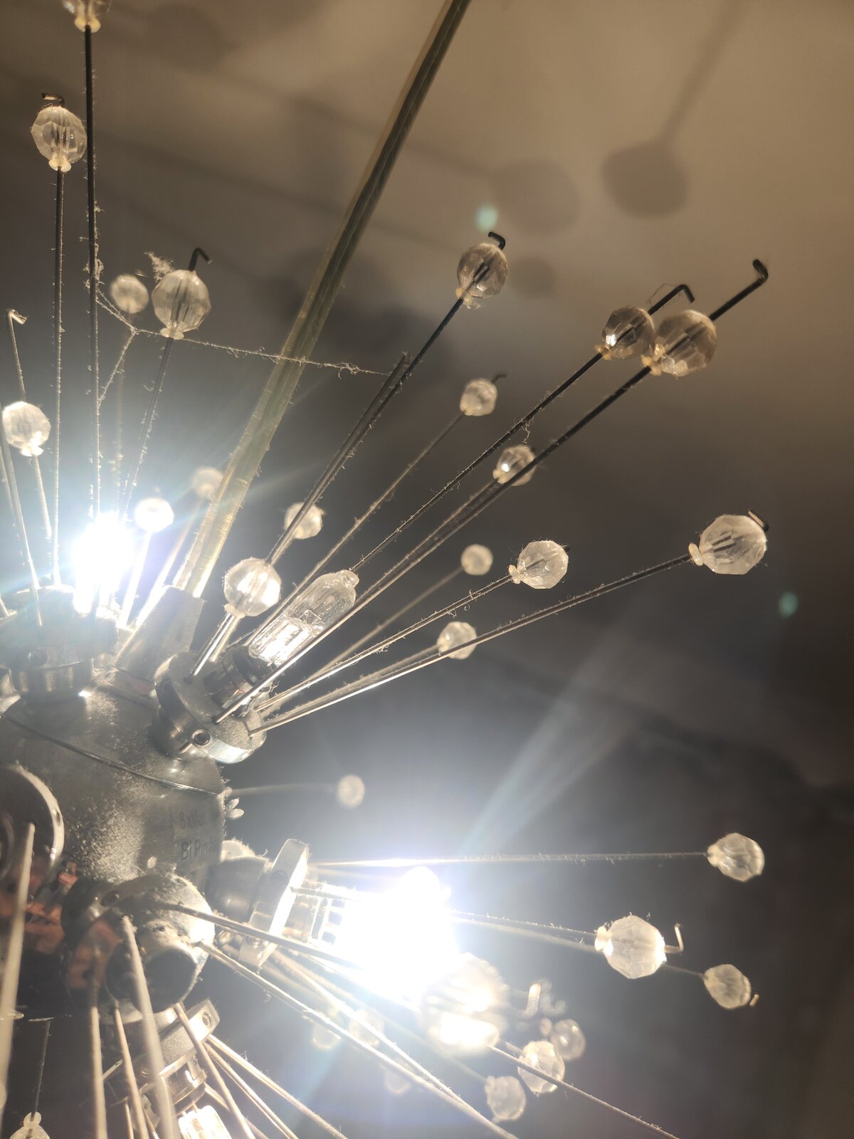

The "lamp" pictured appears to require FOUR G4 lamps.
Four (typical) 3 W 12 V G4 LED lamps would draw only 12 W,
4W lamps would draw 16 W etc.
G4 LEDs to replace Halogen G4 Lamps are available as either DC or AC types.
It may be best to purchase AC types,
since they are actually DC types with an inbuilt Bridge Rectifier,
so that the do not "care" if they are plugged into an AC Supply
or a DC Supply
of either possible configuration.

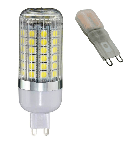

I must agree with @FrodoOne in fact with G9 bulbs I found local sourced bulbs were useless. The G9-comp.jpg large bulb to left, technically did not comply with UK rules, there was no lumen marked, no watts marked, however 4 out of 5 worked A1, the 5th I took apart to see how they worked, very simple, a capacitor used as a volt dropper, then full wave rectified, into an electrolytic capacitor nearly as big as the whole of bulb to right, to the LED's and a small leak off resistor. I also found a dry joint, corrected, and reassembled, been running now some 3 years.
Main point the bulb to left worked A1, the covers would not fit, but they worked. The bulb to the right had a shimmer when on, and would not switch fully off, but covers would fit over the bulbs.
