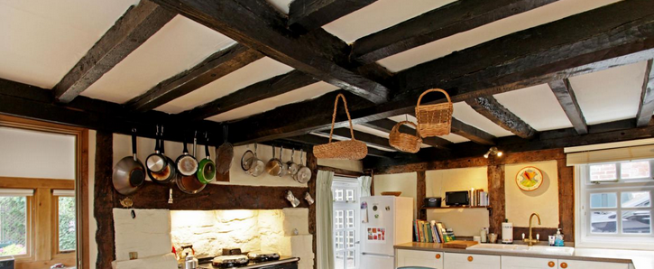

What do you mean by beams? upload_2021-12-7_11-35-27.png I tried to light a house like that and it was a nightmare. Wall lights seemed to work well beams too low for pendent, and if recessed then beams stopped light.

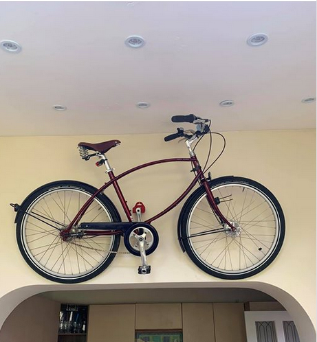

The LED has removed the problem with heat removal, but son removed the fluorescent in my old house kitchen, I had a 24 watt LED replacement for fluorescent tubes which lit the area well he did this Kitchen bike.jpg 16 x recessed LED lamps GU10's double the amount of power used lighting no better, be he thinks it looks better, I do not think the place for a bike is on ceiling for decoration either.

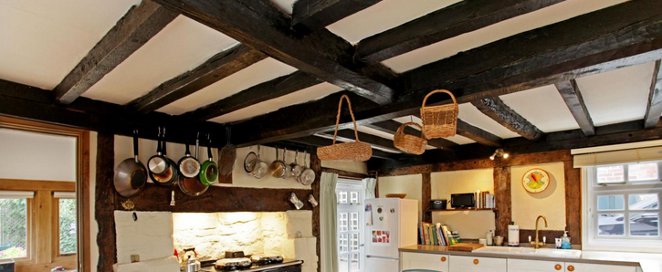

What do you mean by beams? View attachment 253356

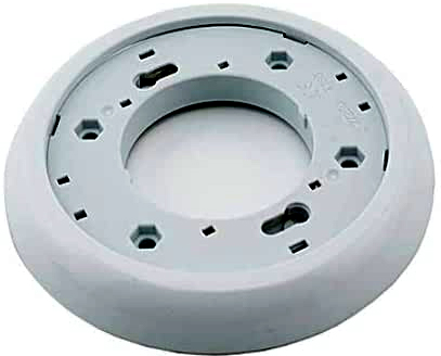

@Harry Bloomfield has raised a good point, 16/8th of an inch, or 2 inches seems name MR16 came from cathode ray tube days, but it is rather small. I have looked at 2D fittings in the days of fluorescent, fitted on in mothers kitchen as could not find a class II fluorescent tube fitting. The GX53 seemed a good compromise GX53-lamp-holder.jpg still renewable units, do not like integral LED's, and at 5 inches just that little bit bigger, so better spread, and surface mount so no large holes in ceiling, but they don't seem to have caught on, I wonder why?

By beams I mean the joists in the floor above. The lights themselves are for the entrance and corridor of a standard ground floor 2 storey house.
To centre them I would hit the beam/joists above but by moving slightly over could get away with the aesthetic positioning but they literally come up in the ceiling above right next to the joists... just a mm or so away. There are no other combustible materials around their positions.
