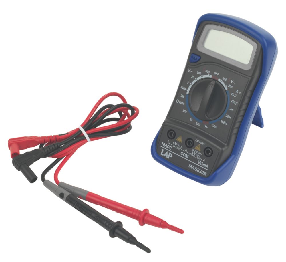

However even though a voltage tester like this
uses very little current it in general is 100% better than a voltage pen which makes no contact. The idea of most voltage testers is to have no switch, so it can't be in error switched off, the idea is you test the tester with a know voltage source then test to see if dead, then re-test the tester, I know this does not apply with what you are doing, but they are designed to work with very little current so even the tester shown can show a circuit is live when it is not, or at least not enough current to do useful work, just enough to give you a shock.
The multi-meter should not really be used to prove dead, but it can be used to show voltage is there, and with a clamp-on type also show current is flowing. But I was dismayed to watch some 'A' level students trying to use a multi-meter in a Physics class and over 50% of the meters ended up with blown fuses where used incorrect. I am told 'A' stands for "Advanced" I hate to think what a normal person would do! As a result I am loathed to recommend using a multi-meter, specially as most are supplied with leads which are not suitable for low voltage (230 volt) work. However they are likely the cheapest option. That Martindale tester which is really the industrial standard tester for voltage costs around £44 but the multi-meter like this one is just £7.50
ae235
so it is very tempting to buy what if you know how to use it will do so much more. What we can't work out is your level of skill, if better than an 'A' level student then multi-meter seems the way to go.
