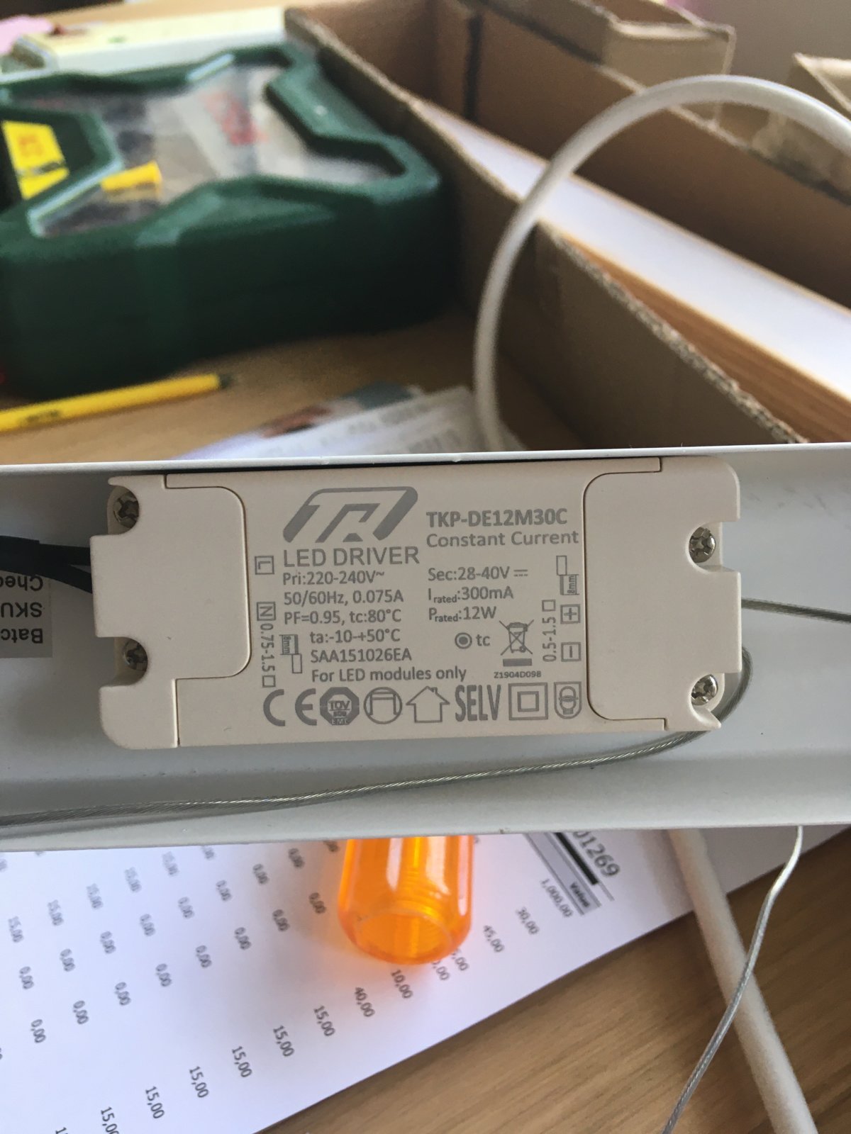

Hi all,
I have a pendant light with built in LEDs. Is this able to be dimmed?
If so what type of dimmer switch is needed?
If not then could the driver pictures be changed?
Thanks, Tom
You'll need a different driver, but it's unlikely you'll be able to dim it with a traditional dimmer. Most constant current drivers will need a separate 0-10V, DALI or PWM input for dimming.
