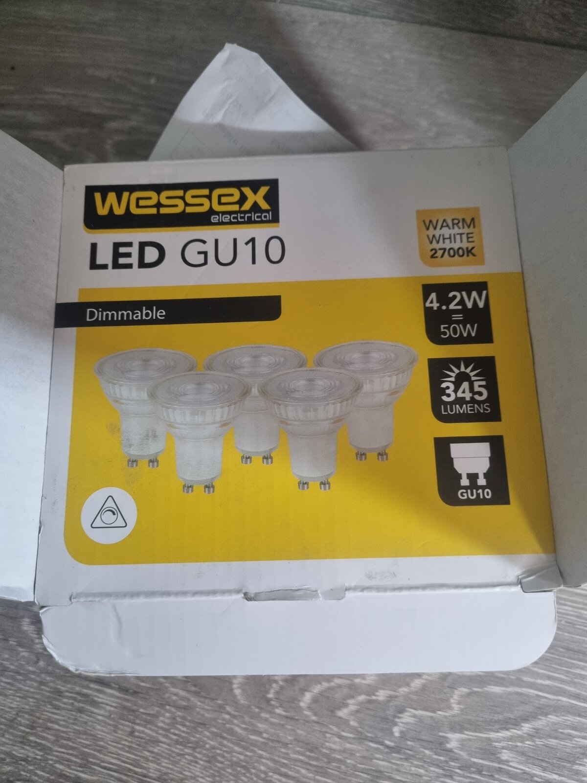

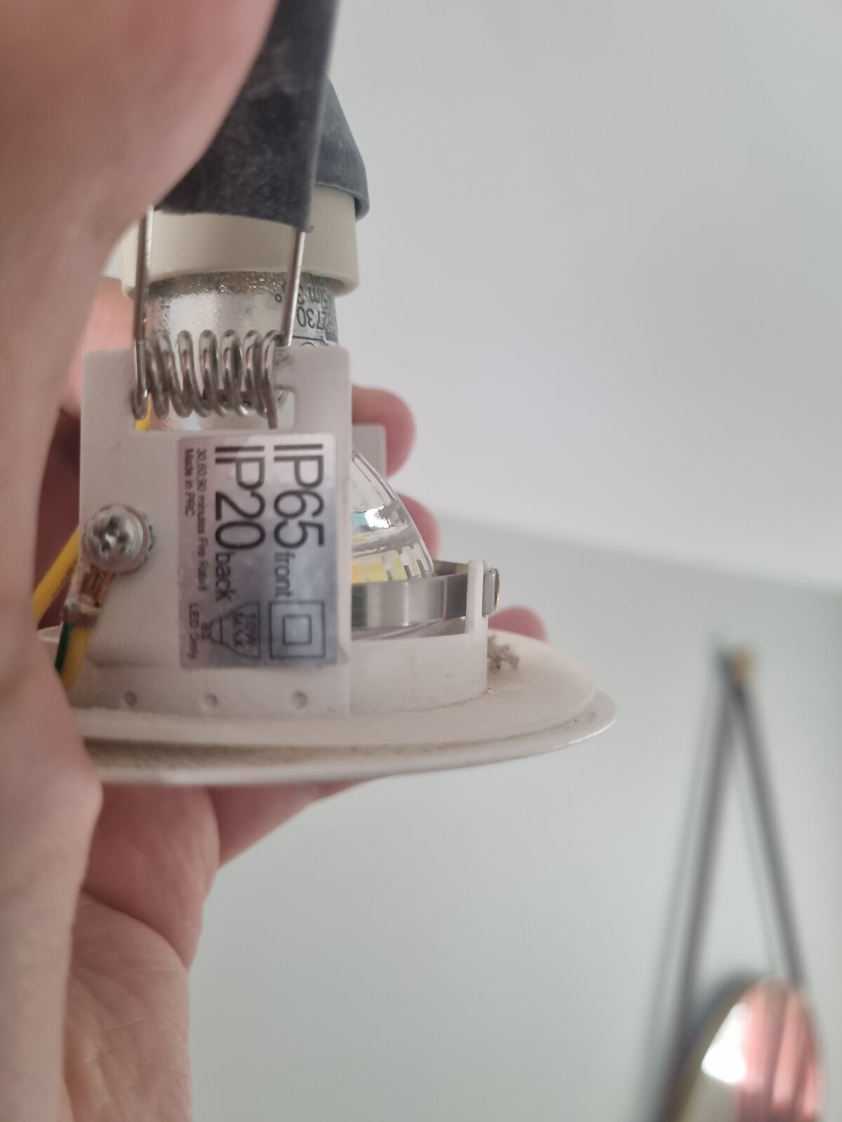

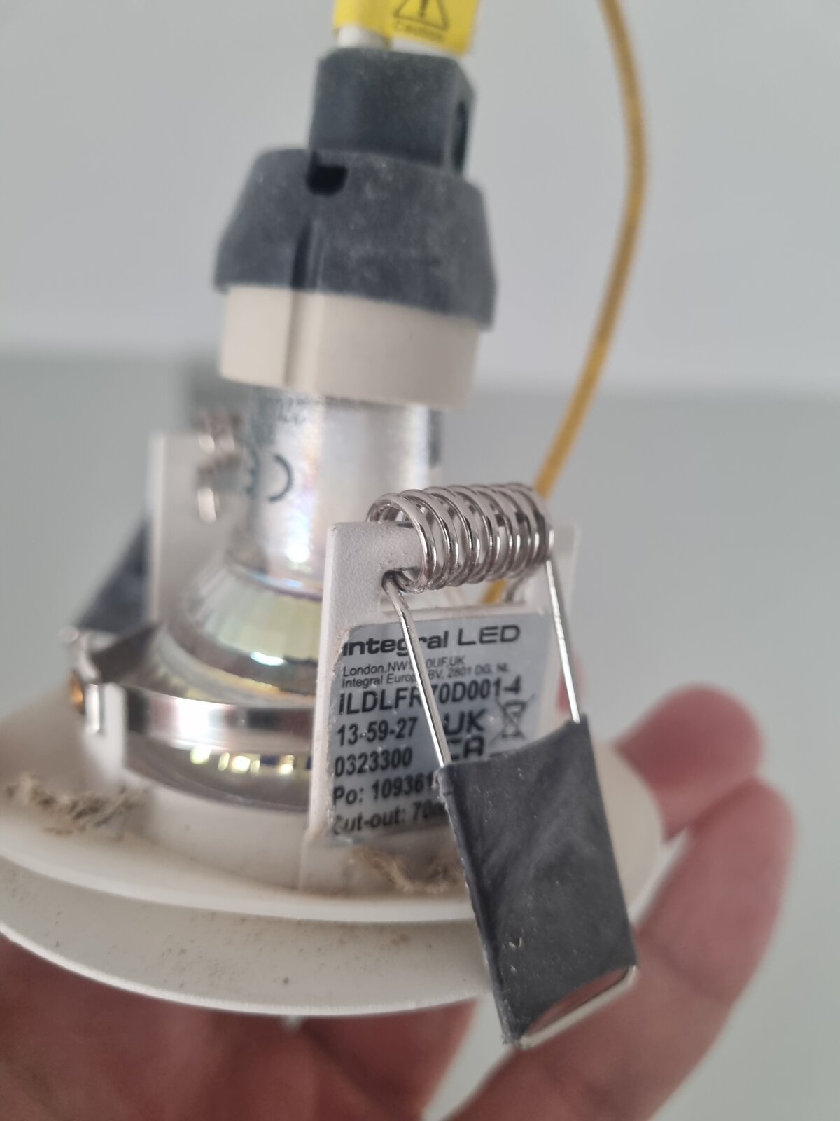

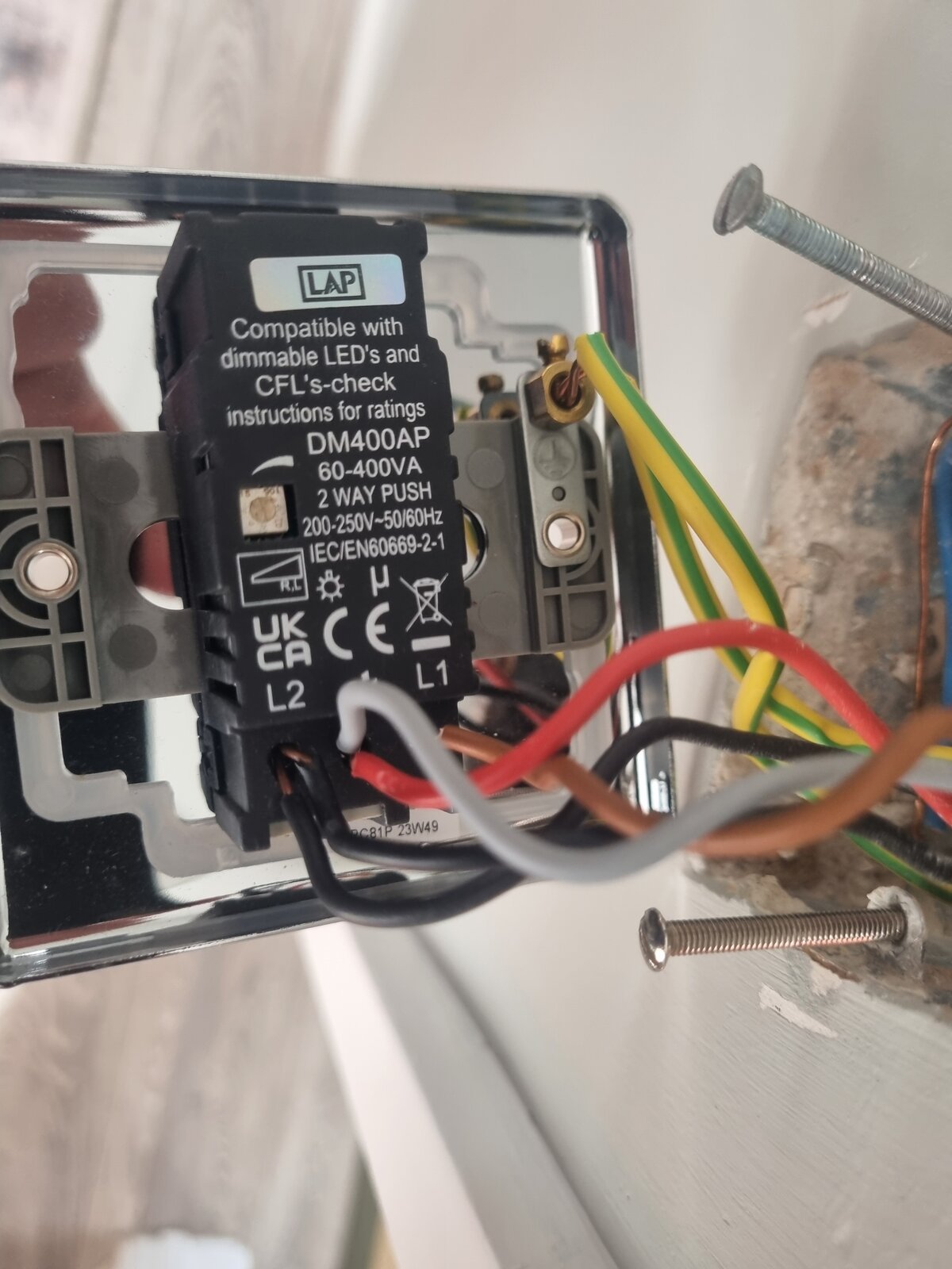

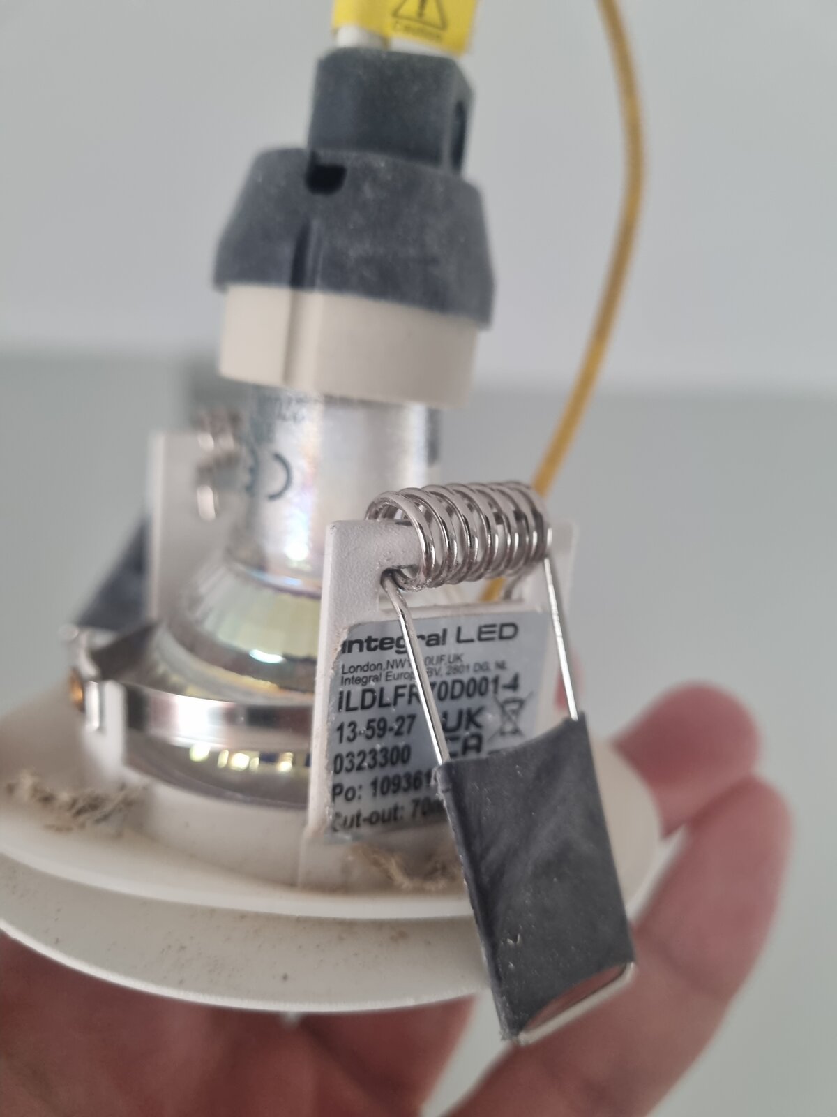

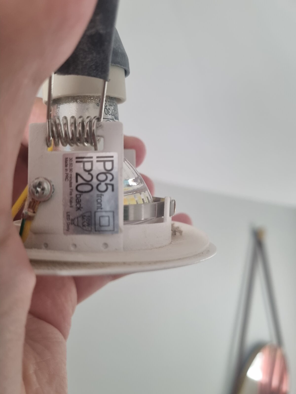

Hi all, I'm having a little problem getting my led lights to dim! I installed some dimmable led lights, and attached a dimmer switch! Light go on and off, bit won't dim! I've attached some pictures, am I doing something wrong? There's 2 switches in my room, so far I've only replaced one to a dimmer switch, could that be the issue? Thanks

Simple 4.2 watts is nowhere near the 60 watts minium for the switch.
I use smart bulbs when I want to dim lamps, as it also can adjust the colour to give the ambiance I want.

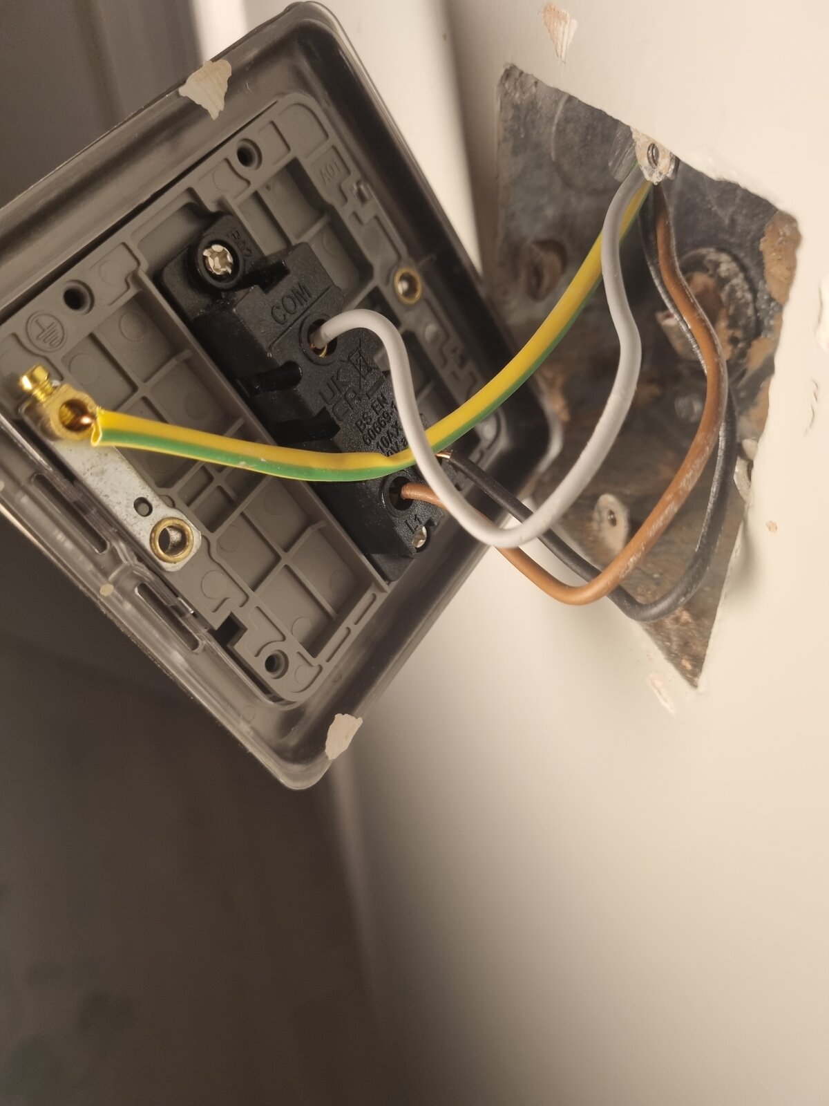

I agree the dimmer minimum power of 60W is very high (assuming you don't have 15 of those lights) however I'm guessing it's wired wrong anyway. I would have expected the red wire to be in L2
Do you mean L1? @SUNRAY

Ah OK with 14 it should work.
Are you saying you have installed 2 dimmers? I believe only one can be used.

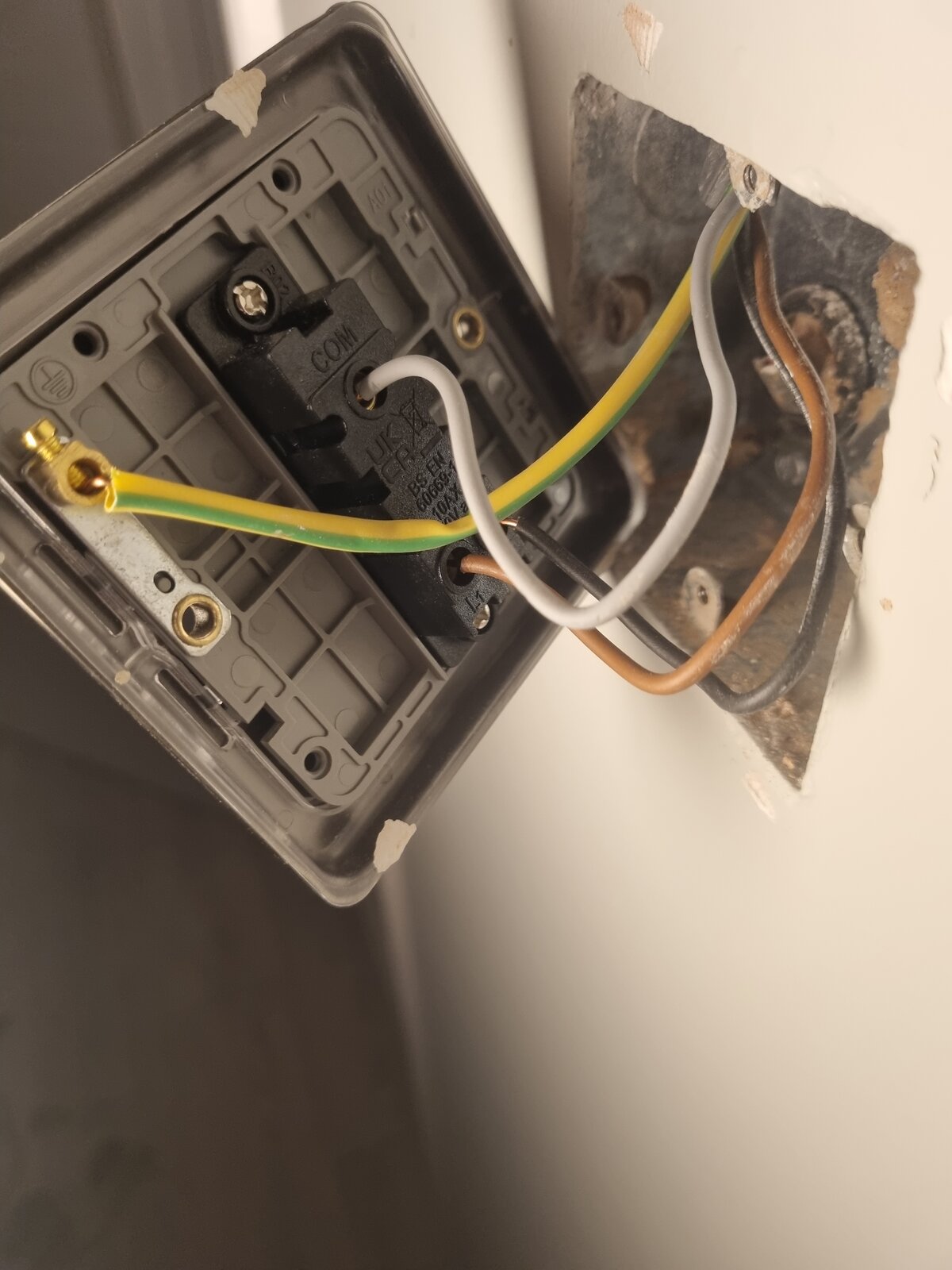

Can we have a pic of the other switches wiring please?

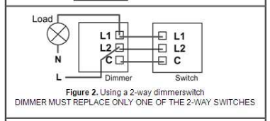

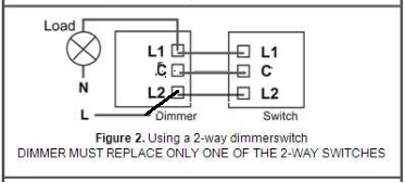

If the brown/black/grey cable goes to the other switch and there are no other cable at the other switch I'd expect it to be wired something like this:
What I see is this
Please look at the other switch before making changes
EDIT: Apologies, I've drawn this differently to what you currently have, hold fire while I amend my drawing

If the brown/black/grey cable goes to the other switch and there are no other cable at the other switch I'd expect it to be wired something like this:View attachment 392319
What I see is this
EDIT: Apologies, I've drawn this differently to what you currently hold fire while I amend my drawing
Should be:
I see :
This is assuming the other switch (that shown on the right) is wired as shown here.
Picture of the other switch wiring please

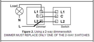

In fact what I've unknowingly done is draw the same wiring as this from the dimmers instruction sheet
Except I've drawn it showing the terminals in the physical order of the dimmer.

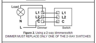

It could better be shown as:
View attachment 392324Except I've drawn it showing the terminals in the physical order of the dimmer.
Thanks mate, here's the 2nd switch! 2nd switch is just a regular one, not dimmable! It works fine as currently wired!
Excellent, yes I did mean L1 but apologies I inadvertantly drew my coloured sketch reversed.
Yes move the red to L1 with the brown. That should give the correct switching arrangement whether that cures the dimming issue I don't know but I see an ajustment on your dimmer, presumably to set minimum dim level, it may be worth checking that isn't set too high. Other than that, others have suggested a trailing edge dimmer.
And trimming the black at the switch to prevent the copper showing would be good.

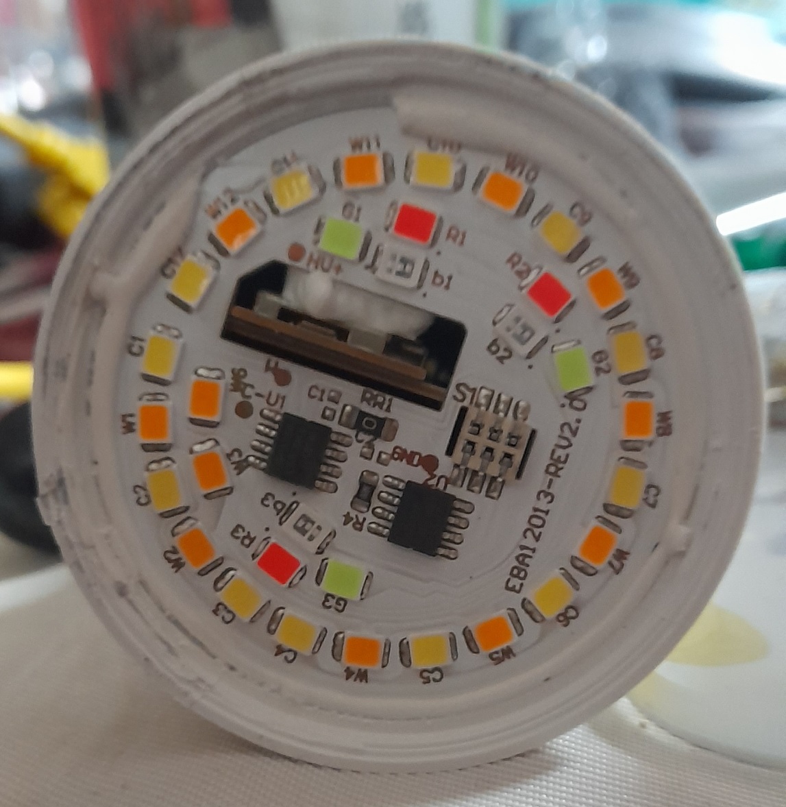

Looking inside the last bulb to fail on me, a 9 watt TCP TCP-ex-pond-bulb.jpg not all the chips are the same, some are low colour temperature and some are high colour temperature, and by varying how much power goes to each it can give a whiter or redder light. The early bulbs before the smart bulb hit the scene would only dim the whiter LED's so it seems as if the bulb is getting redder as it dims, giving an ambiance similar to a tungsten bulb. It seems these were very popular in the USA, but not used so much here.
When the smart bulb hit the scene, and as they came down in price, with GU10 bulbs at around £5, there was not that much of a sale for the bulbs which went redder, so they have disappeared.

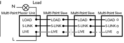

Varilight Multi-Point slave dimmer switches must be used with the Multi-Point master and will not work on their own. Slaves allow 2 way or even 3 way dimming. This means you could dim the same light from multiple locations.
The S-link is wired similar to the com with these switches,
but it is not a com, and the switches need to be wired as master and slaves,
other makes have different ways to wire them, no longer does one wiring diagram suit all. I don't know if you can get smart dimmer switches? I know we use smart lights in the kitchen, so we can turn them on without putting flour covered fingers on the light switch, on/off and dimming even colour change of counter lights is voice commands.

My old kitchen had a 65 watt fluorescent lamp, latter a 24 watt LED tube replaced it, son now has the house, and now 14 GU10 down lights, at 4.2 watt each that's 58.8 watt, are we going backwards?
