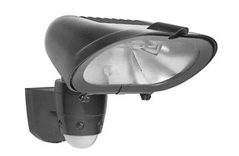

I have one of these lights at the back of the house and am now looking at changing to an LED version BUT without the PIR - I will be fitting a separate PIR that I need to connect via a relay to the SELV garden lighting. The idea being that if the garden lights are on then the flood light does not operate, and vice-versa.
I need the lamp head to be rotated to cover the patio rather than shine down the garden. Any ideas on a suitable alternative?

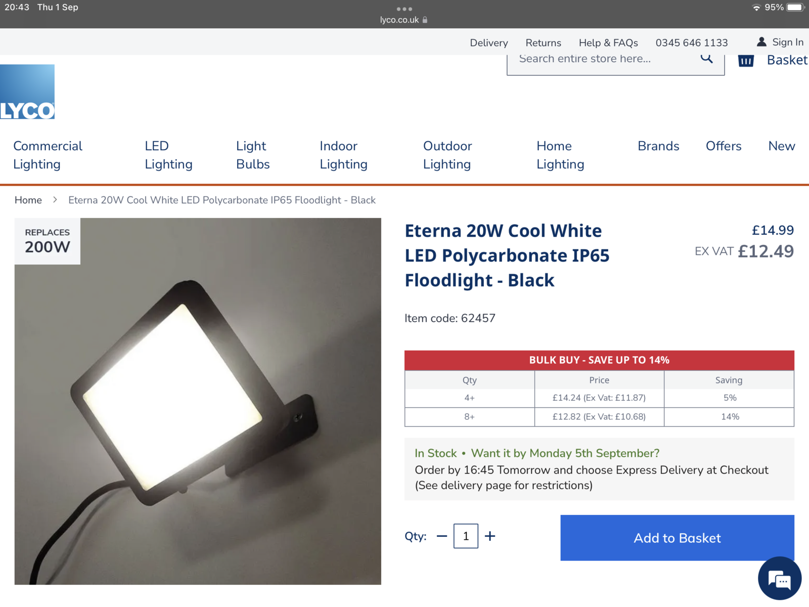

Lidl regularly offer on the centre isle a 20w LED, for less than £20. It does include a PIR, with settings for sensitivity, light level and on time - but you could defeat these with adjustment, to have it operate from your own separate PIR. It's a flat panel, looking rather like an Ipad, on an adjustable bracket.
I primarily bought and installed one to light up the area of where my wheelie bins are stored, but it proved to be bright enough to provide some light to much of my large garden. Far more light than I had anticipated from a 20w LED.

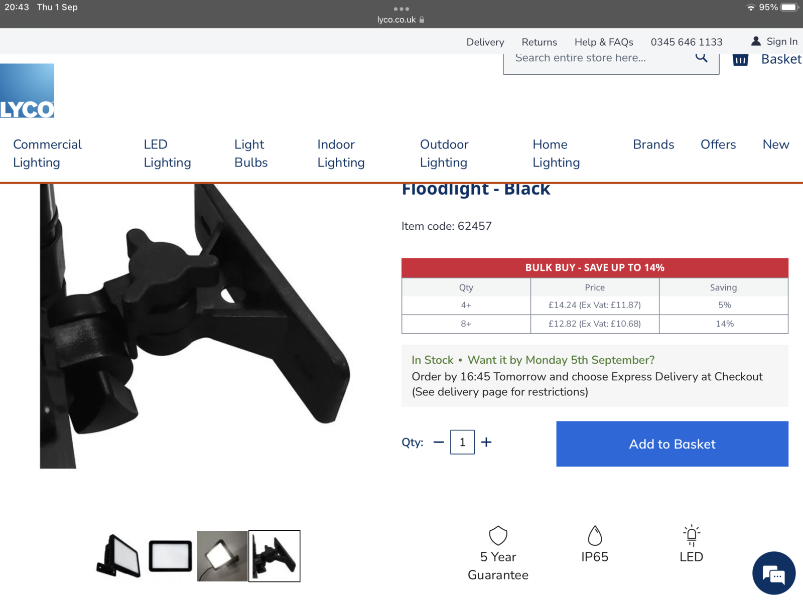

Go on lyco ….they do an led light you can tilt and swivel , I’ve had a few and they have been spot on ….no failures…
Thanks for the suggestion! I knew a spark would have the answer.
I expect the 10W version would be adequate for my needs as it will be replacing a 120W halogen
