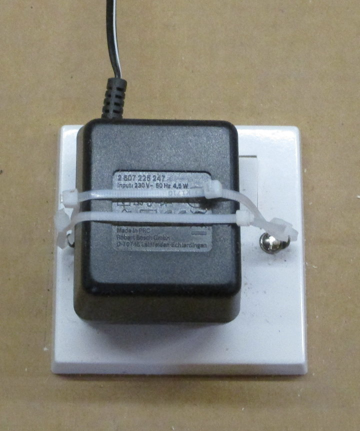

How about one of these lockable covers,
https://www.insight-security.com/socket-pro-safety-cover-locking-lid-for-double-13a-socket
Or a simple retaining strap that prevents the plug from being removed and is held in place by the front plate securing screws. ( if they are still being sold )
How about one of these lockable covers, ...
Indeed - but no good when (as is very commonly the case) what needs to be plugged in is a wallwart. However ....
... as I've illustrated before, this is what I often do - with cable ties secured to the front-plate screws using solder tags ...
Anyone who cuts those cable ties and plugs in a vacuum cleaner deserves anything/everything that results!
Kind Regards, John
