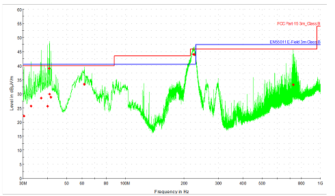

Take your 'smooth' DC output from a switcher and have a look at it with an EMI receiver and you'll see it's anything but smooth. Here's a recent measurement of a high quality PSU from a very well regarded manfuacturer into a 50W load
Everything is relative ! It's pretty well a given that any PSU will have some noise on it's output - but some manufacturers at least filter it as far as is practical; others (like the Chinese Export ones with filter components left out) simply DGAS.
