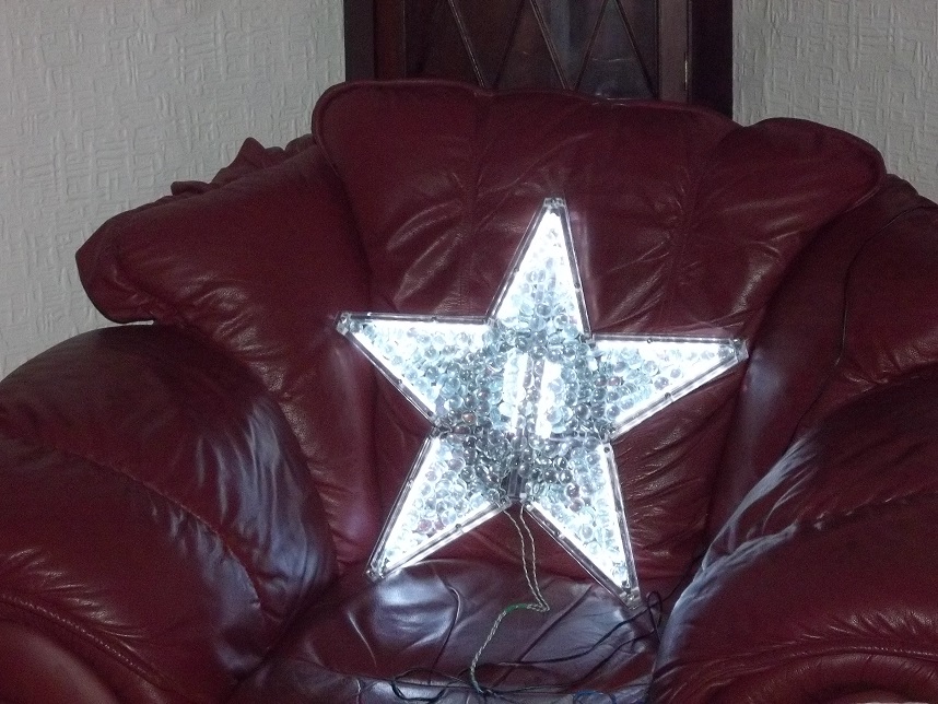

For what its worth this Cnristmas Tree Star has 12 volt LED tape ( 102 LEDs ) with a 30 foot lead from a 9 volt DC power supply ( NOT an SMPS ) and pulls just under 500 mA,
