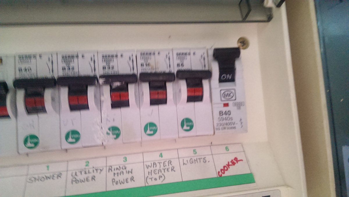

I have installed a set of led wire and track lights however since installing them the circuit breaker trips 1 in 5 times or so that the lights actually get activated (the circuit breaker only started tripping after these new lights were installed).
At first I assumed there was a loose connection or some problem with the work that I had done (I am not a professional I hasten to add!) and so went back and checked all of the connections and wires upto the transformer - no fault found.
I then decided to leave the transformer for the lights connected to the circuit, however I disconnected the two output wires that go from the transformer and fix on to the two track wires and since then there has been no problem with the circuit breaker tripping - leading me to assume that the fault lies somewhere between the transformer and the ligth fittings themselves.
I have searched the internet but except for one vague reference in a post on this forum I have not found anything to suggest this is a common issue. If anyone has any suggestions as to what might be the problem or how to fix it, or even any knowledge of the issue it would be much appreciated. Unforunately I can't just return the lights as they were installed about four months ago just before going away for work for a considerable period, so not much chance of a refund!
thanks for any input.
Regards,
N.
Wire track tends to use Toroidal Transformers, there is a lot of "Inrush current" with these and are prone to tripping mcb's usually "B" type ones, sometimes a soft start transformer or dimmer is better.
Electronic Transformers are not used due to EMI from the length of wires

Hi and thank you very much for taking the time to reply.
@Rocky333 = I am afraid I don't know anything about toroidal transformers but I will look it up and hopefully that will help make sense of what you are saying. understood that the inrush current can 've a factor. would these issues not still be present even if the actual track was not wired to the transformer?
@Taylortwocities - I believe it is the mcb tripping according to your picture. I have taken a photo so you can correct me if I'm wrong. It is the breaker marked 'lights'.
Thanks!
N.

Yes, it sounds like the MCB does not like the inrush current. You'll probably find it's ok if no other lights are being used at the same time?
There is a solution, and that is to change the MCB to a 6amp type C. But there are some checks that an electrician needs to do before it is changed.
So you need a sparky.
Electrician has now been called.
@Rocky333 - I looked up the toroidal transformers and get the gist of it along with current insurge.
Hopefully upgrading the MCB will do the trick.
Thank you both for your help.

It may be worth considering a different type of transformer. Toroidals are not the optimum choice for large lighting loads in domestic applications due to in rush.

Getting the mcb could be a chore, not sure what make you have, but Series E suggests possibly GE, steeple or sector, which I think were the same just branded different, but whether the current versions are still the same I don't know.
I note some one has fitted an MK one at the end which may again have been the same just rebranded, unfortunately that MK range has been superseded by a newer one that i'm sure is a different profile so MK proberly not an option.
A rated seller on ebay may be your only option.
