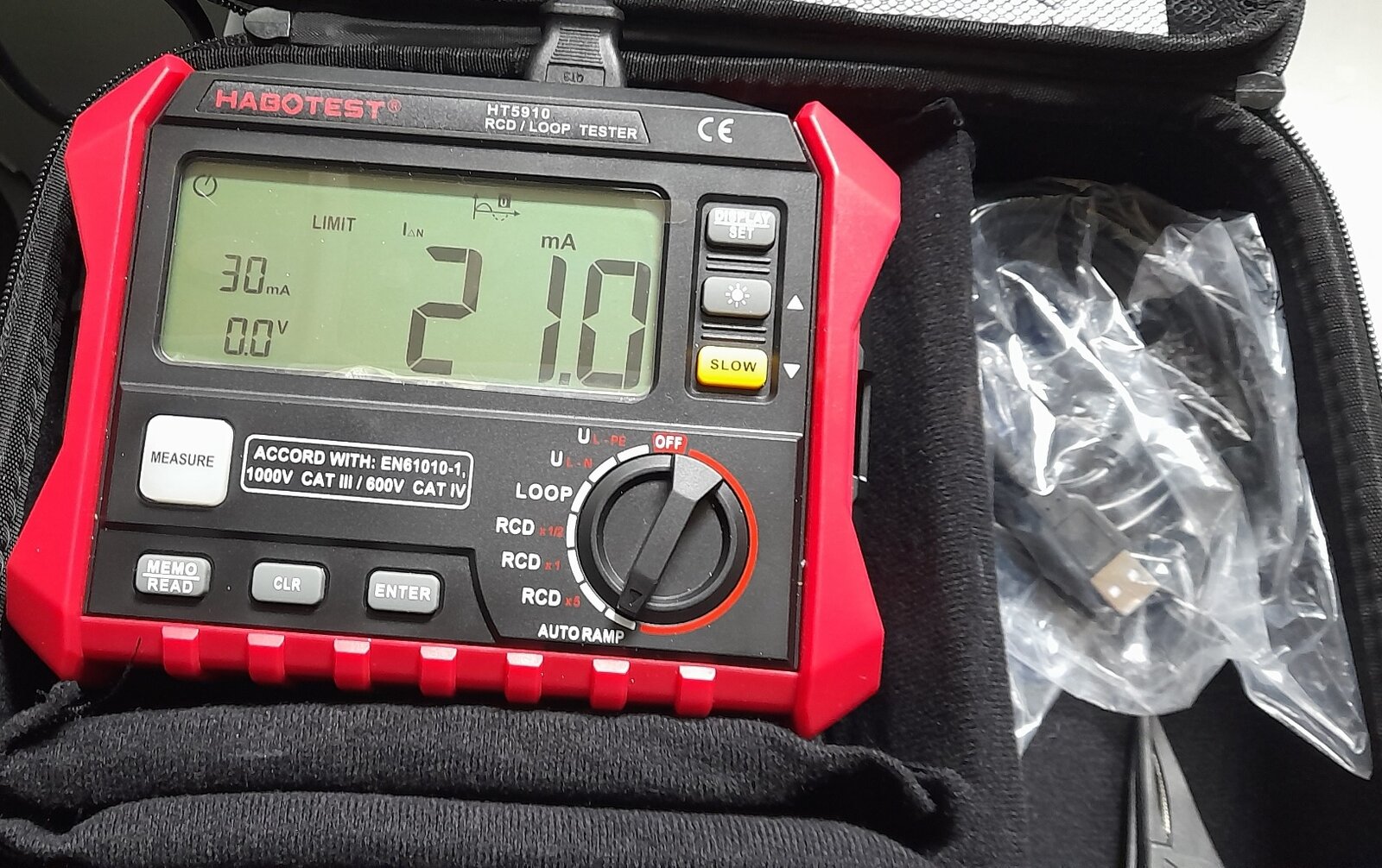

without the meter it is guess work, and since the meter will only show leakage with energised circuits, once a circuit is tripping it is not much use. The insulation tester VC60B.jpgwill find most faults with dead circuits, but since some faults will only pass AC it again is not 100%. We also have in our arsenal the RCD tester, RCD tester ramp.jpg but that is an expensive meter, so unlikely for a DIY person to have one.

But due to the cost of the test equipment shown, if you can't see the fault, then likely only option is to call an electrician who will have the test gear.

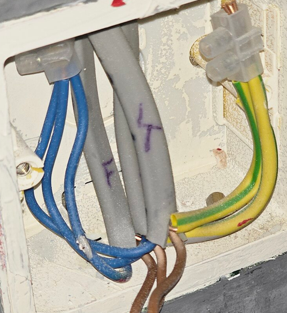

Is it just 1 light on the circuit?
Do you have a neutral connector in the back of the switch, something like this (except in your case there will likely be only 2 cables)
