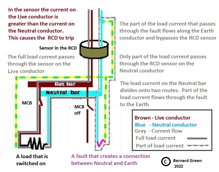

I assume that a main RCD tripping while working on an isolated (at the breaker) circuit, means neutral to earth current. Is it a sign of a fault somewhere else?
More likely you accidentally caused an NE fault when manipulating the cores, but not impossible.

The current will be from items being used on other circuits because all the neutrals and earths are connected together somewhere.
I had better rephrase that.
All the neutrals are connected together on the RCD circuits and all the earths are connected together in your installation
@richardindorset while the other circuits will still be live and when you touch the neutral and earth conductors it gives the current returning on the neutral an alternative path (the earth conductor) meaning that slightly less current will return through the neutral causing an imbalance hence tripping the RCD.
the higher the load the higher probability of the rcd tripping.

Bear in mind, If there is already a neutral to earth fault in any circuit circuit when shorting N and E, the current that should flow to the outgoing neutral, though the coil in the rcd can flow instead along the final circuit neutral through the fault and to earth bypassing the coil in the RCD. If the relative resistances of the two possible paths are right there then may not be enough current to trip the RCD...
