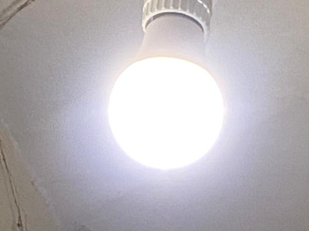

Just got one of these on an overnight delivery. Give it a go...

, but the LED in the main sends all light away from the base, so same 3 bulbs can have the base at bottom, top, or side, depending on the chandelier ...
Whilst that may be true of LEDs with clear (transparent) envelopes, I'm again not so sure when the envelope is (much more commonly) translucent, and therefore acts as a 'diffuser'. Although it's difficult to really assess in a photo, the envelope of this LED looks pretty evenly illuminated to me, hence likely to radiate light in most directions, seemingly missing out on perhaps about 50 or so of thee 360 possible degrees ...

Diffusers or pearl glass can help to spread the light, but the LED often has a flat plate inside so be it a GU10, candle, or golf ball bulb the inside is the same, a flat plate with surface mounted components designed to remove the heat from the LED chips. Yes I know in the latter years of the tungsten bulb the government banned the use of pearl glass, never worked out why, if the same rules applied to LED they would be even worse as giving an all round light.
