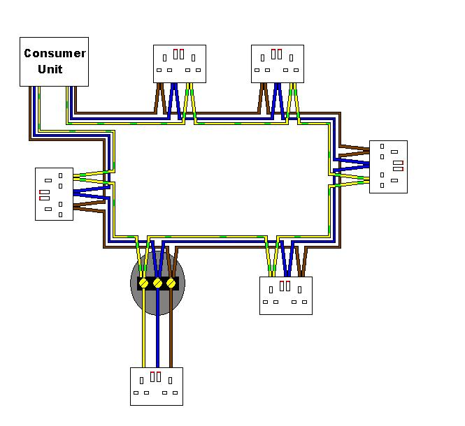

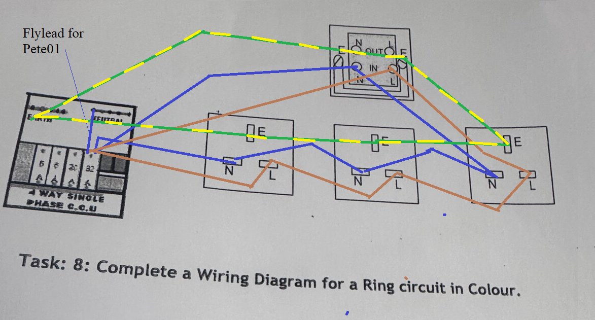

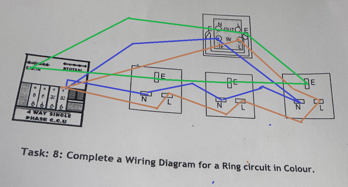

The ring circuit is not a ring! If it were a ring then there would be two conductors at the mcb, neutral and earthg bars.
Maybe its the way you have drawn it, but the ring starts and ends in the CU, not outside.
It's our old friend, the lollipop, so almost a ring. OK if the "stick" cable is 4mm². Or possibly 6.
PS What is the double pole device at the top of the two diagrams?
I was thinking that but the top sketch is like that aswell? Is the top sketch part of the question? Or did you do that?
A red herring? Put there to see if the students can follow instructions, and not do things not asked for?
Or sloppy workbook production - what's the betting that a future question is about adding that accessory into the existing circuit?

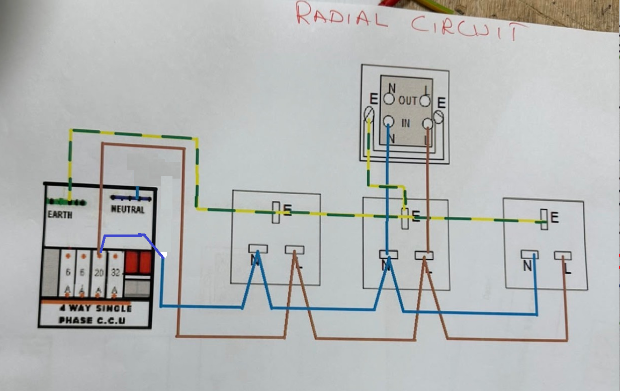

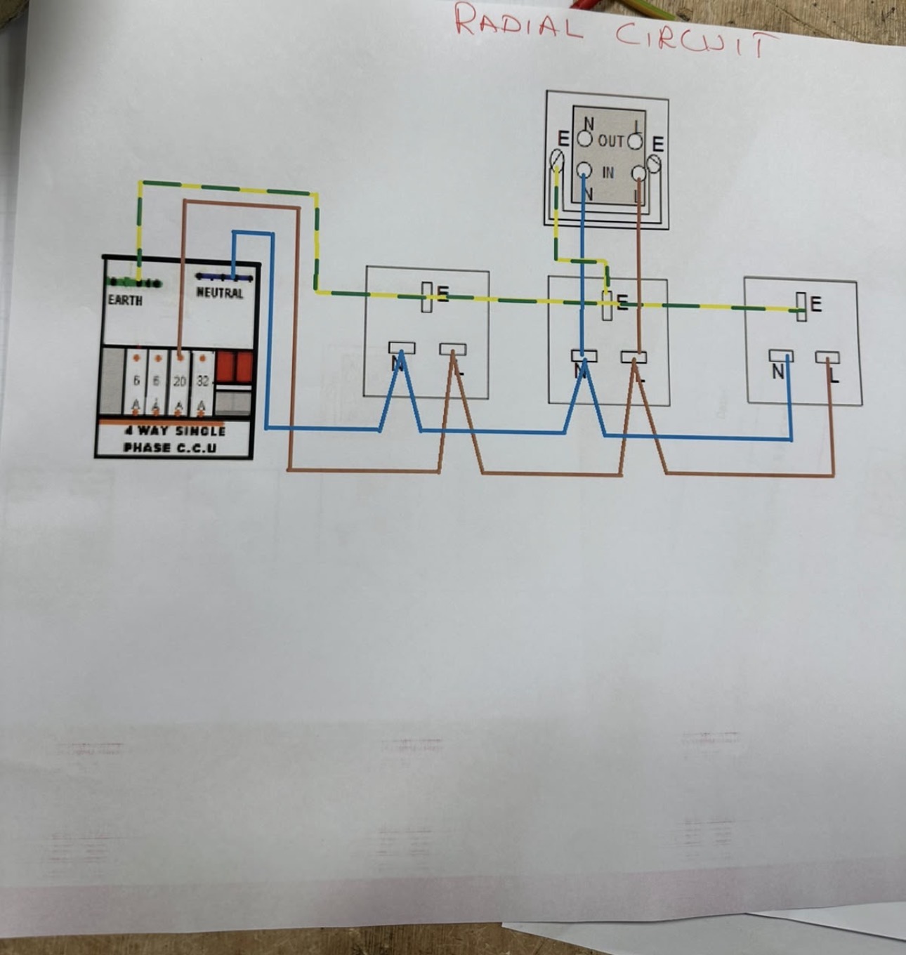

1791907310908.png Radial with RCBO. Sorry, yes he need to understand a ring final, I after my accident went to collage, I was allowed to sit in on a course, and I really wondered what children are taught is school, simple question, what as well as copper can be used at a conductor, I looked around the class, and could not believe no answers, and when I suggested gold, they felt I was leading them astray.

The post by jj4091 is the first to really get the point across. We're not trying to produce a schematic diagram, but to show how the wires (which are inside cables) will run.
Personally I think the printed material from this course is not fit for purpose, and was churned out with very little thought or understanding.
