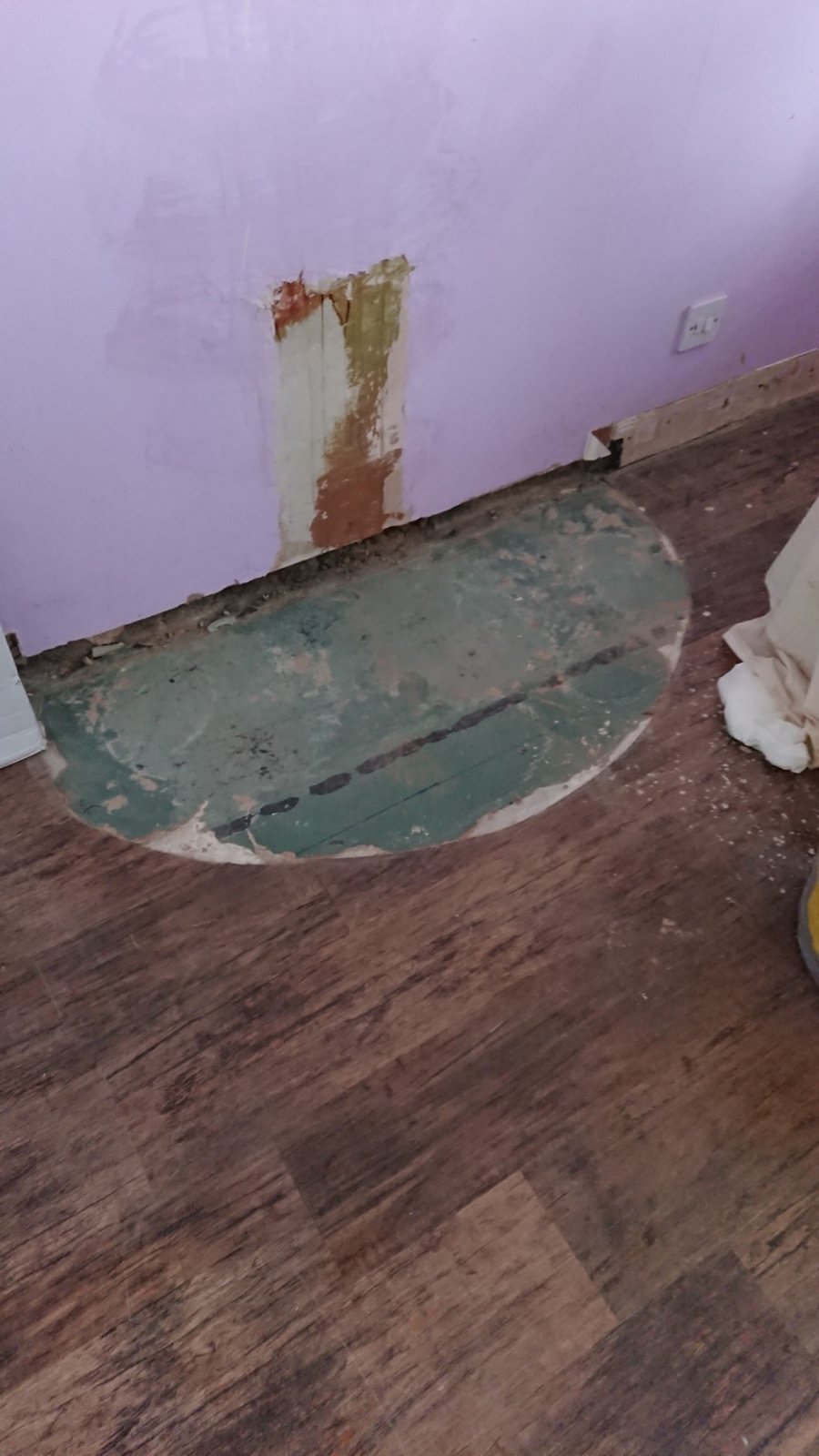

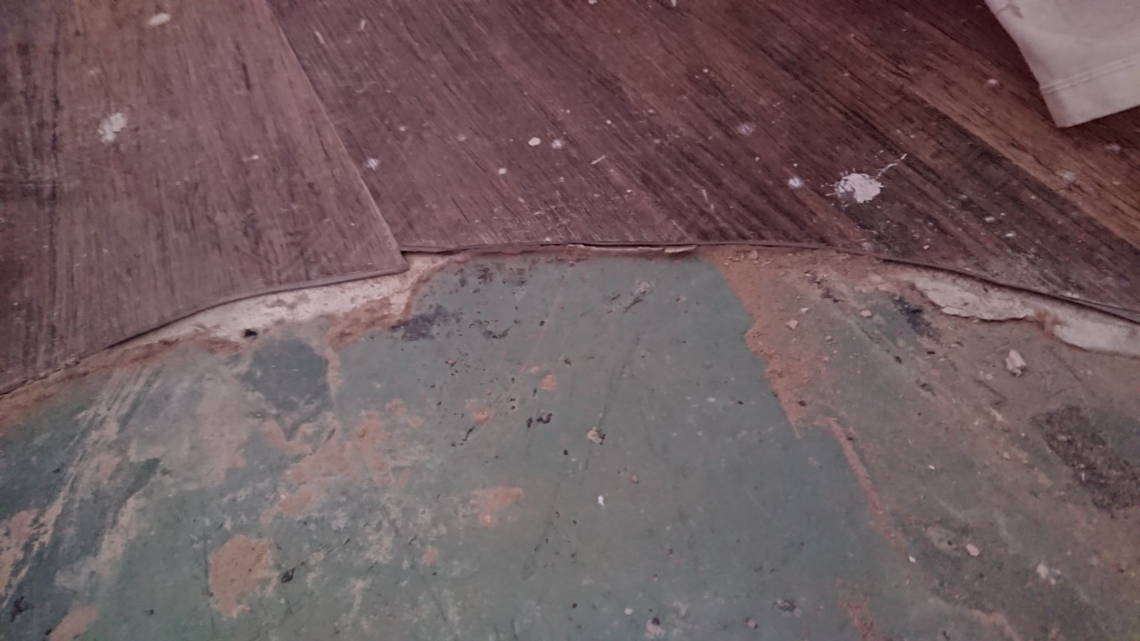

Hi,
We have removed an old log burner from our living room and the hearthstone and there is no flooring underneath. The rest of the room is a kardean vinyl and floor is concrete and we want to put carpet down. What’s the best way to level the floor before we put the carpet down?
Thanks a lot.
Sorry it took a while to come back to you. Difference in level is about 4mm I would think. Couple of photos attached.

Floor levelling compound- maybe with some similar material on top but probably not
The carpet fitter should advise
