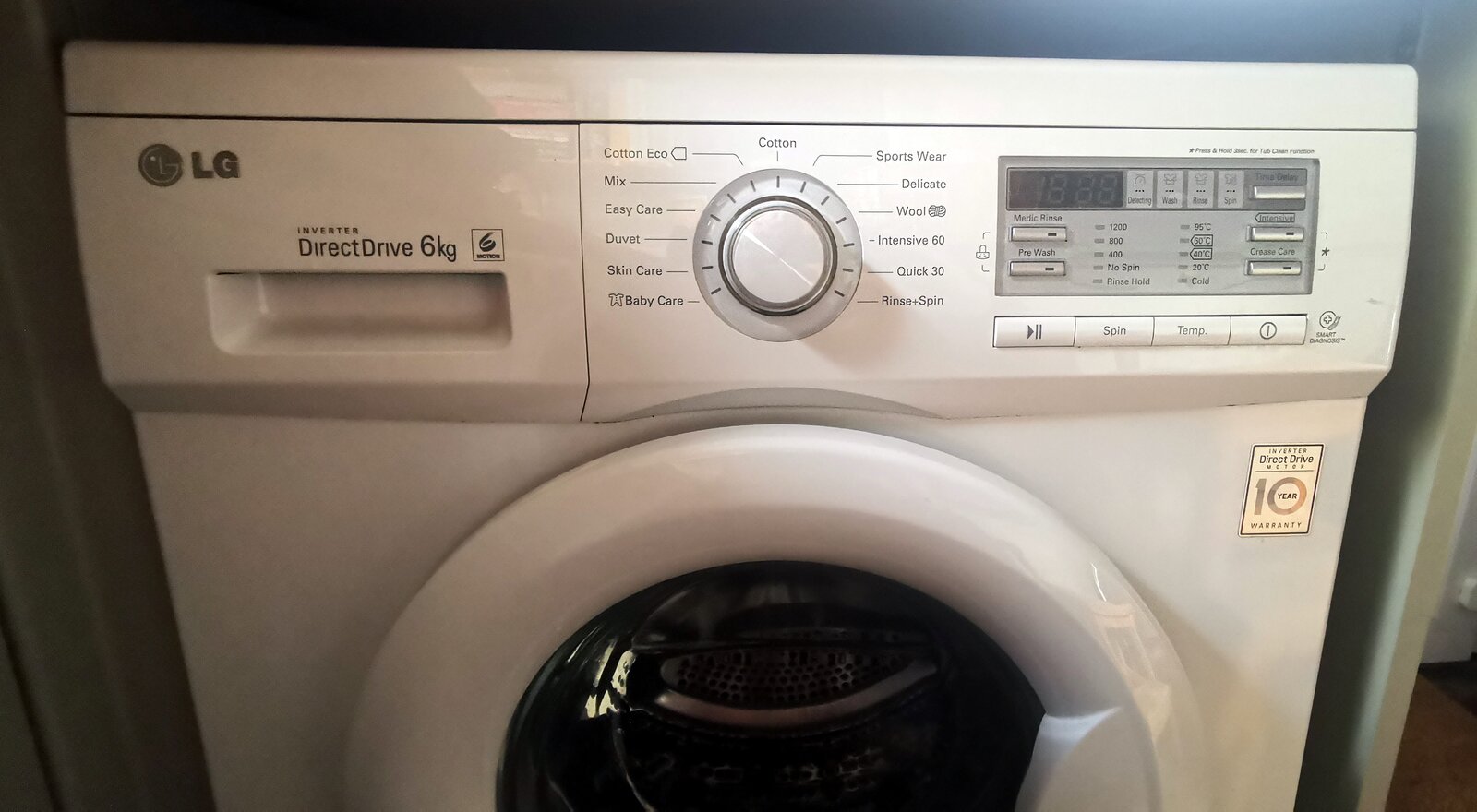

I have one of these LG washing machines that is excellent when working but of late (purchased 2015) the water in the wash fails to heat. The cold inlet is fine as the machine fills up and also runs a complete cycle but the pods don't seem to dissolve either. Contacted my local appliance repair man who told me over the phone it would be an electrical circuit board problem and LG would have to repair it at probably great expense. He suggested it would be better to cut losses and get a new one.
It's such a shame on just a small electrical issue the whole machine should be binned, especially when such a good machine.
Anyone think I have another option ?

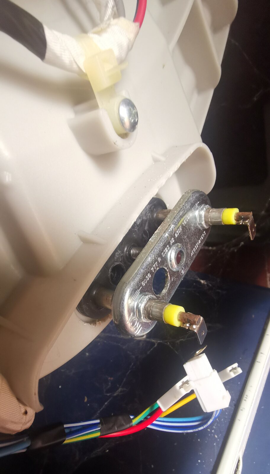

Ok, I have the replacement and watched a Youtube video on how to get it out. the guy used plyers and it was as simple as pulling carrots. Not so for me. tried pulling the nut on the end of the thread for purchase. It's impossible. Help!

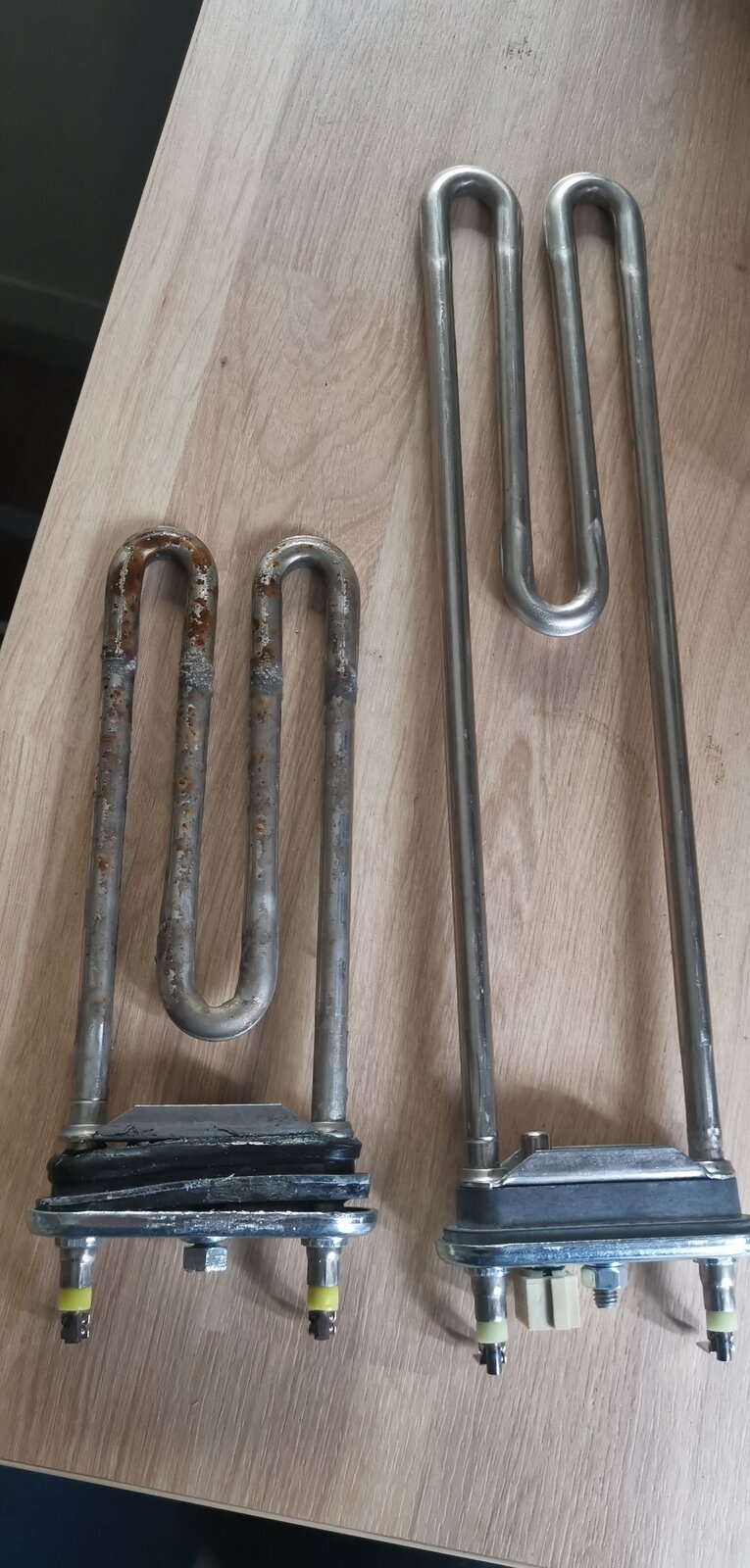

Ok, managed to get it out but being a Muppet I have obviously ordered the wrong part. The saga continues!
