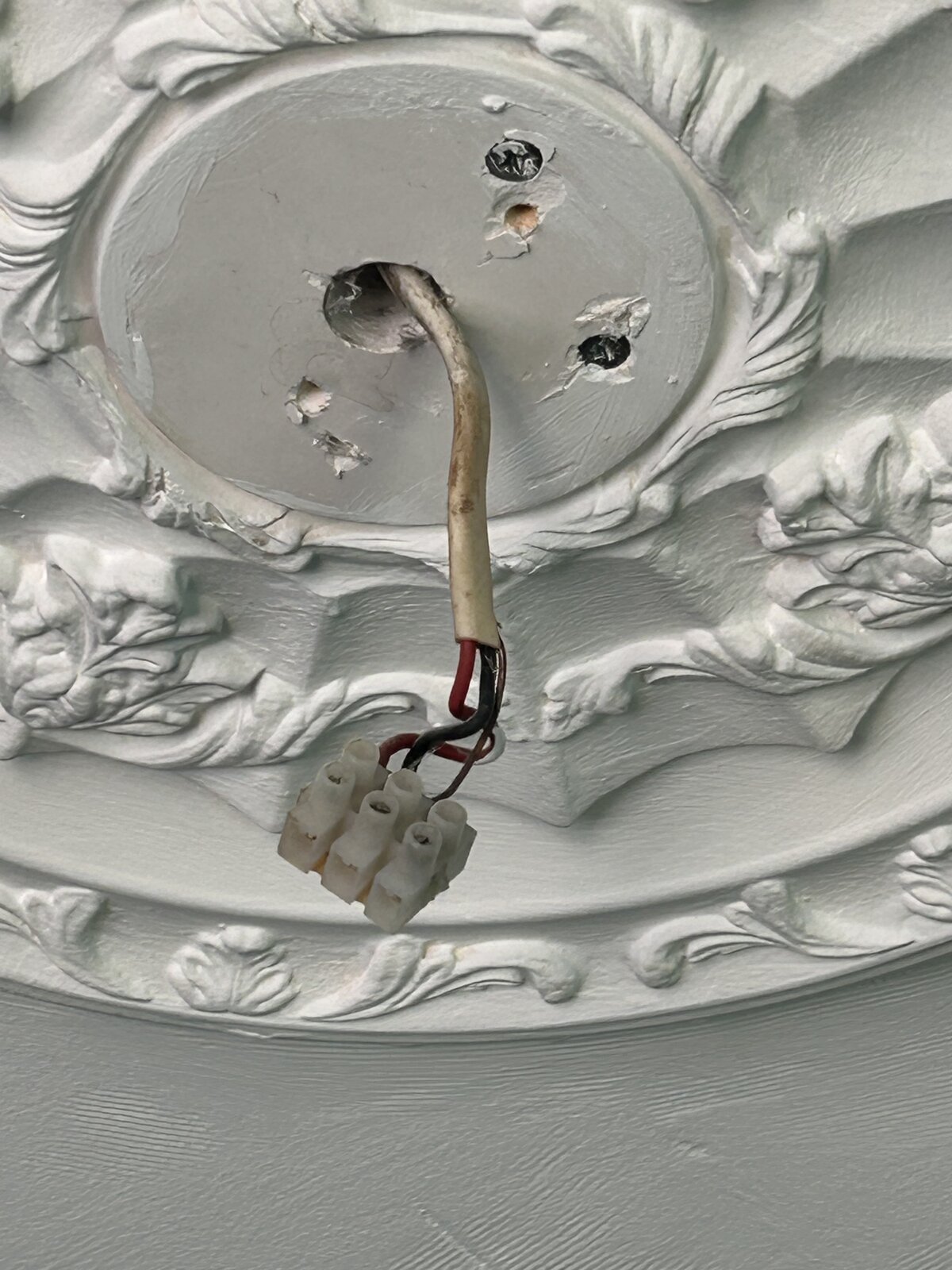

Hi Everyone,
Looking to work out whether I should attempt to change 2 ceiling light fittings or if I should get a professional in.
I have old wiring on the 2 lights in question as shown here and looking to swap for ceiling mounted metal fittings that have up to date wiring etc.
First question, is there an issue using metal light fittings with wiring set up in this way?
Second, is it an easy job wiring up to a more modern light fitting? And safe enough for me to have a go at.
Thanks all!

Metal luminaires should be earthed and that cable has the earth as the bare conductor. So, IMO, if you feel confident enough to have a go, turn the power off and try.

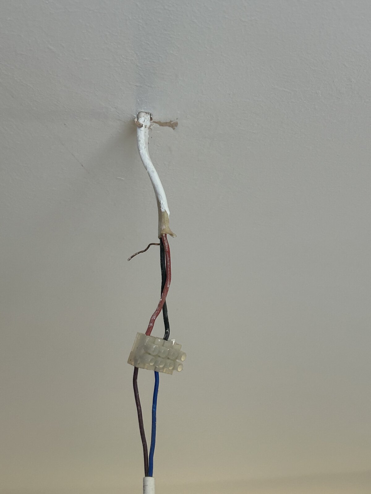

on the 2nd picture where is the earth - bare wire going
would be worth checking if the earth is really earthed
you need to add yellow/green sleeving to the earth
looks straight forward as all the junctions must be else where
Well you have an earth wire so should be fine (might need testing to make sure its connected to earth)
Yes it's simple, power off and live, neutral, earth

Are they actual ceiling roses or round junction boxes?
My ones are actual ceiling roses and I just have the wire that would go to a bayonet fitting coming through the ceilings. Probably breaking some technical rule but they’ve worked for me in this house since 1990.
I know of no regulation that says a rose cannot be used as a junction box, its just new to me and probably done by a previous occupant who was a bit of a chancer.
I do. The ceiling rose is designed to be screwed securely to something (usually the ceiling).
The cables, of course should be securely clipped to backgrounds.
Why? Because the ceiling rose has no cable restraints or other clamps that prevent cables being yanked out.
The same goes for those round junction boxes.
PLUS all of the above have screw terminals and these are not permitted unless tha junction is accessible (which a ceiling rose would be, if it were in the proper place - on the ceiling).
Under the floorboards is NOT accessible. To comply with regulations these must be a maintenance free certified junction box.
So thats probably three broken regulations right there.
