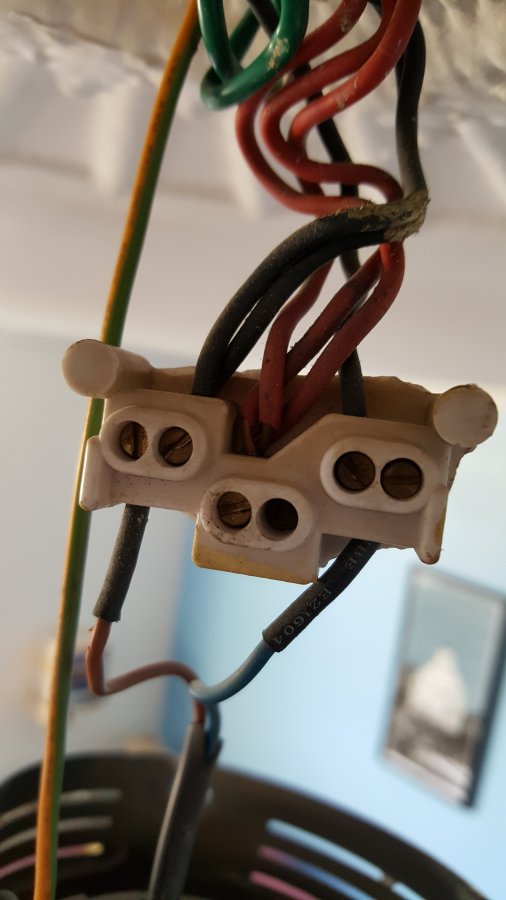

Can someone who knows look at this photo and tell me if I'm right?
I removed this light fitting today and I was a bit confused because I couldn’t find a match for the way the wires were connected anywhere online. By rights it shouldn't have been working. Suffice to say when I wired in the new fitting, nothing worked properly, and the light now comes on in the living room when I turn on the kitchen light.
I can only think of one explanation:
Has the guy who fitted the previous fitting reversed the live and neutral wires of the fitting? It used to work, but I now think it was using its blue wire as the live, and its brown wire as the neutral.
Am I right? (I have pulled the fuse in the meantime.)
Yes, you are correct. The two black wires on the left are the neutral. The single black wire is the switched live.
But the light should still work , even with the blue and brown the wrong way round.
Have you played around with the wiring of the white terminal block?
Thank you, that explains why the new fitting doesn’t work. I've got the switched live in with a neutral.
Kinda lucky to still be here!
