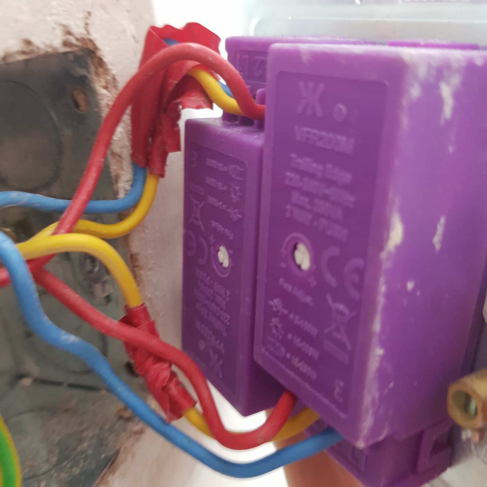

I have changed my 2 gang dimmer switch in my bedroom for a leading edge one which is better as there is no buzzing noise. There are 2 lights in my bedroom and two 2 gang light switches. The 2 gang dimmer is next to the door on the wall and the other standard 2 gang switch is next to the bed on the wall. The problem is, now that I have wired up the new dimmer, when I turn the lights off next to the bed by the switch on the wall, the dimmer switch next to the door doesnt turn on of off. When I switch the bedroom lights on by the bed the dimmer switch can turn on and off. There are 8 wires behind the dimmer switch 2 red, 2 blue and 2 yellow, and 2 yellow and brown in one sleeve. I put the blue wires in L1, the yellow in L2 and the red in the x symbol and the earth in the screw in the metal box. What have I done wrong?

Is the yellow and brown cpc/earth? You may also need an earth/cpc going to the switch.
In the main, although not always, the com wires are the same colour on both switches of the pair, so need to see how other switch of the pair is wired. There is no standard colour code or even way to wire, both of these are valid methods. And that is for non electronic switches.
Where electronic switches are used, then there are even more options, often we have a master and slave switch. But my diagrams show three wires between switches, but some electronic versions only need two, in fact some are completely wireless.
Thanks so much for your reply and your diagram. I will have a look at the other switch by the bed. I did take it off yesterday and remember seeing black and red wires so it is different to the switch by the door.
The red was swapped so have swapped it over so that now all three colours go to one of the purple boxes at the back and the other 3 colours go into the purple box next to it. The same issue is still there though.

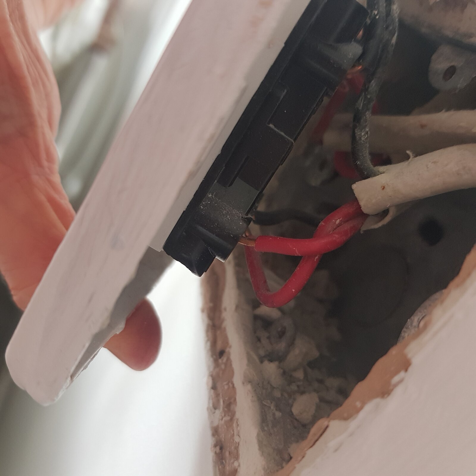

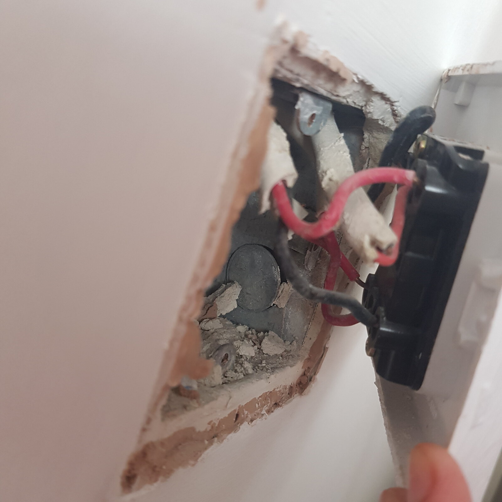

These are photos of the switch next to bed. There are 4 red wires and 2 black.

2 reds and a black on one side and 2 reds and a black on the other.
That's a pity - and unusual.
Obviously the red/blue/yellow must be connected elsewhere - possibly at the light.
If that is the case then I would have connected the red to the line(live) wire so it would not be COM.
Try swapping the red and yellow.
I was with my dad when we did this and I suggested we take a photo but he said he didn't need it! The yellow and brown is earth yes and I have screwed it at the back of the metal box. The old dimmer was working ok before so am guessing it may be the wiring on the new dimmer.
