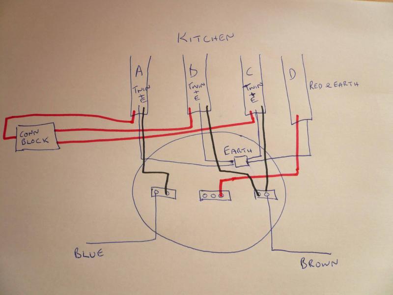

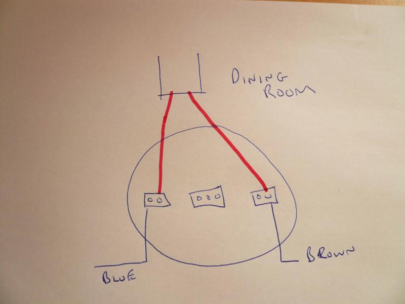

Hi guys just moved into oldish house and dining room light not working changed bulb and switch checked fuse box no luck.Kitchen has connector block with thee reds is this normal?whats going where?two blacks to brown one must be live switch but whats the other?could this be the problem anyway to simplify this without connector block.
Lounge seems to be straight forward loop in
Dining room just one cable twin red and earth.
any help with diagrams appreciated regards john

It won't work wired like that unless one of those reds is a neutral and the other comes live when you switch the dining light switch on.

So, you have a twin red cable at the ceiling, but 2 red single and earths at the fitting.
Must be a junction box somewhere, perhaps near the dining light.
Have you any idea if the dining light has been moved at all?
You need to unearth a junction box to proceed on this one.
Best way would be to take up a board above the dining rose and follow the wire(s).

The red on the red and earth cable (D) in the kitchen light looks like it MAY be in the wrong hole...
Actually, that's a fair point, can't see the wood for the trees.
If the dining light is fed from that single on its own in the kitchen rose / JB, then it would not work... with a continuity tester, you could
The other thing I've noticed is that your diagram of the dining switch has the conductors connected to L1 & L2.
If this is the case, the switch will not feed a supply to the light fitting.
Looking at the wires you have, it seems possible that the live/earth feed comes to the switch from a ceiling point.
With a continuity tester (and power to the circuit OFF), you could try shorting the red and earth of that wire on its own in the kitchen rose / JB together and then seeing if one of the red/earth cables at the dining switch shows a positive reading.

Some switches would use L1 and L2. For example Crabtree ones, where L1 is common, L2 is L1 and if there's L3 this would be L2. If you follow!
