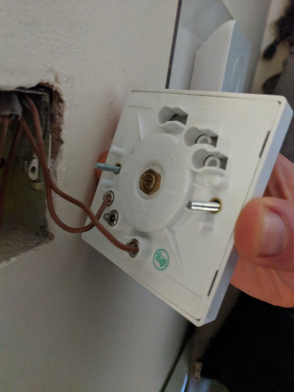

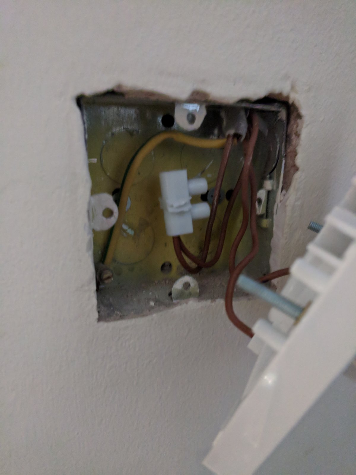

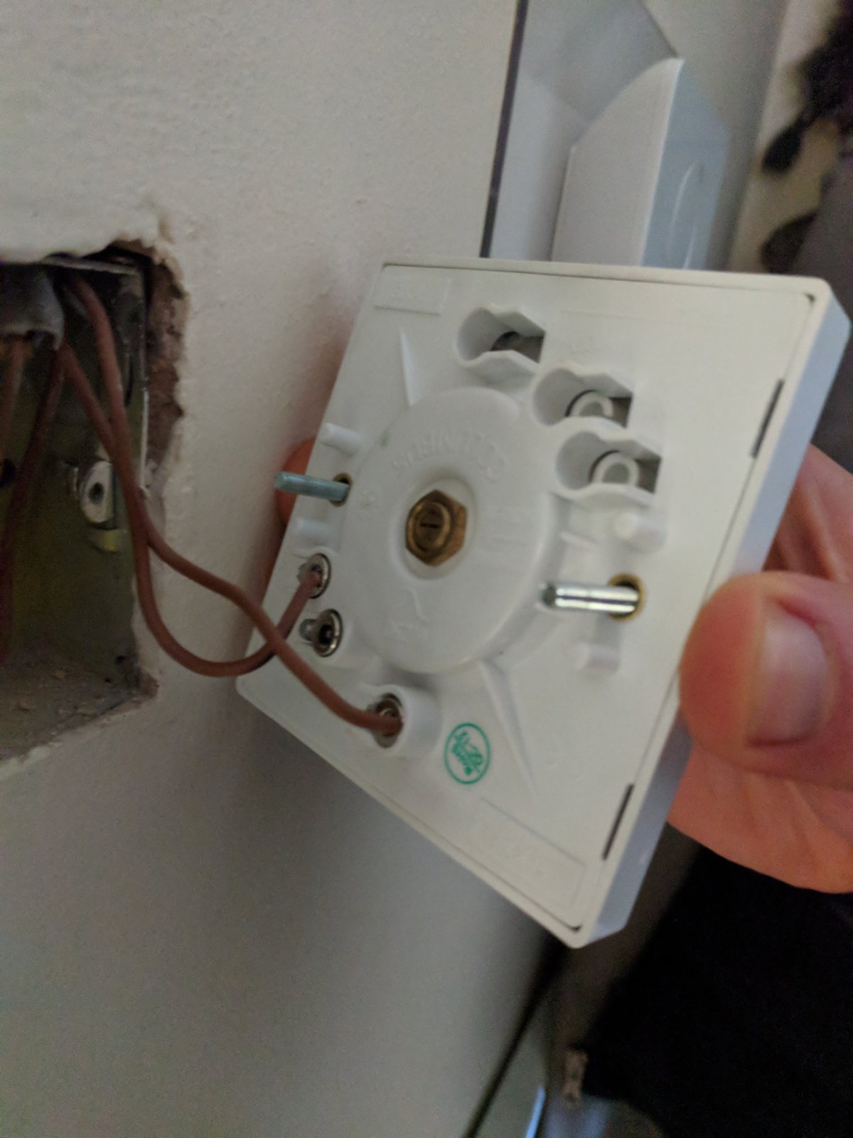

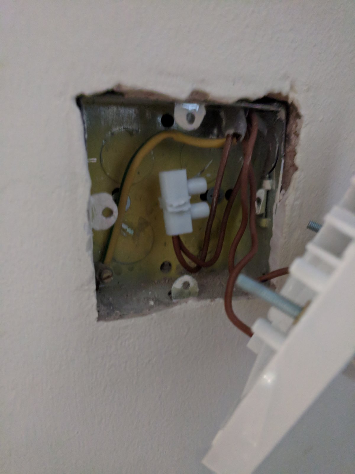

One brown is the Live (L) and the other the Switched Live to the light (Load).
Not sure what the other two in the connector block are unless someone has used brown for the neutrals as well.
According to the information, the new switch will work with just the two wires.
It says on the back "All kinds of light" but I think, because there is no neutral connection, you will have to use an incandescent filament lamp.
Thank you for the quick reply!
Cool, so I guess it's important to know which brown is which when I wire the new one?
The other brown ones, I have no idea. It was a builder rather than electrician that did it, so I'm guessing that anything could have happened :S

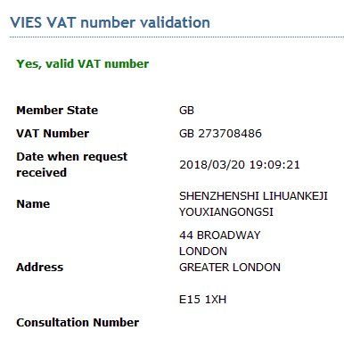

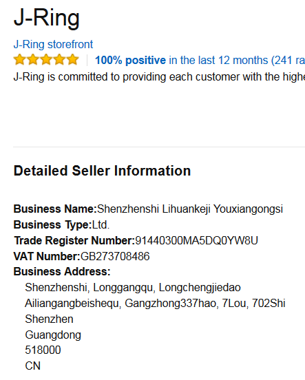

Interesting one, that. It sounds as if it is probably a UK Limited Company (certainly has a UK VAT number) - so I wonder whether that brings them within the scope of UK/EU safety laws etc.?
I guess that I lot of things are made in China then sold under UK brands. That one just has more obvious company details.

But no trace of that name at Companies House
They may be trading under a different name. I don't know for sure, but I wouldn't have thought that 'someone' who was not a 'legal entity' in the UK (e.g. a UK resident person or a UK-registered Limited Company) could get a UK VAT number (it could, of course, be fake!).
