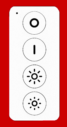

I would say sit back and think about the future, what you may want in the fullness of time. My wife needed her knee done, so we turned the dinning room into a bedroom, so that she could turn the light on/off from bed, I got a TP-Link light switch 1725353402829.pngand remote button 1725353443384.png I already had the hub, switch worked well, but the button not used as she used voice control, it was re-used as a door push. If only one bulb then at £10 easiest option is bulb 1725353674086.pngthe button shown can be configured turn it and up/down and push it on/off, but they allow so much more, my living room lights turn on at dusk, my landing light turns off at 1 am, the list goes on, but each make tends to have there own hub, so as I have said some thought is also needed.

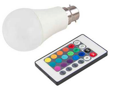

In general a smart bulb will switch off with a power cut, so flicking switch off then back on again will turn off lights, a simple bulb with remote Lampandremote.jpg can allow dimming and colour changing with ease, no need to use phone.

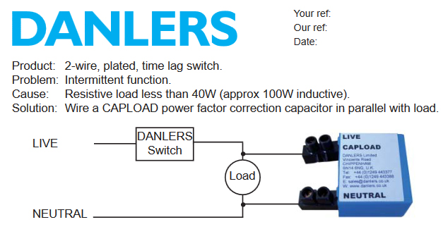

The problem with any electronic switch other than Tapo is either it needs a neutral, or there is a compatibility chart showing what bulbs will work, with a dimmer even harder to match bulb with switch, so with my Energenie light switches, I have ended up swapping bulbs around to find ones which will work, had problems with smaller bulbs (G9) with a shimmer and staying on dim, needed to fit load-capacitor.jpga load capacitor to get them to switch off, and now I have a draw full of bulbs which will not work with the Energenie switch.

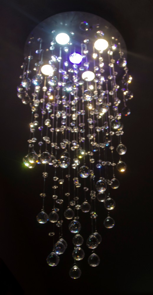

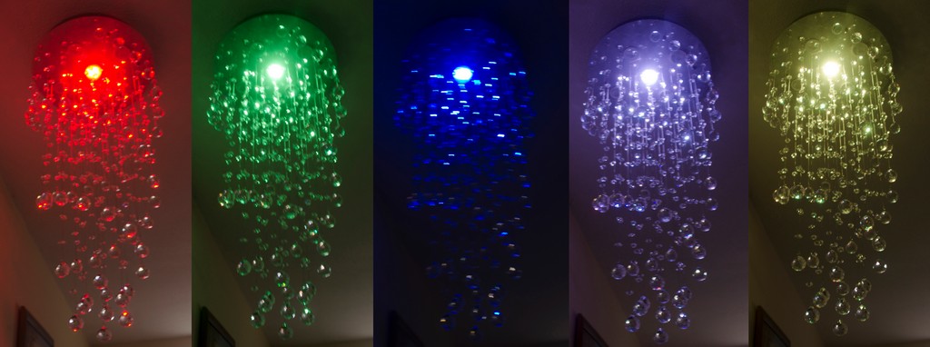

I have fitted a chandelier on my landing now, DSC_6799.jpg and used a smart relay so can select centre, outer, or all lamps, and the centre also a smart bulb so can change colour Centre_bulb_colours.jpg I am trying to give you fuel for thought, rather than saying copy me. I also have a high socket with an emergency torch which will turn on automatic with power cut, or if dark as one walks past it, slowly loosing use of fingers!

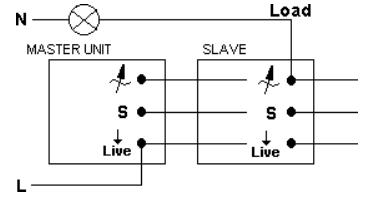

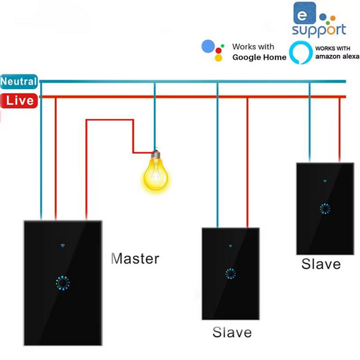

There are slave/master dimming switches one example here 1725357754849.png, another here 1725357843197.png I would draw your attention to this VARILIGHT instruction sheet some dimming switches the dimming can only be controlled on one switch, other switches are simple on/off, and I will admit with my dimmable bulb, it needs switching on, before I can adjust the amount of dimming, using phone app, again have to switch on then dim, but using voice control I can say hey google turn on billy bookcase at 50% and it seems to work.
