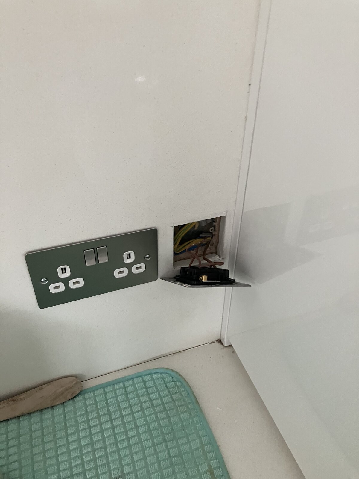

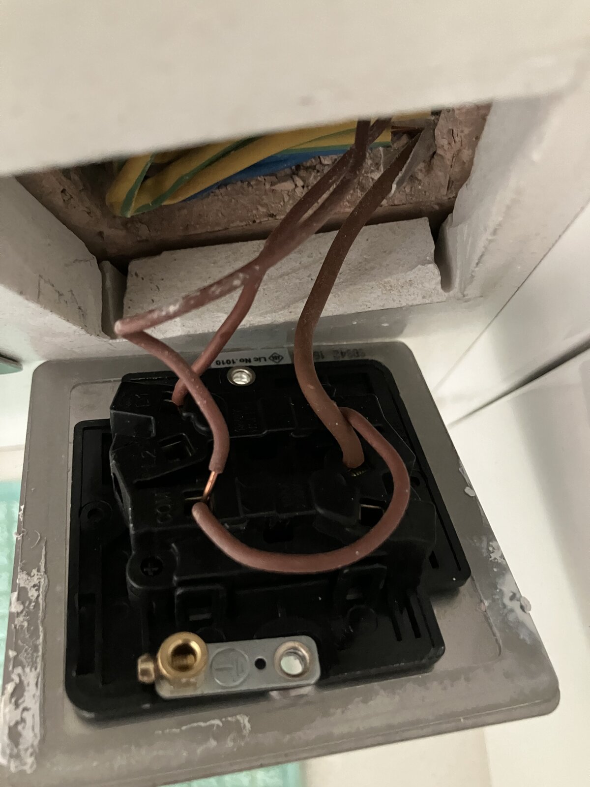

Hi, excuse my ignorance on the topic but am concerned having read up on earthing. I may have understood incorrectly. Some light switches have the earth cable in connector and sockets do not have it connected to the box. My understanding is the back box needed to be connected to the earth?
Some faceplates are metal, some are plastic.
Any advice much appreciated, thanks!

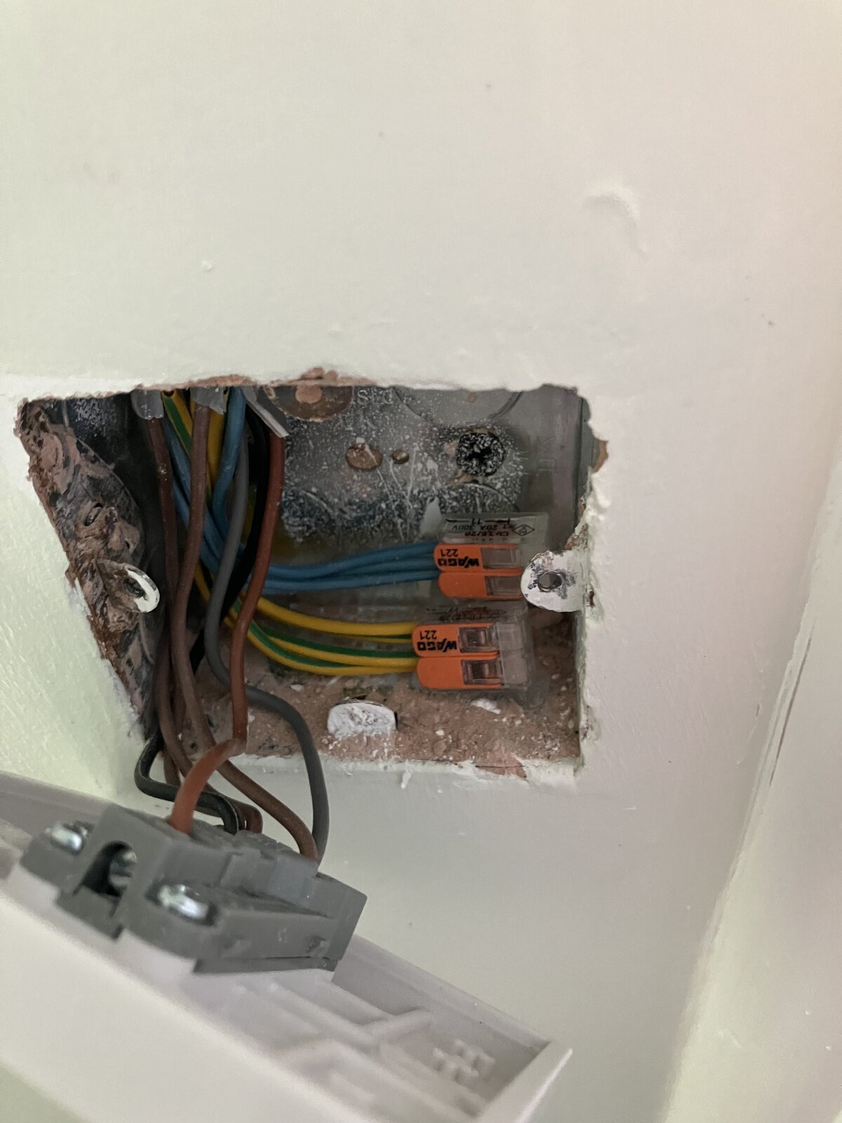

All back boxes and metal face-plates should be connected to the cpc but more importantly it appears that the 2-way Wago connectors each have three wires inserted. The wago connectors can only have 1 wire per point so you need to change the neutral wago to a 3-way version and the cpc one to a 4-way or 5-way version, the extra ways being to accommodate the back-box and face-pale tails. The fourth photo shows too much copper exposed on the live line

Thank you. The Wago is a brand new install by contractors so concerned it's not correct. Where would the tails run to and from?
From cpc wago (1) to back-box and from cpc wago (2) to face-plate. Other three cpc leads (3,4 and 5) into wago (ie 5 in total)

As mentioned by @Jackrae there should only be one wire running into each port on those Wagos.

Thank you. The picture with the Wago is brand new install by legit electricians subcontracted by builder. The other photos are from a kitchen I inherited but think is from the last decade.
My query arises from replacing metal plates with plastic ones in existing locations and taking a photo of a brand new light switch install for reference, which would seem is also wrong.

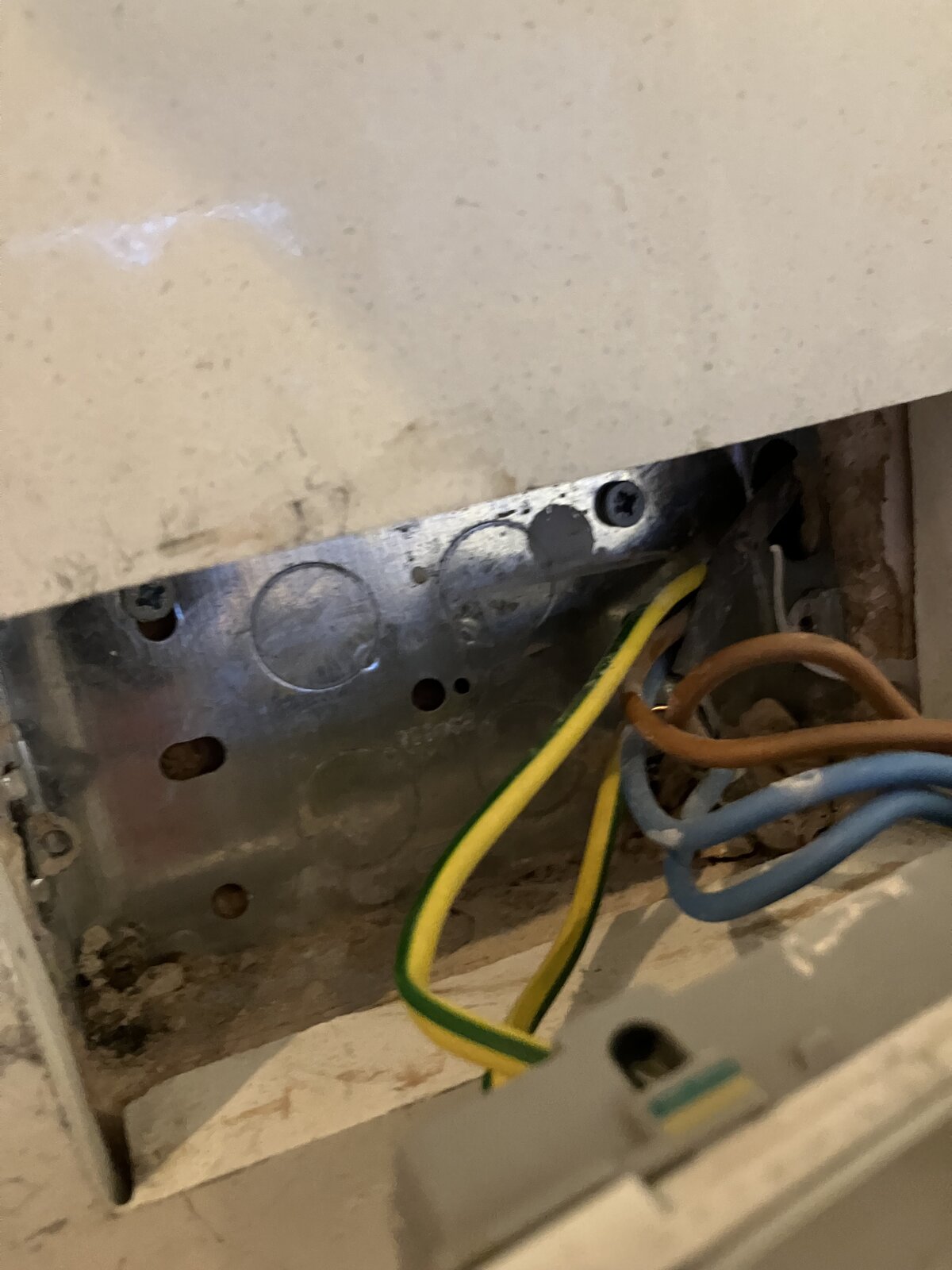

Ok, image number 2 has a plastic face plate. Do any of the CPCs run back to the fixing point on the metal back box? Without it, in the event that a live cable pops out, the fixing screws running from the faceplate to the back back could become live.
I find myself wanting to be generous to your electricians, cutting them some slack, but I cannot.
Feeding 4 cables in to a fitting designed for 2 is wrong on every level. I cannot see any justification for that.
The earths at the light switch should connect using the back box connection. Where you have a metal switch an earth cable should run from the same point in the back box to the earth connection on the switch.
With sockets the earths should connect at the socket. It’s not essential to have an earth lead from the socket to the back box

Metal back boxes usually have a fixed lug (as well as an adjustable one), in which to screw the accessory into.
This fixed lug (and the screw connecting it) is sufficient to earth the back box (if the faceplate is metal, or the accessory is a socket).
The back box isn't required to be earthed independently, but it is considered good practice to run a flying lead between the two.
If the faceplate is plastic, the earth wires should be connected into the terminal on the metal back box (many plastic boxes also have a suitable terminal).
As opposed to what has been said above - I would run the primary earth wire/s to the place with the greatest risk, i.e. with a metal switch plate, I would run the earth to the switch plate itself, rather than having a flylead to the plate, from the back box.
All the cables are visible in the photo, to the best of my knowledge there is nothing attached to the back box.
Three light switches and nine sockets have been installed in that job, I am terrified what may be amiss.
