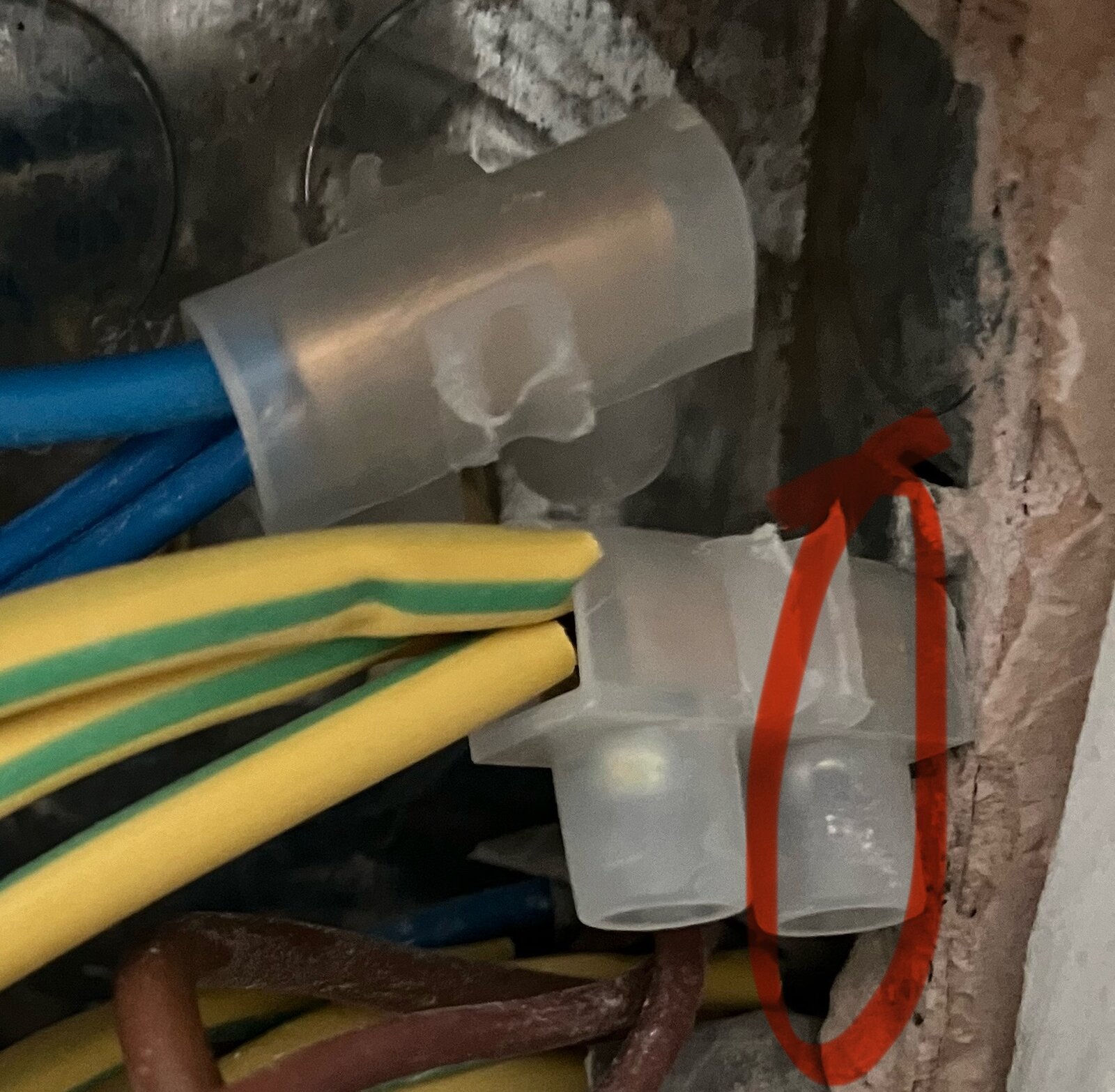

That last photo you have shown in response 26 is a real and serious concern. 2 live wires (switched or otherwise) have been 'joined' together, covered in tape and then one of them inserted into the switch. There is visual evidence of some other wire being wrapped in tape. There also appears to be a small loop of bare copper appearing at the bottom of the photograph. Whoever did that wiring could not be called a competent or responsible 'electrician'

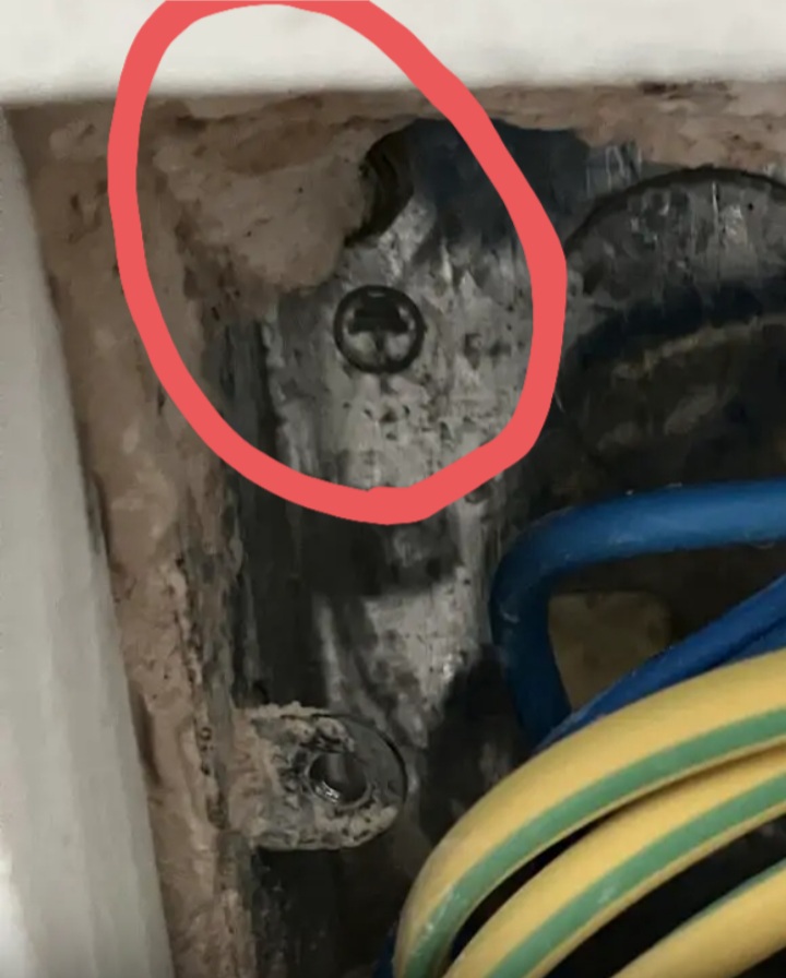

Am I missing something or are these instructions not including earthing back box for sockets?
In short..
Sockets (3 pin) must have an Earth/CPC/green-yellow to the "faceplate" because one of the 3 terminals is an earth and absolutely must be connected.
Metal Back-boxes should also be earthed.
If it's a plastic switch then the earth goes to the back-box.
If it's a metal switch then earth goes to either the faceplate or the back-box with a link between.
If it's a socket then a link from the earth terminal to the back-box.

Thanks very much. Local electrician tells me metal box doesn’t need earthing if the plate is plastic.
He's applying what many might call 'common sense' - but, as you will have seen here, some people will argue that, even if the plate is plastic, the faceplate screws will usually be metal, and therefore theoretically present a risk of electric shock, but only in the event of a (I would say incredibly improbable) combination of circumstances.
Kind Regards, John
Kind Regards, John
It's very simple...
If there are exposed metal parts they should be earthed. If you have metal backboxes and no earth available then use nylon screws.
It doesn't remove the risk of electric shock if the front plate is removed... but then doesn't remove accessories with the power on(y)
