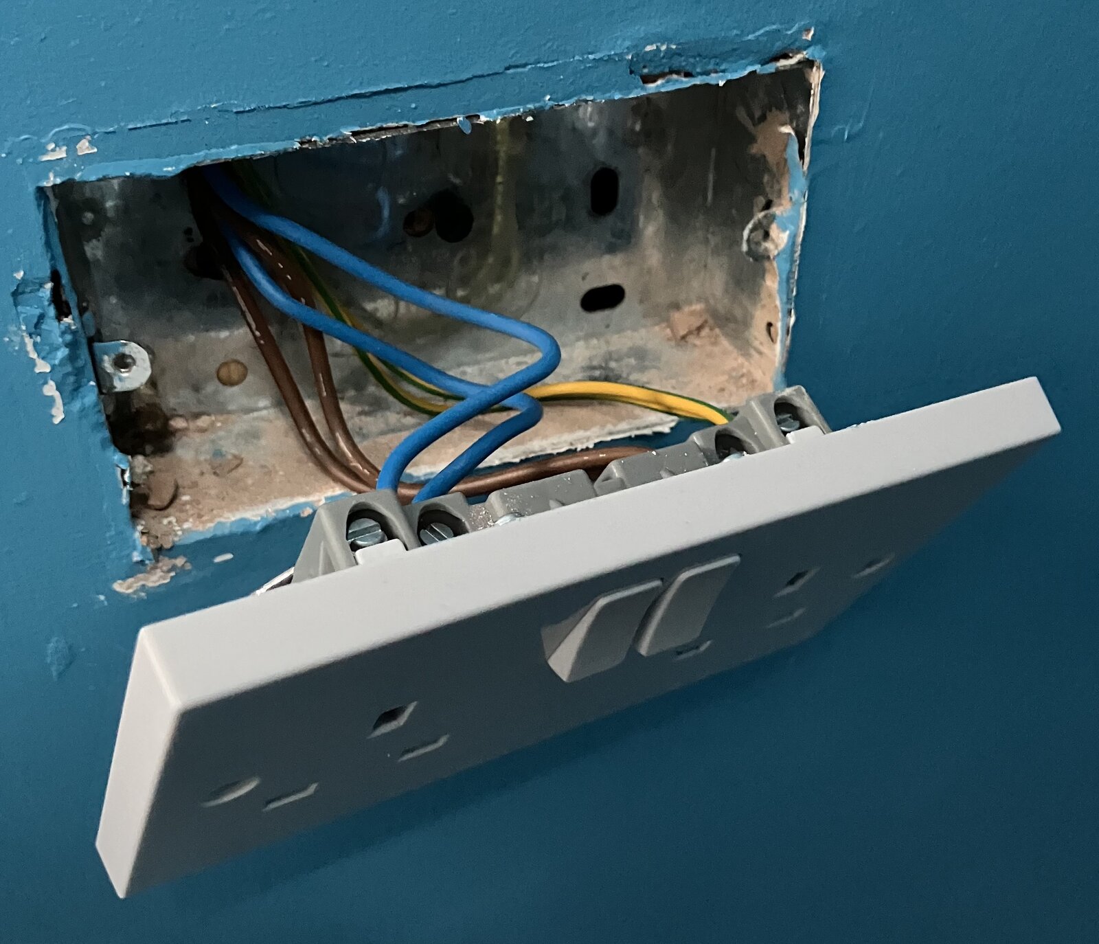

For those interested, one of the sockets that wasn’t caulked in the new install… staggered

Their socket wiring is not 'incorrect'.
Although, this does not make the rest of the wiring 'correct', with examples of tape over wires, multiple conductors into single Wagos, etc.

An electrician has seen and advised multiple cables can go into the Wago. I’m perplexed!
I emailed Wago yesterday.
This is their response (impressively speedy reply).
You should only insert one conductor per pole as due to variances in copper you cannot guarantee that the spring will clamp on multiple conductors.
If it is necessary to insert more than one conductor per spring you should always mechanically bond the conductors first by using a crimp or solder.
Perhaps if might be useful if you let your electricians know that the manufacturer says that it is not approved.
