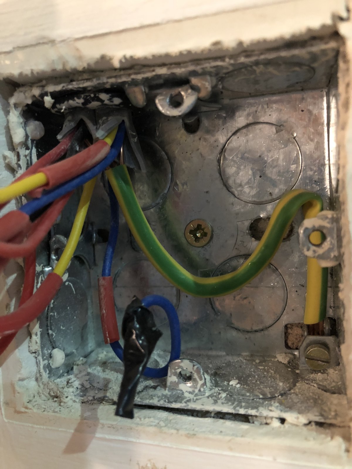

Can I have a picture more clearly showing all the terminals and the cables the wires come from?
Especially the Black and there should be another Blue.

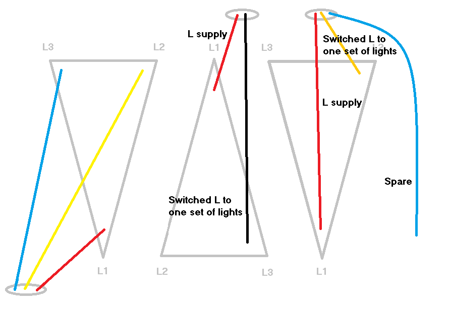

Anywho, for part 2 I have three spots in the ceiling all in a row, middle switch controls one of them and the left switch (right if you’re looking at the back) controls the other one, I don’t know why they didn’t put them on the same switch.
My thought would be to either switch L1/L3 of the middle switch to the right switch or L1/L2 from the right switch to the middle.
But why is one L3 and the other L2?
What is the purpose of the spare?
I got the numbers wrong in the middle switch from looking at the first picture.
The spare is unused. No purpose. Might have come in handy for something.
Stick to one.
L1 -the red wires supply the power.
You want both wires that go to the lights to come on together.
So, put the Black wire in with the Yellow.
Then terminate the Live Red of the middle switch in a connector block so that it doesn't touch anything.

Ok, that makes sense, so essentially the red wires (L1) are the cables coming into the box from the power source, we only need one of these so the other can be terminated. We then have two wires coming out of the same L2 which then provide the power to the lights.
Is the spare blue wire a neutral?
That's right.
As for the Blue - very unlikely to be a neutral but could be connected at the other end if you ever want a neutral at the switch.
It does have a red sleeve signifying it was used for a switch wire.
As I said, use of the RYB cable could mean that it was once one of a two-way system, as is the left (looking at back) switch.

Fab, so the red sleeve would indicate live, so for all the connections here they're live just some are power in (L1) and some are power out (L2), and then L3 are all to do with two way switches.
