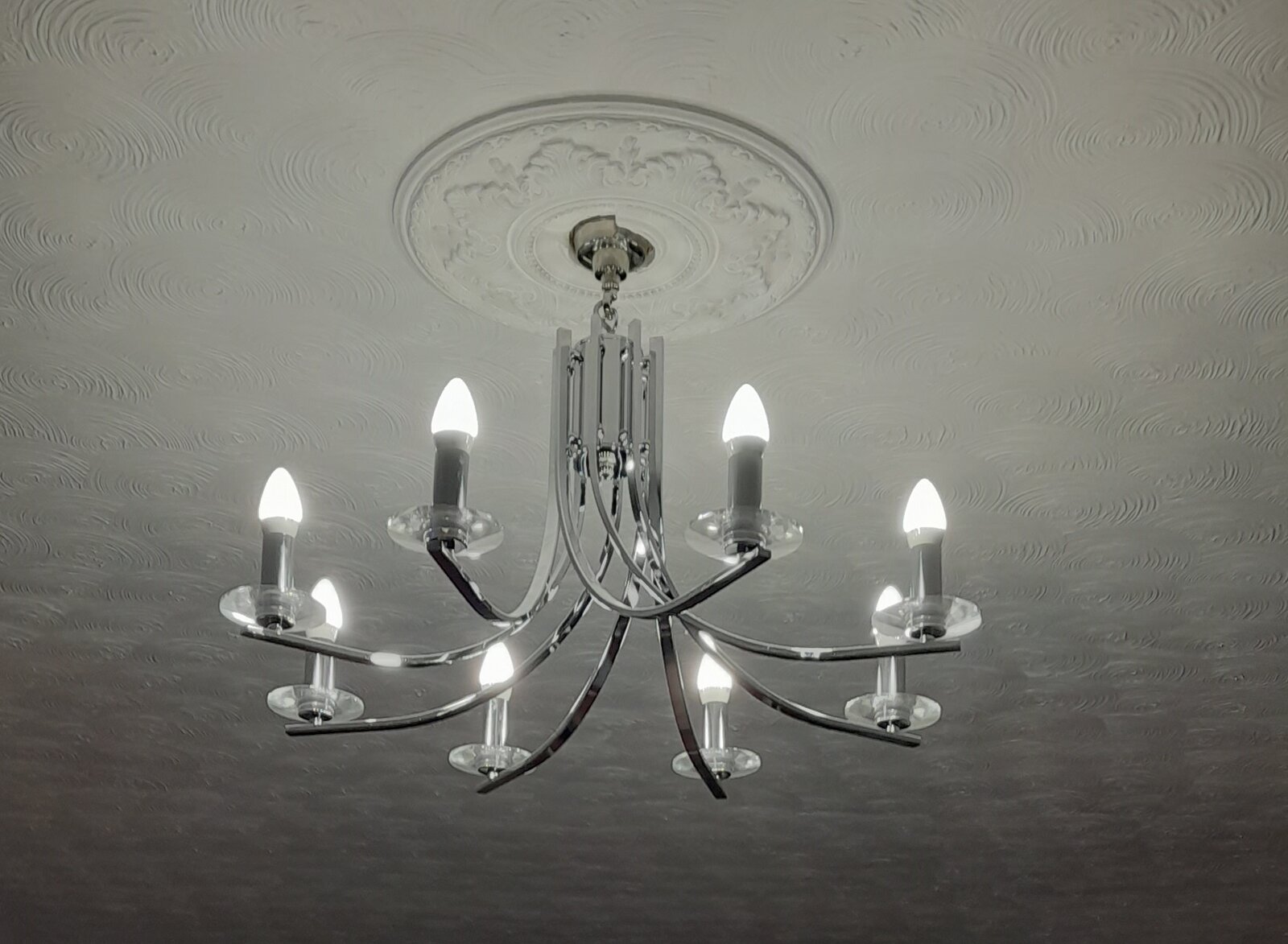

So I like I am sure many others, want to continue with this method. But my house was designed in the tungsten age, and my living room had a single 150 watt bulb, I would have thought, and in real terms there is little that can simply replace it, OK these
at 60 watt may work, I have one in an up lighter, but can't fit the shade. So we need in the main some sort of chandelier able to take multi-bulbs, Ceiling light.jpg but this hangs down a bit too much, so tall people hit their head on it, but it is over a chair, so I can get away with it, and it does unplug, Ceiling rose.jpg so I can swap it with the 6 bulb version in dining room which does not drop so much, but we are left with very few methods to light our rooms unless we use LED units to fit the old fluorescent lamps, so there has been a move to GU10 lamps. Fitting a light bar

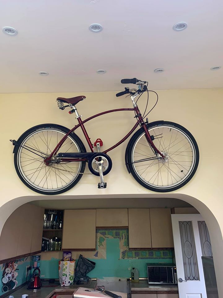

we can direct light into dark areas, but the down light 1749722907029.png also seems to be gaining popularity, my comment to son, why didn't you arrange to show the great bear did not go down well, but the ceiling is high 102 Kitchen Bike.jpg as can be seen with the full size bike as decoration. In most houses, the ceilings are too low to get a reasonable spread, and he fitted 14 lamps at 3.5 watt, so 49 watt to replace what had first a 65 watt fluorescent which was changed to 58 watt, and then a 22 watt LED tube, so may look better, but room no better lit than before, and actually using a lot more power.

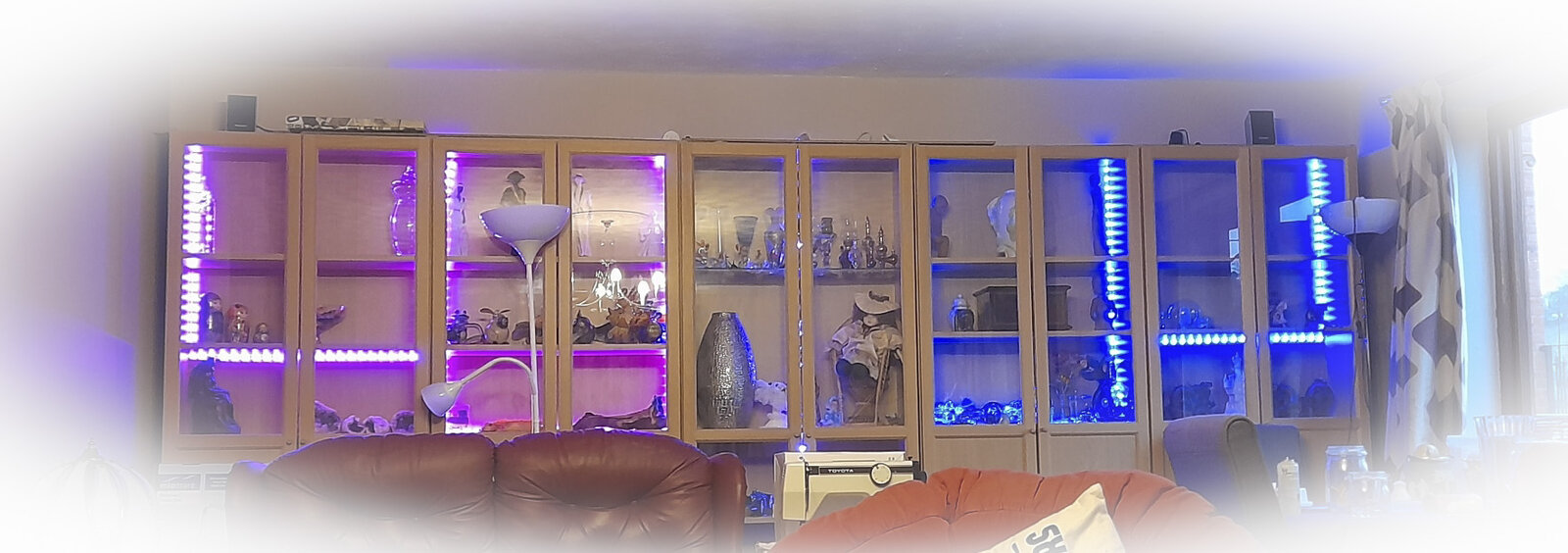

he has a point, in my living room we supplement the lighting, 20230227_170703_1.jpg with 60 watt if turned up full, of cabinet lighting, and we use Google Nest Mini's to control the lighting, so we can turn multiple lights off when leaving the room, be they be from lighting or socket supplies. You can also see two up-lighters (Ikea) in the picture, as to put it simple, our house was not designed with LED lighting in mind.
