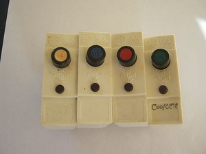

Hi,
Looking for a little help please as there is a problem on the lighting circuit. It doesn't seem to be related to any particular light or switch as the circuit breaker will trip even with all the lights switched off, and the breaker itself sparks when you try to untrip it and hence won't untrip. This leads me to believe its the breaker itself. It is a standard wylex push button type, 5A. Can I just pull this out and replace it with another? Maplin or Screwfix don't seem to stock the type I have
Does anyone know where I can get one or can it be replaced with a switch type without doing any wiring? Pull one out, slot one in sort of thing?
The MCB's are available they now look like this

but if it sparks then there must be a load so unlikely the MCB at fault some thing has gone faulty could be anything from rodent damage to cupboard screw through wire but with no load there should be no spark so something is taking current.

As to changing MCB yes main switch off but I can't remember if the base for old type is same as base for new type or if base needs changing too. Only one screw if it does but does expose live parts.

Thanks for the advice, I still think I'd like to replace the MCB first just on the off-chance as it'd be a lot cheaper than calling an electrician out. Do I just pull it out?
Recently no work has been done, it just started happening yesterday. The suspect MCB also wiggles and none of the others do. If I can get a like for like replacement I'll just bob it in, and if the problem persists I'll call a spark
Yes after turning the power off.

Yes it seems fine, it looks in very good condition. I think this is going to be one of them things, because everything is fine now and I can't get it to trip. I've had a good look at all the wiring that I can and looked at the wiring in all the light switches and it all seems fine.
Thanks for the help everyone
For future readers or those that may be interested, the new style MCB fits straight in to the old style base.
