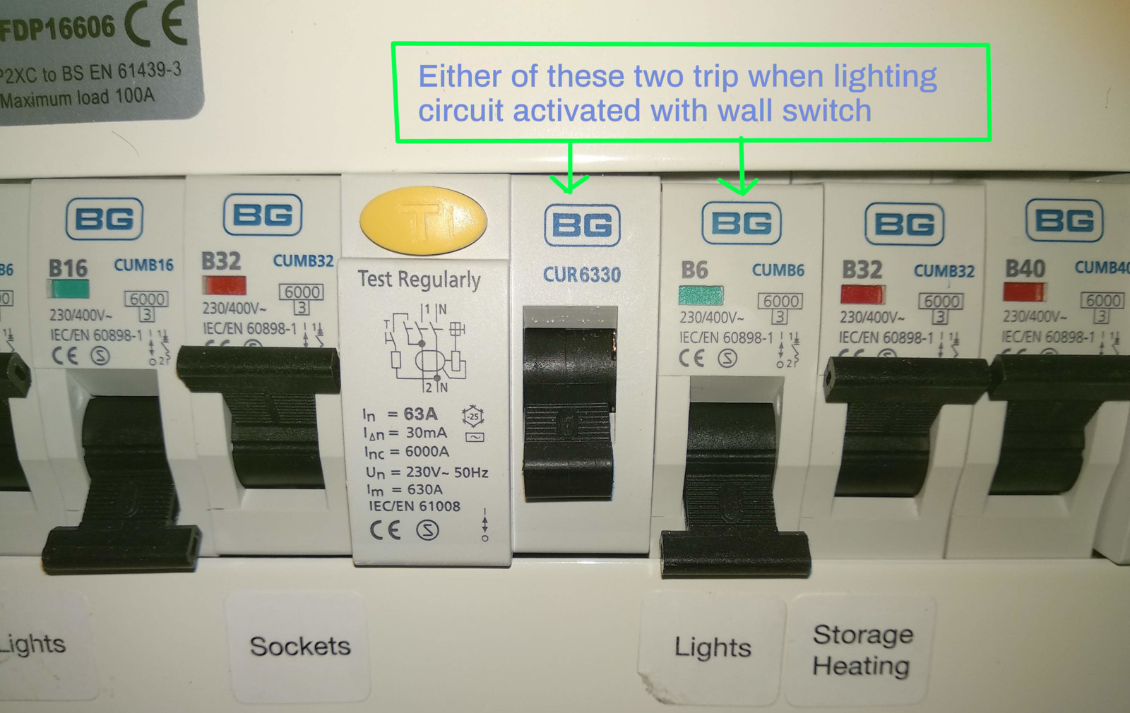

New BG domestic box has been fitted.
Everything in box works ok, without tripping, except the led lighting circuit, which trips RCD every time wall switch is activated.
Lighting circuit trips either B6 RCD it is connected to, or larger in line 63A RCD.
LED lighting circuit works Ok when MCB is used in place of RCD.
Any ideas?

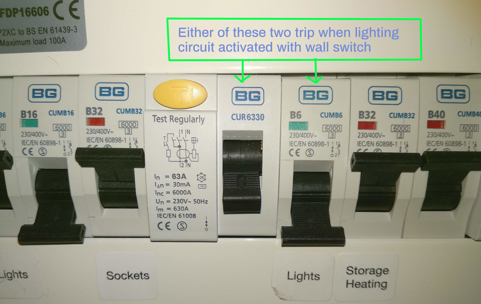

63A or 6A trips when lighting circuit switch is activated. Photo of breakers attached.
What do you mean by "led lighting circuit"?
Is only one led light on the circuit - or a lot of led lights and no other lights?
The B6 is an MCB - Miniature Circuit Breaker.
What does that mean?
Any ideas?
If it trips the MCB and/or the RCD then you have a live to earth fault somewhere.
Your description is not that good, so trying to read between the lines, I am going to ignore the 63A RCD (30 mA) for the moment as likely tripped by a spike from the B6 MCB when that trips. So for the MCB to trip it needs either 7A for a long time or 30A for 10 ms the latter is the more likely, and to get that drain yet some times hold makes me think a capacitor charging, as anything else would either clear its self or be always there.
So I would think some where a bulb has a faulty circuit and since we know the LED bulb uses a capacitor to limit current it seems likely it is a bulb at fault, or bulbs if from same batch.
So set one remove all bulbs, and see if the MCB trips, it should not trip if my idea is correct, so assuming it does not trip, replace bulbs one at a time, one hopes then you will find the faulty bulb?
I have not heard of this fault before, so trying to use logic as to what it may be, feed back is appreciated.
