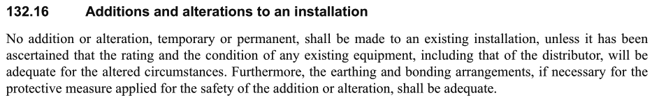

    Hi,
    This question is really about whether moving a few ceiling roses (requiring the addition of wire) on an older circuit without earth will constitute a modification, requiring a rewire of the whole circuit to bring it up to current standards?
    The current circuit has been tested as safe, and will have class 2 accessories etc. I would like to upgrade the wiring at some point, but I just don't have the cash right now

    Relocating items and adding cable is obviously an addition and alteration to a circuit.
    CPCs have been required for all circuits since 1966, well over half a century ago.
    Extending or altering a circuit that doesn't have one won't comply with BS7671.
    In that case, the existing lights will have to remain where they are.
    It's already several decades overdue for rewiring.
    There are two ways to do electrical work - properly or not at all.

    Thank you everybody.
    My reading, then, is that the quoted reg, BS7671 132.16 doesn't seem prevent what I propose - ratings won't change and the Class 2 switches, rose and fittings are, on their own, 'adequate' protective measures.

    It doesn’t because among other things the regs are not statutory.

    I agree. It will not be made less safe than it is now.

    Ah, true, but I'm thinking about likely EICR results, which do matter to me.

    Thanks Harry,
    As it happens, the sockets etc have been rewired, just the lights haven't. Odd, maybe, but that's how it was when I bought it.
    I'm not looking to conceal anything...was going to add using maintenance free junction box using twin and Earth, with the earth properly terminated for future use.
    However, there is, for me at least, a significant difference between and C1, C2 and a C3.... C3 means that I can choose when I spend my limited money.

    Sounds like C3
    "Code C3
    Code 3 is described as ‘Improvement recommended.’
    This means something has been identified which does not comply with the latest regulations but isn’t actually dangerous. For example, the installation may not comply with the current version of the regulations or may have damaged fittings which do not have exposed live parts. A code C3, in itself, should not warrant an overall unsatisfactory report." (Intersafe)
