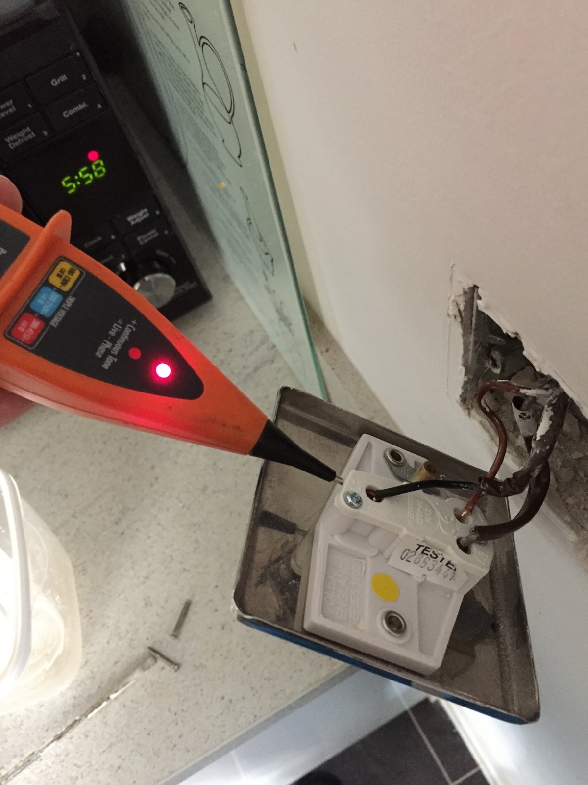

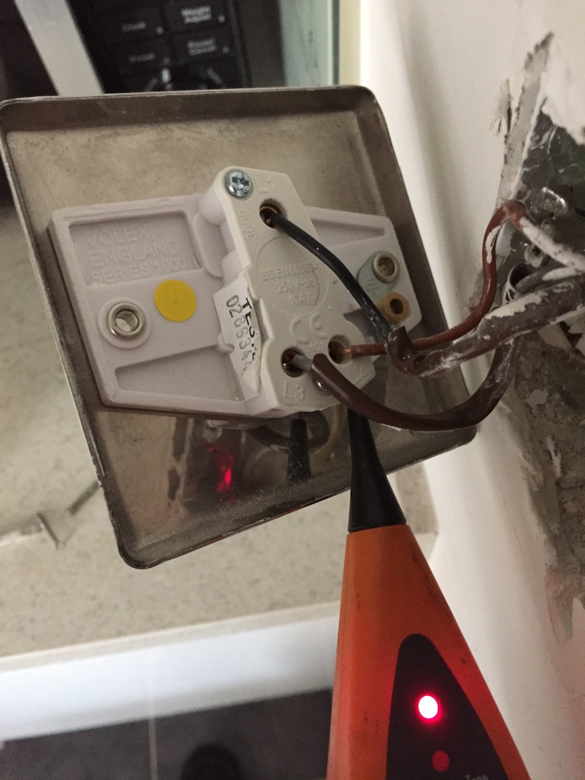

There is a double switched light which I had intended to take a feed off for the exterior lights by punching through the wall behind the switch and adding conduit/junction box. At the moment it is a single switch, and I want to replace it with a double switch for the exterior light. Photo shows the wiring as it was on the single switch, and second pic is the new double switch. I've had a go wiring it up having consulted some websites, but I can't for the life of me get the switching right. The lights would only come on (in the utility or the new one) when different combinations of the switches were thrown.

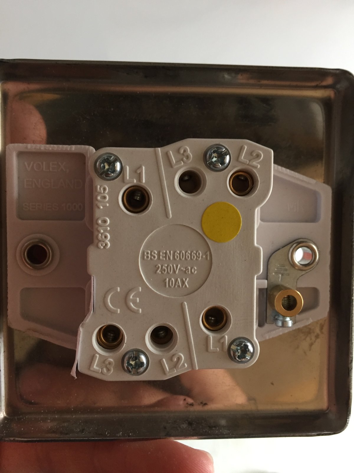

SWMBO just come back with an external switch she wants to add in to the far end of the corridor, so now I need to try and factor that in...(4th pic)
  1. There is no neutral present at the existing switch, so you cannot supply another light from it.
  2. The new switch is not a 2-way one, so it cannot be used as one of a pair of switches controlling he same light(s).
  3. You really need to spend some time learning how all of this works, or get an electrician in. You aren't going to be able to do it properly or safely if you don't genuinely understand what's going on, how lighting circuits are wired, how switches, and different types of switches work, etc.
