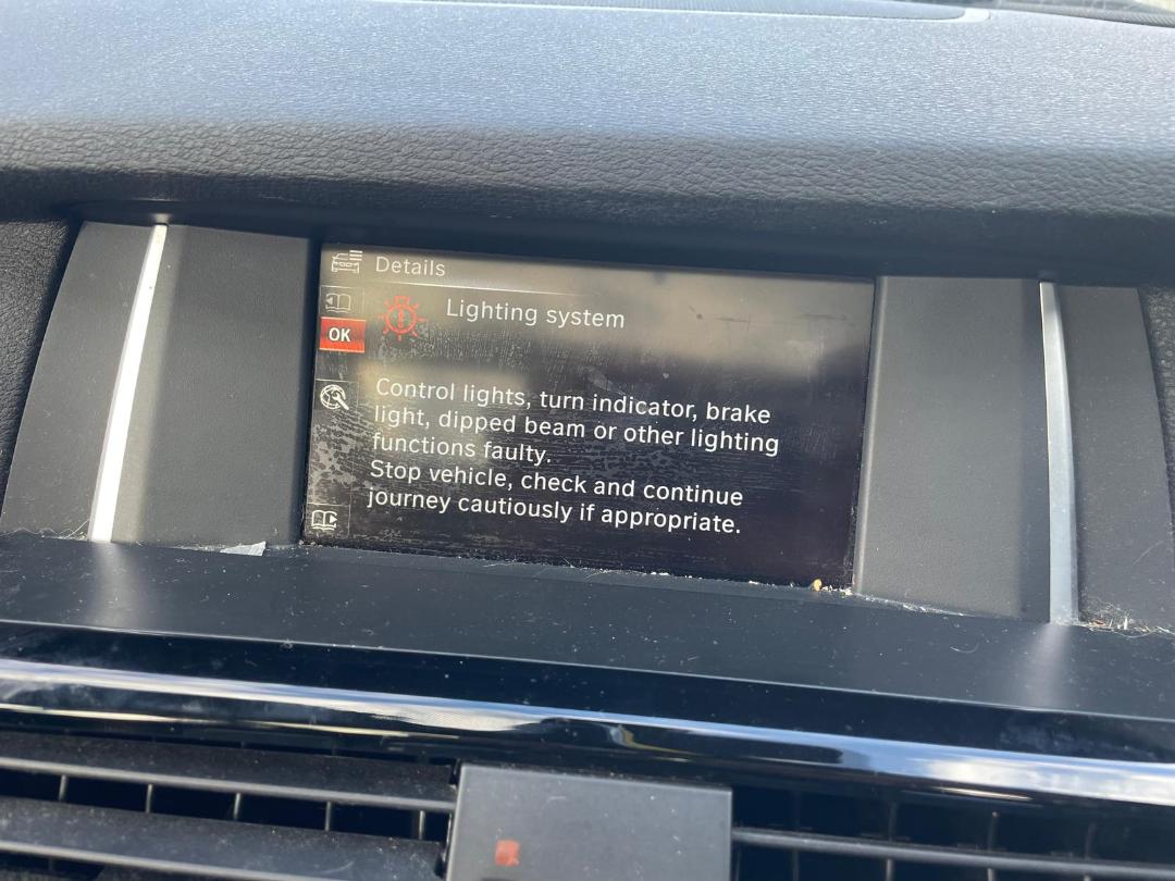

Dear all, my BMW X3 has develop this intermittent fault on the lights (see pictures). Mechanic did reset the system and the fault disappeared but it is back again and it looks like the brakes and the indicators do not work from time to time. Is this something easy to fix that I can attempt or is it a case of going back to the garage?
Thanks for any advice!

It happened while driving back home quite randomly. Can a faulty bulb or fuse be the problem? If so it should not be intermittent right?
First thing I'd check is are the connections to the lights seated securely, and are the bulbs seated securely within the lights.
It could also be wiring damage, e.g. something might have melted a wire. Check the integrity of lighting wires.

Have you changed any bulbs recently? Apparently BMWs are sensitive to aftermarket parts and these may cause the error.
I checked the bulbs and they look OK. But thanks for all advice anyway.
Looking OK, is not enough. Poor contact of the bulb to the bulb holder, or bulb holder to earth, or any less than perfect connection, anywhere in the loom feeding those lights - can trigger the warning. Resetting it doesn't really help, the problem causing the warning, needs to be tracked down.
The diagnostic technique, beginning with the warning off, is - ignition on, all those mentioned lights on, with someone watching the dash display. You go around the car, tapping and thumping around the lights, waggling wiring about, until the warning shows up - then you have likely found the problem. Repeat the process, concentrating on confirming exactly where the fault showed up last time.
Thanks, I did this and now the right indicator turns the left beam on and off which is quite weird. I do not think this can be caused by a bad connection at all! In any case I do not think it is fixable by me so I have an appointment with the garage.... thanks anyway
