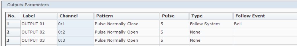

Today I was trying to adjust the time the external bell rings for, but seem I must have changed something.
The alarm works fine, sets, disarms etc.
However if the alarm is triggered the external bell won’t stop sounding! (Had to disconnect the power) the control panel things everything is fine and ready to set the system again.
I must have changed something in the UO settings.
Onlooking there is a UO1 “follow system” event for “bell”
But nothing to set the system back when disarmed. Should there be one? U02?
Any anyone point me In the right direction

sorry but the log may not help you, but it will tell me what the panel sees rather than what you see.
Unfortunately is sounds like the log is full of other events, the only way to reproduce this is to test it. (going to have to do this at some point anyway)
if you haven't changed anything then the issue is with the bell or bell wiring, but what your telling me is the bell is the external bell is active after being triggered and remains active and does not reset.
out of interest what is the output programmed to normally open or normally closed as if this was wrong it could cause a problem but that doesn't explain whats going on and I cant see why you would change it.
without seeing how the output works, ie at rest and being activated, its possible that the output doesn't change state until activated, and then if left in the wrong state, causes the bell to remain triggered.
also you should have it say latched so it, was the bell initially triggered for a very short period?
I will try recreate the issue at the weekend..
I don't remember changing anything.. But I must have caught something and saved it without realising..
Where can i check the normally closed or normally open setup?
"was the bell initially triggered for a very short period?" - Yes, window cleaner set it off, rang for about 30 - 50 seconds..
Happy to change anything :) its not working now so will try anything..
I would program change the normally closed to normally open and change to follow partition and bell trigger and latched.
