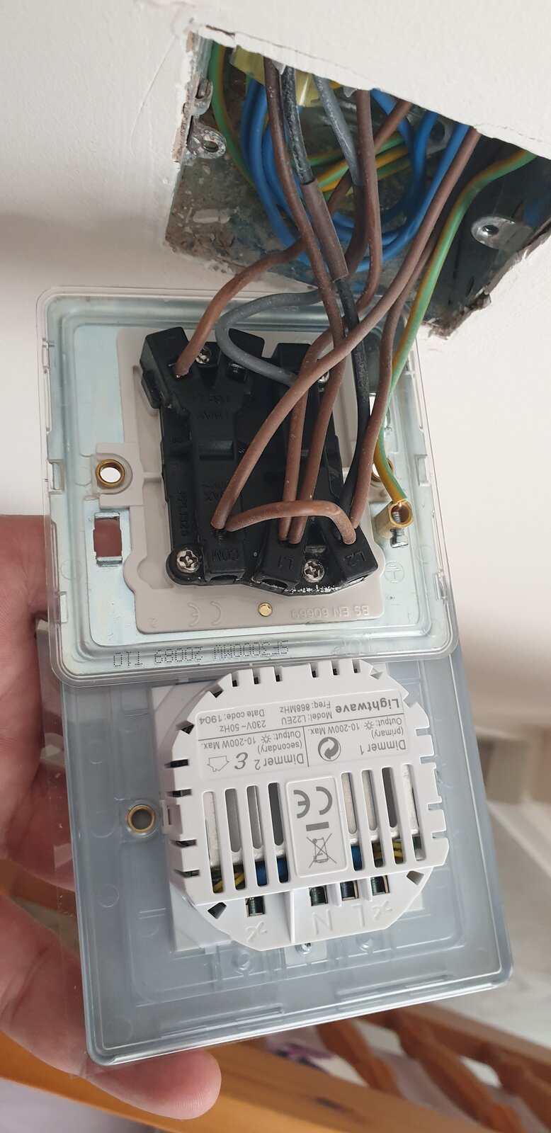

Hi all
I currently have a room where there is a dimmer by the door controlling ceiling lights, and two way switch by the bed, also controlling ceiling lights and a second switch controlling bedside light.
The photo below is of the bedside light, so this is the main switch. I can clearly make out the switch wires, but i don't understand the current wire between COM and L2 - so i'm struggling to see how i convert this.
I'd appreciate any tips of how to wire this up for lightwave

It just avoids having three wires in one terminal - supply in, supply out plus link to other switch - and one wire in the other.
